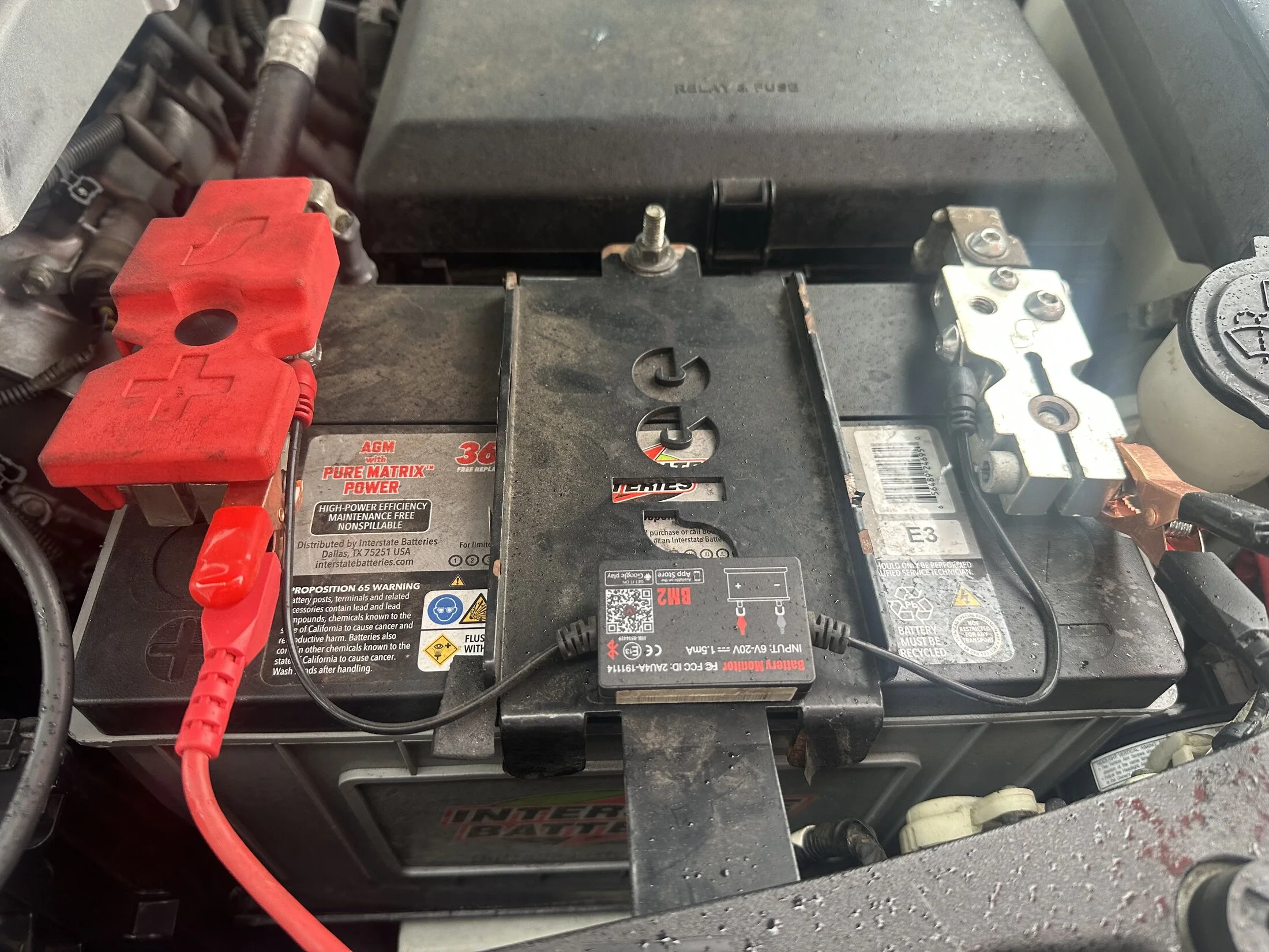

Hi all,
I need some advice on my battery set up. I have an Interstate 31p-agm7 with the Slee battery tray and connectors, and the HKB alternator voltage booster. I’ve also tried the regular HKB microblade fuse.
I use my CTEK battery charger 2xmonth as well.

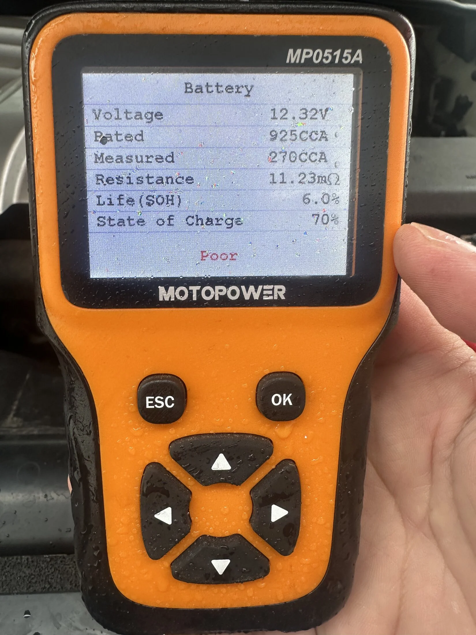

This is the 4th time I’ve had to replace the battery within only 2-3 years. What am I doing wrong? Do I need to upgrade the alternator? If so, which one should I purchase? See below for pics from my battery tester and battery monitor. This is becoming a headache. I’m tempted to just go back to the stock battery!
Thanks in advance!
I’d suggest going back to an SLA. It’s what the car is set up for.. there are a couple group 31 SLA that are quality made, you just have to be picky.
there are some posts about issues with the older style slee clamps, so maybe check for fit and oxidation at the clamp, too.

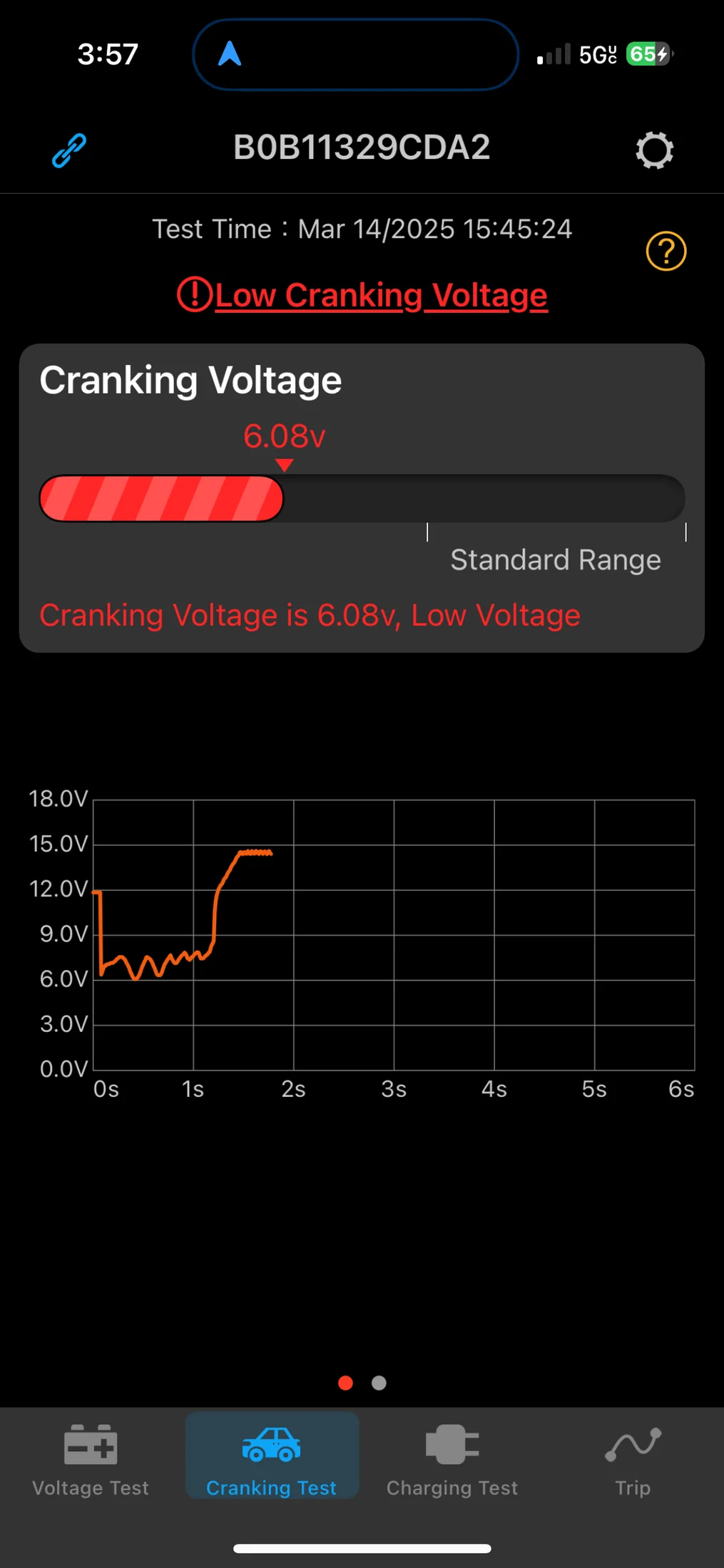

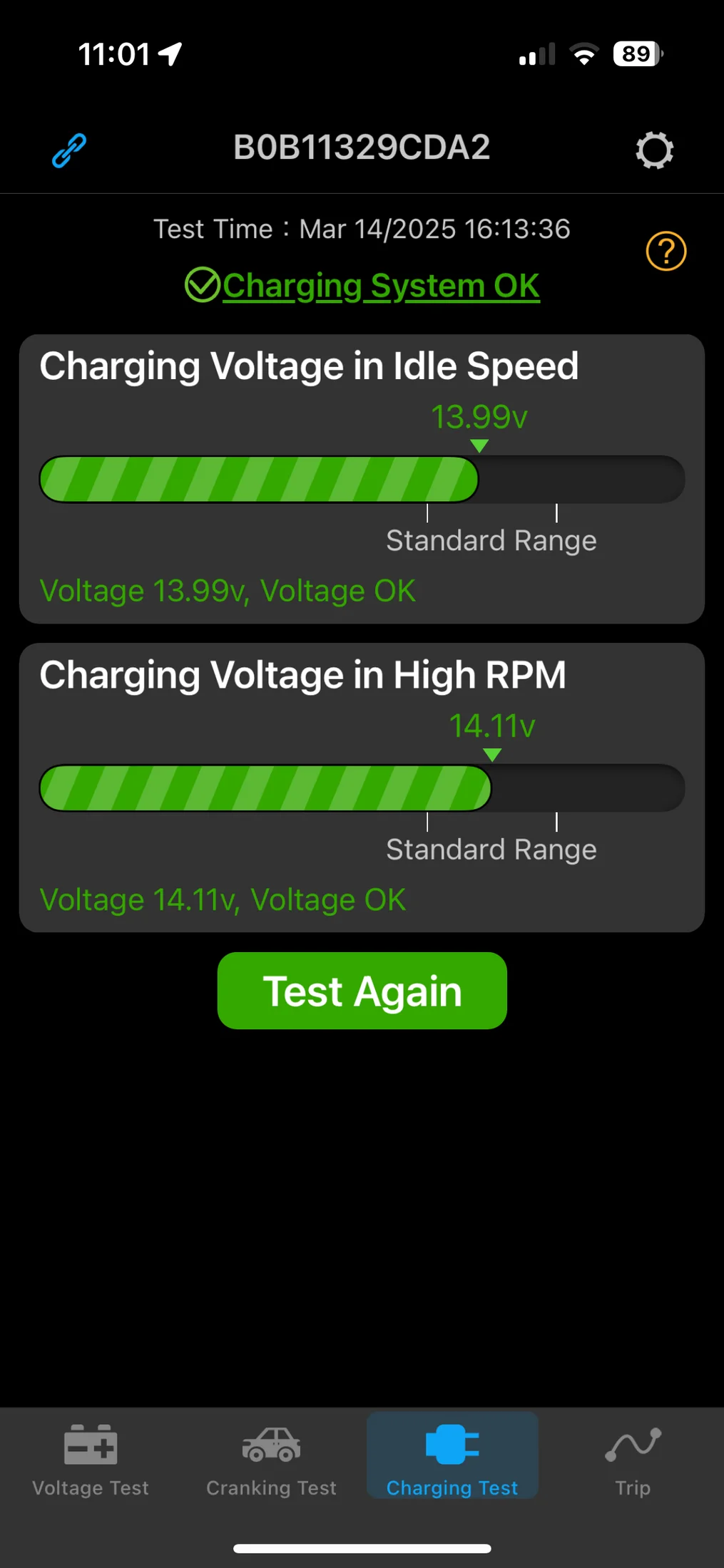

Here is what my app shows. Should it be higher?
According to the link from Interstate:
"Standard batteries need more voltage than AGM batteries to recharge because regular batteries have higher internal resistance. To keep them from overheating, they can only take a few amps at a time at that high voltage.
This means AGM batteries need a special AGM charger. They can take a lot of amps in a short period of time — but an AGM battery charger must keep its voltage lower than 14 volts to avoid ruining the AGM battery. AGM batteries are 12 volts, like all car batteries, and can handle some higher voltage, but only up to a certain point. If a car alternator charges an AGM battery with a voltage higher than 15 volts, it can damage an AGM. It’s not likely, but voltage fluctuations are a possibility."
According to Odyssey Batteries for their AGMs:
"Q. What are the required charging voltages?"
"A. If the battery is used in a starting application, the alternator should provide between 14.2 and 14.5 volts at the battery terminals. In cycling applications, the absorb voltage should be between 14.4 and 14.8 volts, while the float setting (if applicable) should be between 13.5 and 13.8 volts."

What is your use case? Frequent short trips? Winch? Lots of auxiliary electrical demand? Why the group 31? What was in there before the series of Interstates and did it have the same problem?
What is the diode voltage booster installed for?
Worth checking for a voltage drop between the battery posts and the battery cable swage. The alum. battery adapters end up with oxide layer issues.

aluminum auto oxidizes pretty much instantly in air. the oxide layer is high resistance (to demo- poke an aluminum sheet with a set of meter probes lightly then jam them in hard and read ohms on each stab).
