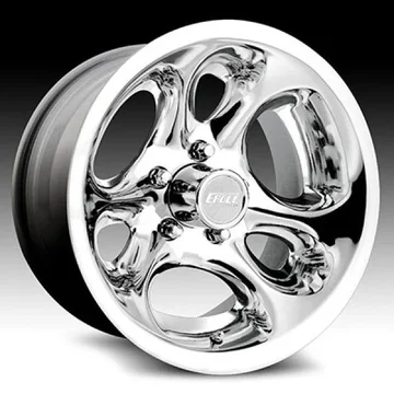

These you wer tryin to post a pic of them?

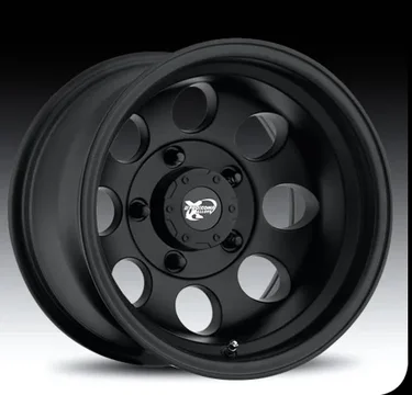

You cant get these wheels anymore. discontinued. I got a set of pro comp 15x10s on the way so these are goin up for sale as soon as they arrive. I wanted a set of five wheels. i like these, just cant find a 5th anywhere. the procomps are nice too
