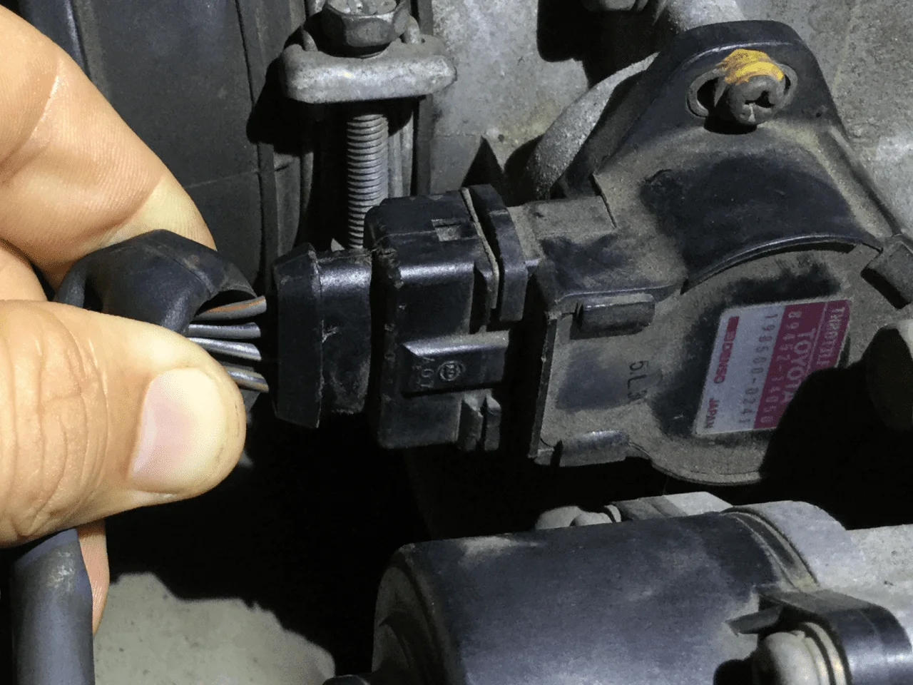

key on engine off back-probe the throttle position sensor and verify it moves smoothly from almost zero volts throttle closed to almost 5 volts throttle open. An analog volt meter is best or a digital with a bar graph.

I should have mentioned I am no mechanic. Could you please give more detail about
"back-probe the throttle position sensor". I apologize for my ignorance in this matter, just dumb it down a bit.
No worries mate.
The TPS is opposite the intake from the cable that moves the throttle plate.
The TPS has three wires. One is always 5 volts. One is always ground. One will change voltage based upon the position of the throttle.
by Back-probe I mean leave the sensor connected to the harness and push the probes of your meter into the connector from the rear. If the probes are too thick then make up little probes using the copper out of a cable TV (RG6 for example) cable and connect your meter's probes to those wires sticking out of the connector.
Alrighty, here is what I'm looking at. Three green wires and one brown. Which one gets the back-probe?
After 1 hour drive to purchase multi-meter, completed test findings are as follows.
Key on vehicle off - .5 volts
Full open throttle- 3.5 volts
The needle moved up and down smoothly several times.
Top wire 1 vc registered a constant 5 volts
Well the 3.5 volts is in range in the FSM which calls for 3.2 to 4.6 at WOT. So rule out the TPS for now.

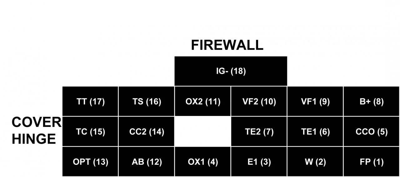

I would also like you to clear any old codes in the ECU by removing the 15 amp EFI fuse for about 10 minutes. Reinstall the fuse after that time and try to recreate the problem. If/when it reoccurs, read the codes according to the FSM.
Engine NOT running. Key OFF. Jump pins 3-6. Turn key ON. CEL will blink a series of codes.
I attached the EFI codes pdf below.
