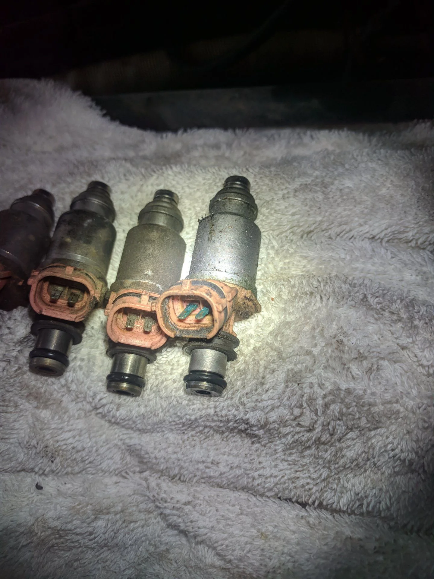

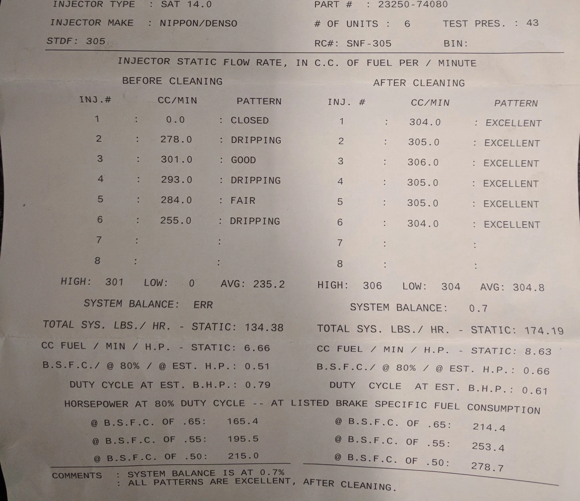

I ended up just pulling all my injectors and sending them off to rc engineering to get cleaned. So I am of no help there. Far right injector was #6.

Here's my writeup when I replaced mine -> Injector Service
