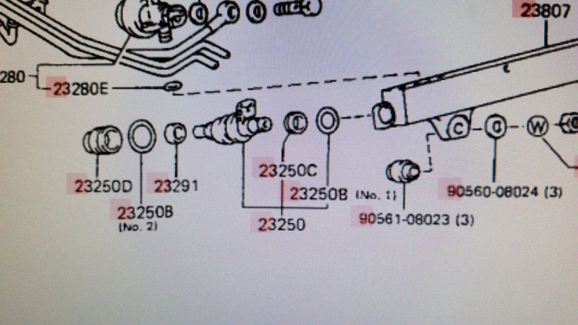

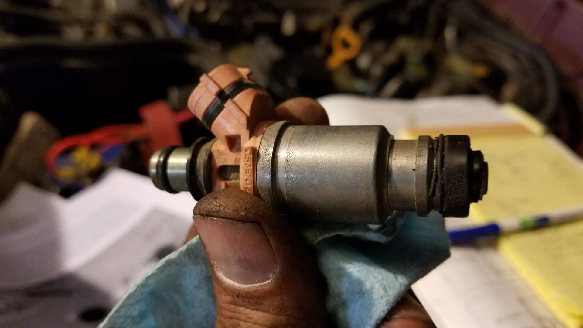

So, got it tore down to the injectors. Have a couple questions. The injector appears to have single grommet where it enters the intake manifold (see pic #1). However, the parts catalog shows three elements there, the grommet, an oring (same as on the top side) and a vibration isolator. The element marked as a grommet supposedly is only for 91-92 3FE engines. I have ordered the other two (oring and isolator) but am concerned that I will not have the correct part to interface with the intake manifold. As you can see from the injector photos, the current grommet is rather chewed up and should be replaced. My only hope is that what is shown in the diagram as the vibration isolator (23291) is the same as the grommet on the right side of the injector photo, in which case I will have six extra o-rings. Note the 23291 part does not come with a new injector (23250). Can anyone shed some light on this?

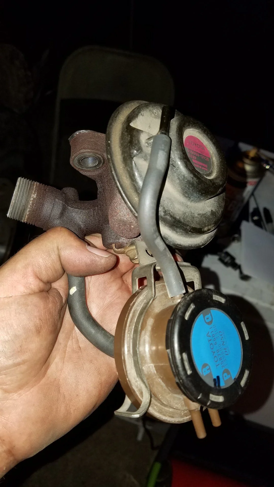

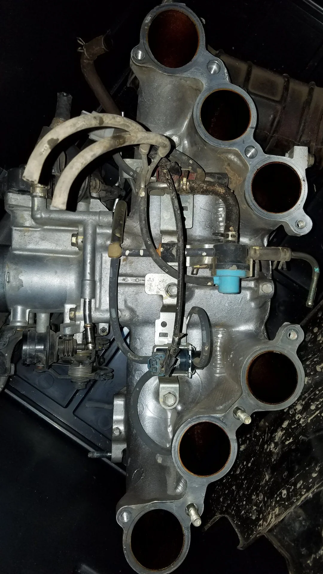

While I am in there, should I just go ahead and replace the the other components under the plenum? I replaced the VSV in 2007 (along with the EGR modulator) and am wondering if I should do a PM replacement of the other two components (top and center in this image, though I don't know what they are).
Also contemplating replacing the EGR valve itself while I have everything, though it isn't too bad to do later. Appreciate any recommendations.
^ on a '94 and on a '97 the only o-ring/grommets are:
1) one insulator (grommet) on the engine side that sits in the pocket in the head.
2) one grommet on the fuel rail side (not the same as the engine side).
3) one o-ring on the fuel rail side
4) one o-ring for the electrical connector seal
This per page SF-25 of the '96 FSM - and confirmed on the '94 I worked on and on my '97.
No washers or other stuff as per your FSM picture...
I've only ever had the EGR VSV fail, so whether you want to proactively change components - well, I didn't bother... I did change all the vacuum lines under the intake manifold though.

Thanks, George. My 96 FSM doesn't have a section called SF. I found a pdf version that does have it and it turns out that information is on EG-142 of mine. Hopefully that insulator is what I ordered - we'll see. Odd that my hardbound version does not match either your FSM or the PDF I found on Trollhole's website, even though the version (RM451U) is the same. I think I will let the other bits goes (except for the hoses). Getting fatigued in this hot weather.
Here is the old insulator.
Pretty sure this is the insulator (2329173010 )
Though it could be (2329141010), which is what I ordered.
