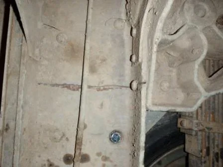

crack in frame. Both sides were like this. I ground out and welded up then put a scab over them.
