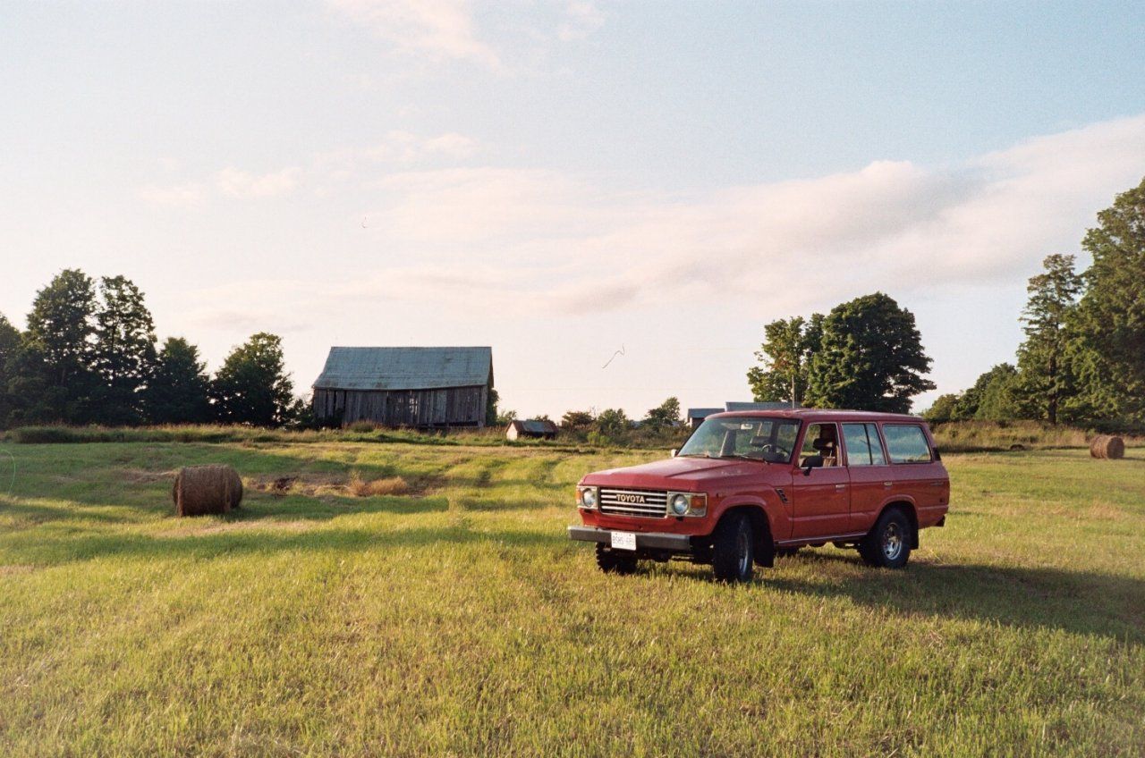

I just drove my 84 FJ60 across Canada last month with no issues (apart from blowing a tire). Once I had reached my destination some problems started happening. One day after it was running very rough I popped the hood and could obviously hear sparks happening. The car would not start the next day for about a week, and it took replacing spark plug wires and a new cap for it to successfully fire up. The problem (I think) appears to be at my coil. When its idling you can hear a buzz - upon further examination I noticed that there is a spark jumping from where the wire attached to the coil from the dizzy onto the nut (attached picture is the spark, its hard to see in the picture but its there).
