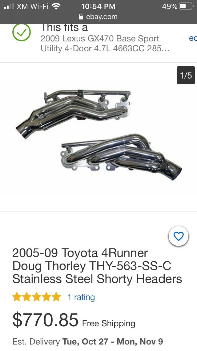

I don’t think so, if you look at where existing cats fit off the shorties pictured below. Expect you’d have to reroute to a dual exhaust and reMove the Y so cats and long tubes have room. Go to DT website that link to install videos. Comments of the installer after the fact are telling and why he charges $1200 labor. Know that DT started in the 60-70s when engine bays were spacious & not cluttered w all the pollution and computer equipment.
