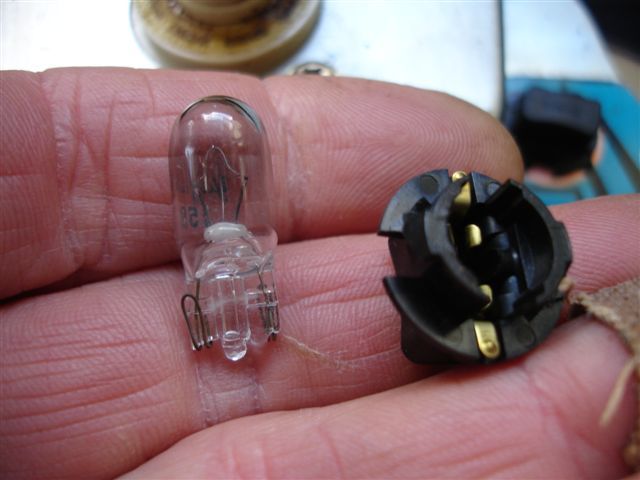

OK this is in the running for stupid question of the week. I have what I suspect are several burnt out instrument cluster lights and have found a source for new bulbs but how do I get the old bulb out of the holder. I have tried to pull them out but don't want to use too much force and screw something up. Any recommendations?
If you mean how to get the little bulb out of the holder which twists and pops out of the backside of the cluster then just wigggle and pull - they are push-in spade type bulbs
1/4 turn to the left and..... :bounce::bounce2:

Depends on the year cluster you have. On pre 9/71 the bulbs have a metal base and must be pushed in and turned.
