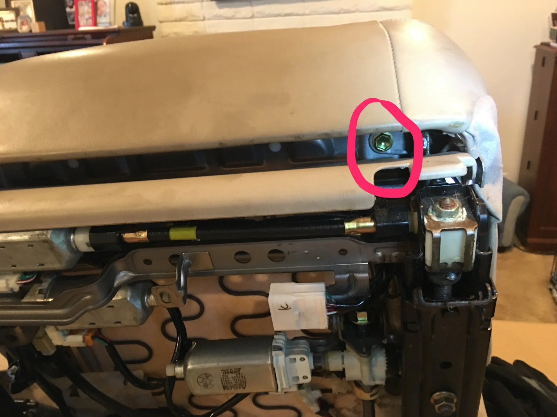

I bought the Lseat leather and have pulled out the passenger seat. Now that I have access to the underside of the seat it's not quite as obvious what bolts I should be removing. I searched but could not find any instructions for the 100 series (I found these threads for the 80: Installation of replacement leather and AATLAS1X Leather Install).
Anyone know where I can find instructions for the 100 series?
By the way, the red circles are the bolts that I *think* I need to remove to get the seat bottom off of the frame: two at the very front of the seat bottom, and then one on each side of the seat (pictures show one of the front bolts, and one of the side bolts). Any input would be appreciated.
have you figured it out yet?
Iirc you have to take that black metal strip off the front. There are 4 black oxide bolts further up inside the frame that hold the seat bottom on. I think it took a long extension to access them, 12mm maybe? Those bolts are on "L" shaped brackets that allow the seat to be adjusted.
After looking at your pictures closely, you are correct. Those are the bolts in referring to.
Which means you probably figured it out...... and got your seats in...... and are now out crushing some trail with you awesome rig!
Nijas- Thanks for that, those were the bolts. Just had to disconnect a few electrical connections and then I was good to go.

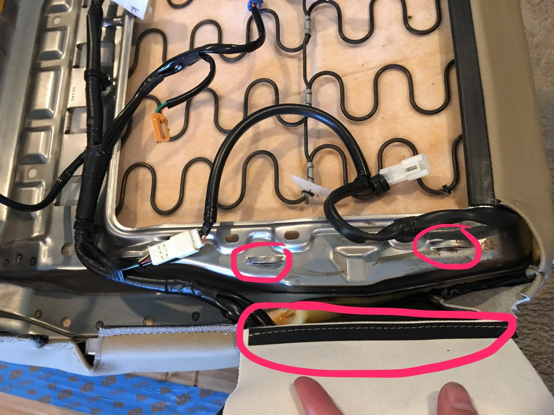

Another request for help- I've got the leather almost completely on the bottom but there's one flap of leather that doesn't have an obvious "home." It's the big red oval in the picture below.
There's a plastic strip attached to it, and then some hefty metal loops built into the seat frame (the small red ovals in the picture below).
I can put hog rings through the leather and around the plastic strip, and attach at the two metal loops, but not sure if that's what's intended, and I hate to just put a hole into the new leather.
Anyone have any suggestions?

I did this a couple weeks ago. It took me a little over 5 hours. For that part in your last question, I put hog rings there. But I was able to get them both in kinda between the plastic and the leather—they weren't visible from the outside. However, if I remember correctly, that area is covered up by the trim panel with the seat controls.

The piece of leather that I'm trying to figure out how to attach is actually underneath the seat, so it will be completely hidden. My concern is that if the leather starts to tear, it could cause "looseness" on the top of the seat bottom (where we sit and which is visible). There's a plastic panel sewn onto that strip of leather, so the manufacturer has something in mind for it. I'm just not sure what that "something" is.

I hog ringed that strip as well. I think the flap gets tucked behind the trim to fill the gap.
