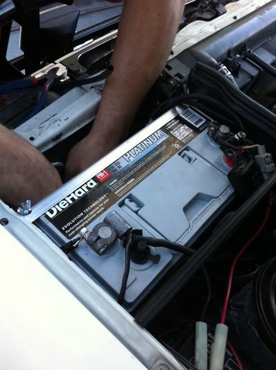

By the way, to fit the Interstate 31, I needed to dremel a small part of the one corner of the battery box that rises up (drivers side rear of the box), used 8" j-bolts from the local parts store (which needed to be shortened a bit more on the DS), and made a hold down bracket like unwiredadventures' in post #13 ($3 of aluminum at Lowes). I also used plasticoat spray on the aluminum. It's REALLY tight, but it fits.

I made my own tray out of aluminum diamond plate, but not for this specific battery. I am not kidding when I say there was not an extra mm of room to spare. I did need a longer bolt on the front end of the hold down. I also had to adjust my ground because it was hitting the hood when closed, preventing it from fully closing. I put a piece of plumbers putty on the highest spots on the negative side, and there is about 2 mm between the top post and the underside of the hood on that side. I have plenty of room on the + side.

The trimming trick worked perfect. Still need to make a hold down straps. Boy...my back is killing me now.
I just put this in (along with some IPFs) this weekend. Trimming was spot on, and only $12 in parts: Lowe's 3/4" steel angle iron ($4) Kragen's universal J hook kit ($8). The fit is TIGHT; the DS retention bar is under the fender lip, and we had to check 2-3 times to make sure that wing nut cleared.

Did this today, easy really, wiring needs be stretched and the cutting of the fins and some longer j hooks with some angle steel and bam all together!!
Bump to the top and a tip of the hat to DMOZ for his original post on what it takes to install one of these bad boys. The PM1 is rated at 100 Amp-hours, so a nice solution for those of us with refrigerators who are running a single battery system. Just returned from a 3-day camping trip last weekend and had no problems starting on Sunday when it was time to head home. Because the PM1 weights nearly 80 lbs I also beefed up the hold-down anchor point on the battery box with an aluminum plate that I pop-riveted to the box and picked up a watt meter off of eBay so I can monitor the refrig's power usage (see photos).
