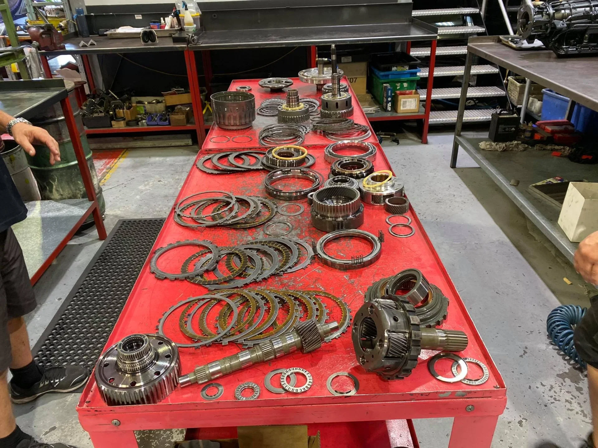

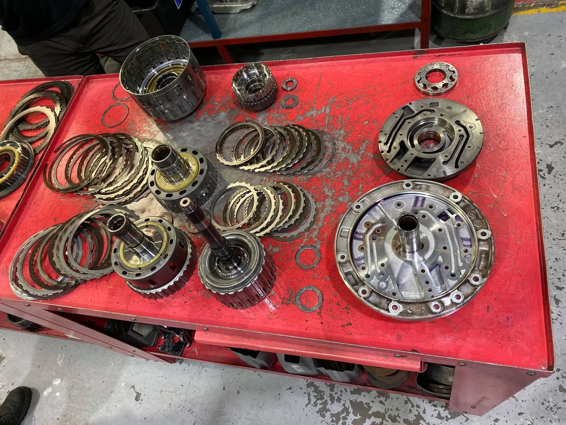

Video is posted by Rocket Rod in Australia. He also provides very good information on how to prevent burning clutches (at 26 minute)
Great video!
Another that helps us understand what all of that stuff does:
Great video. Takeaway is to use more low range when off-road, and don't rely on the torque converter to do all the hard work and overheating things.
I've tripped the thermal thresholds towing in high gear on steep grades. There, the ECU can lock up the torque converter in both 2nd, 3rd, and up to manage heat.

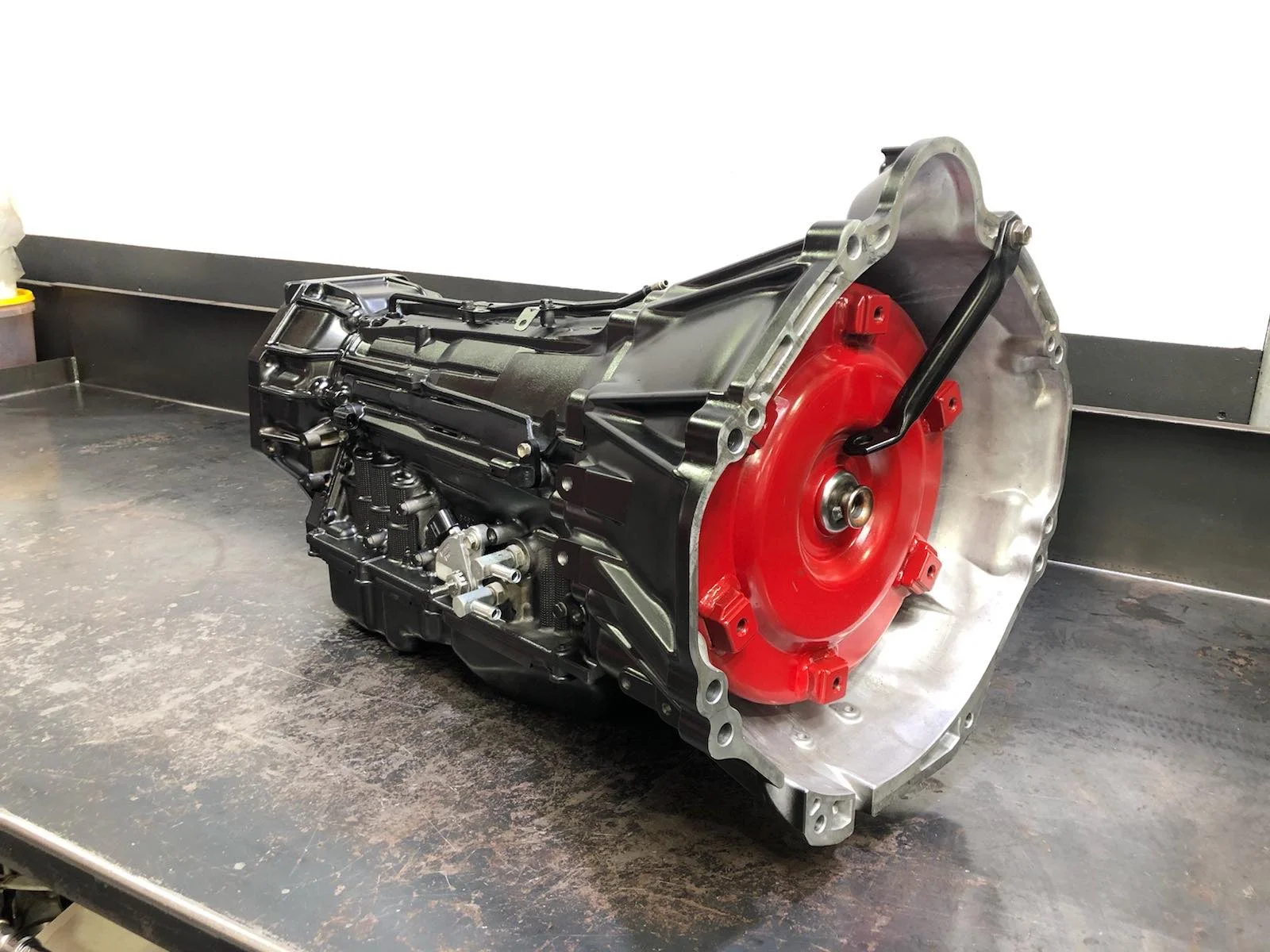

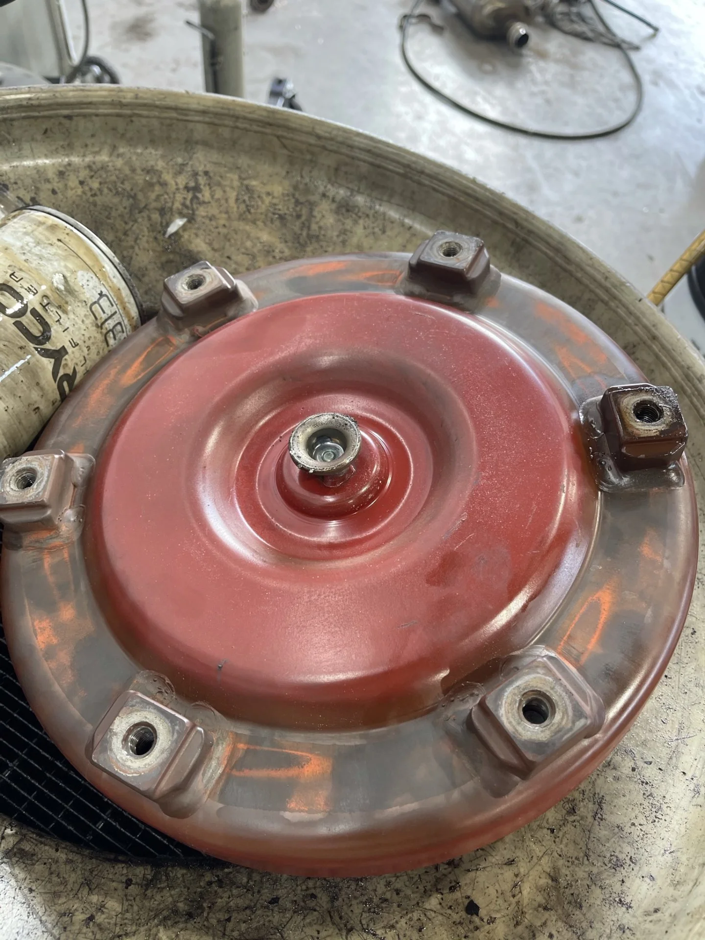

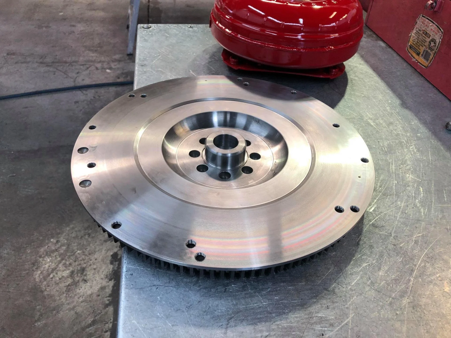

Ive been there........ twice. They dont like 1000nm of torque and shed skids (it was Xmas, it was required). Burnt the TC out once, Ripped the flex plate apart (made a billet one from a flywheel), New clutches and valve body, new cast pan

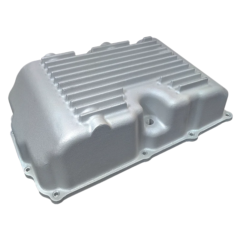

Interesting thread. I never really think about the trans on these rigs, probably because we don't drive in the sand as much as the Australians. The video seems to imply the AB60 has a habit of overheating in certain environments. Going down the rabbit hole I found this B&M high capacity pan kit.
