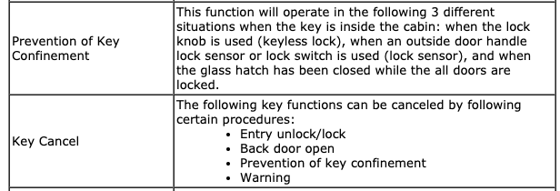

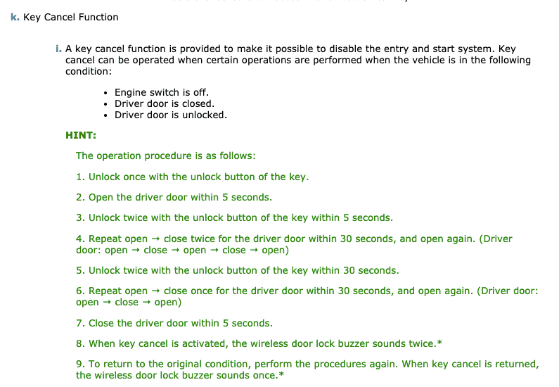

Looks like this Key Cancel function can possibly be used to lock a FOB in the vehicle

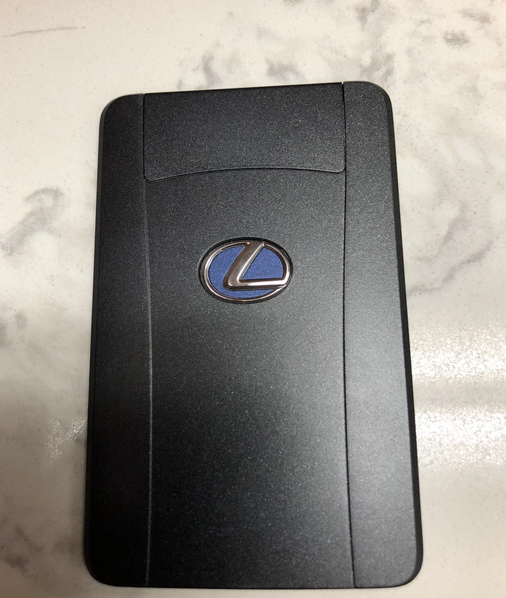

You can always use physical key in the FOB to get in the driver's door and FOB placed against the START button (even with a dead FOB battery) will start vehicle.
I have one of these Smart Cards programmed for mine and it just sits in my wallet like a credit card.
View attachment 2585620View attachment 2585621
Oh my gosh! I think I'd be easier to do the Hoky Pokey dance!
This is similar to how I had to program the keys for my 100 series Landcruiser.
I know from experience that I'll be sitting in my car for half an hour trying to get that sequence steps right, much less ever remembering it!
With all due respect Acrad and truly appreciating the info, I'll just keep the battery out of the fob. Actually doing that, one doesn't even need the Faraday case either!
Agree... that would have to be one special situation for me to try that myself. I though the ritual to get OEM RES (Remote Start) was something... this is another level.
This is my suggestion, helped my buddy with this very issue last week when he called asking how to start his GX with a dead key fob battery. Too easy really.
