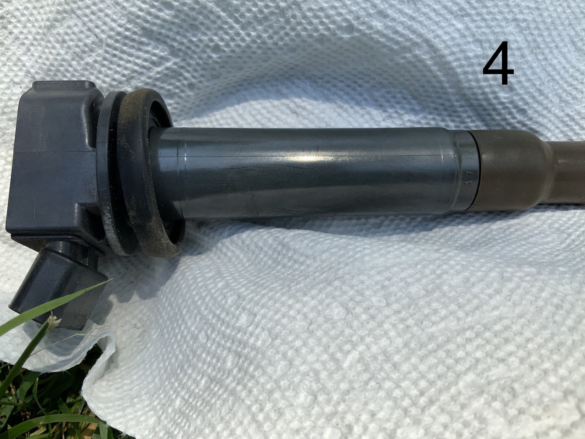

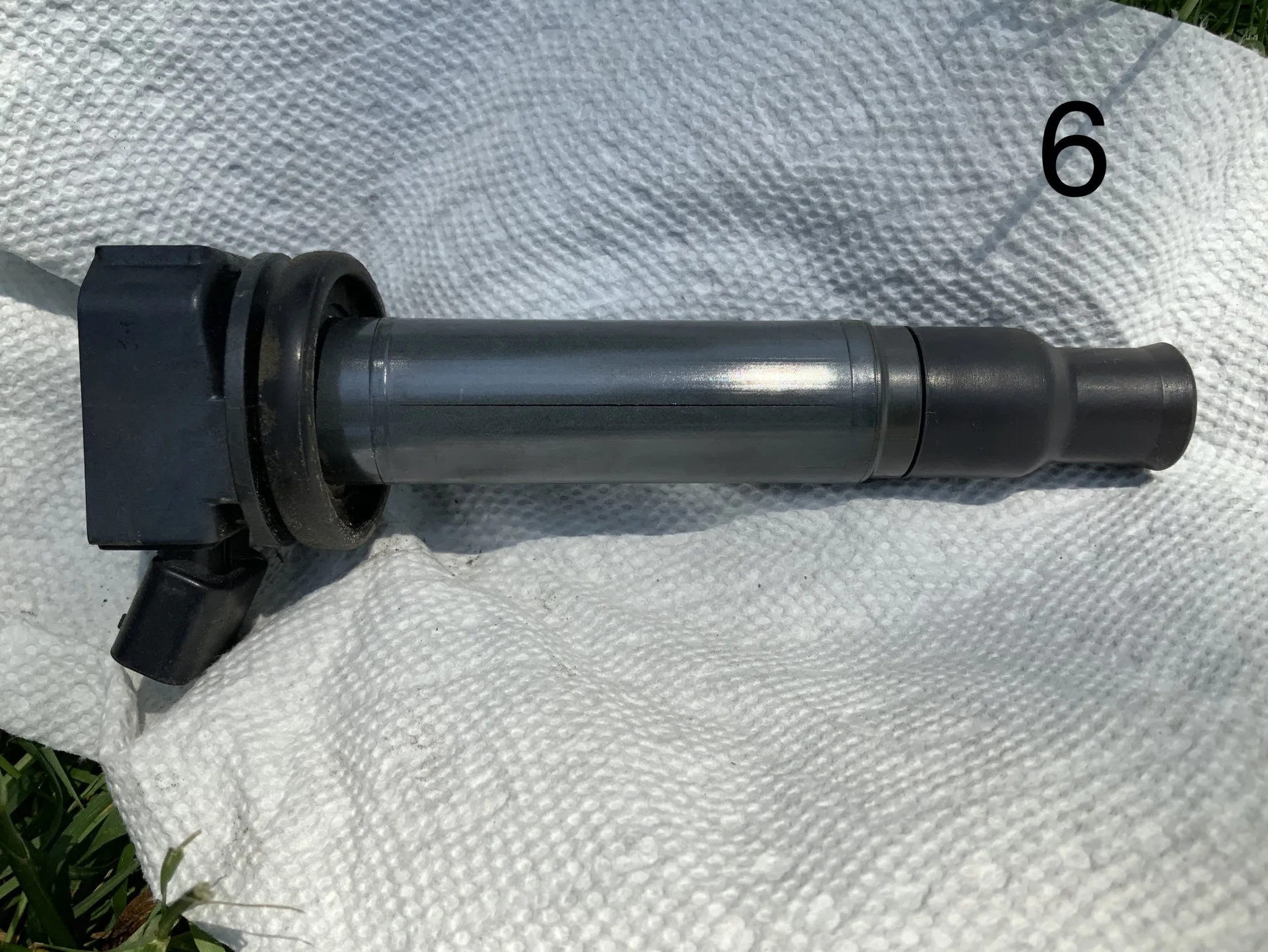

Replacing plugs on a '03 LC. Did the (easy) passenger side first. Two of them are definitely cracked. The others look like a seam from the manufacturing process is widening. Pics below.
Looking for guidance on which ones should be replaced. Has anyone had success with non-Denso aftermarket? Denso are $122/ea. Ouch.

I would not use them if cracked- that’s misfire waiting to happen. Dont waste your $$ in aftermarket coils.

Thanks, abuck99! So the widening "seams" that run lengthwise down the coil are cracks, correct?

Dang! I just bought 4 from Toyota at $113 each. Good to know that these are an EXACT match. Though I don't know when I will see another issue. I am replacing three that have a crack or split seem, and putting one in my spares kit. Only cylinder one is throwing a code right now, and I cannot see in the carfax when the PO's last changed spark plugs, so at 408,000 I am changing plugs and addressing the weaker coils. The other coils look great, it seems that the corners are getting the most wear/damage.

I replaced 3 with cracks early this year as a precaution and kept them as spares. Low and behold, last month I had a misfire and it was one with no cracks…still likely had 275k miles on it. A cracked one went in its place with no issue until I got a new Denso.
The way those sit in the tubes I doubt the cracks would result in a misfire. I even thought about just sealing the crack with gasket maker, but then just spent the money and now have spares.
