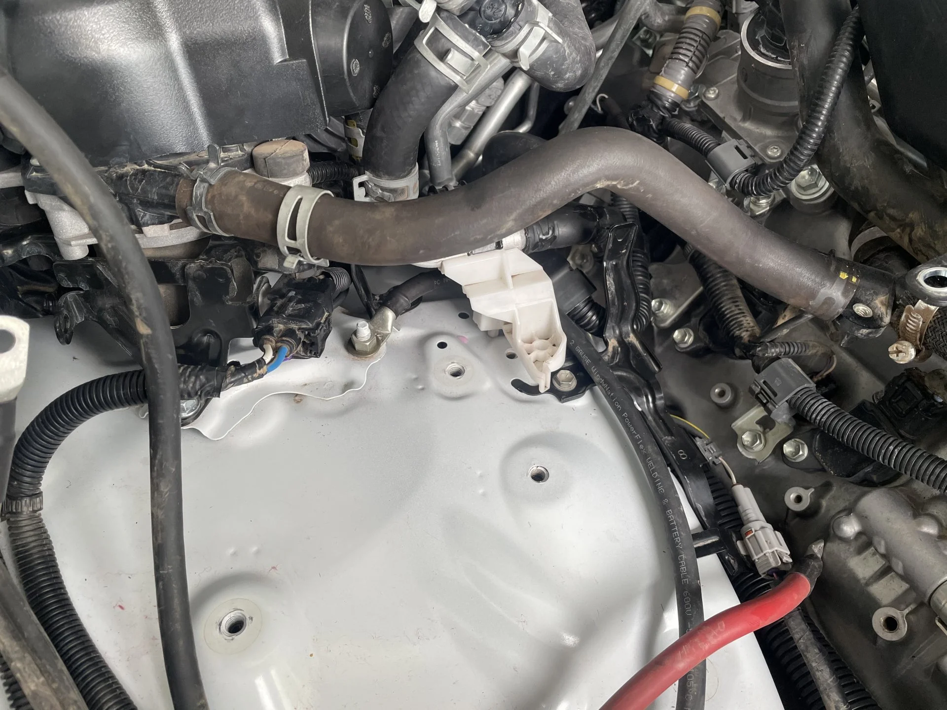

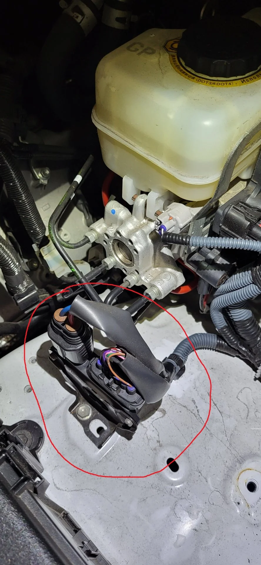

Does anyone know what this wire harness is and can it be relocated to create space for either a 2nd battery or an air compressor? This is under the plastic cover behind the battery and fusebox. I was thinking about moving this probably to the right and rear to open up this dead space.
I'm interested to find out as well. Just started opening up some space there yesterday to mount my compressor. I've seen folks use a blank PowerTray for a compressor mount there. I was tempted to go down that route, but they're backordered for a couple months. I'm planning to fab up an aluminum tray over those wires. Won't provide room for another battery, but the compressor will fit.

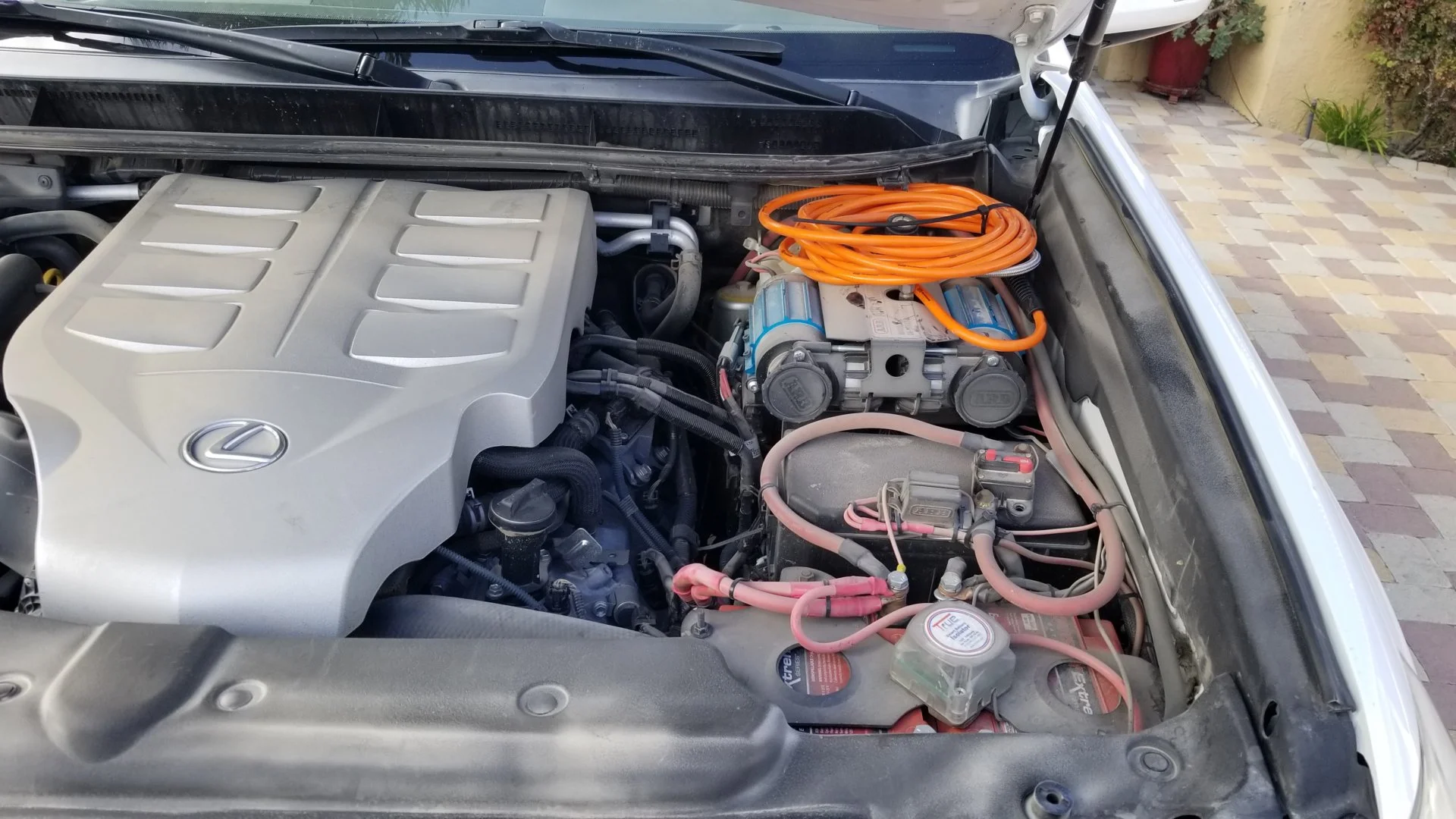

Just an FYI for those wanting an engine compartment compressor, Slee off road sells them here:

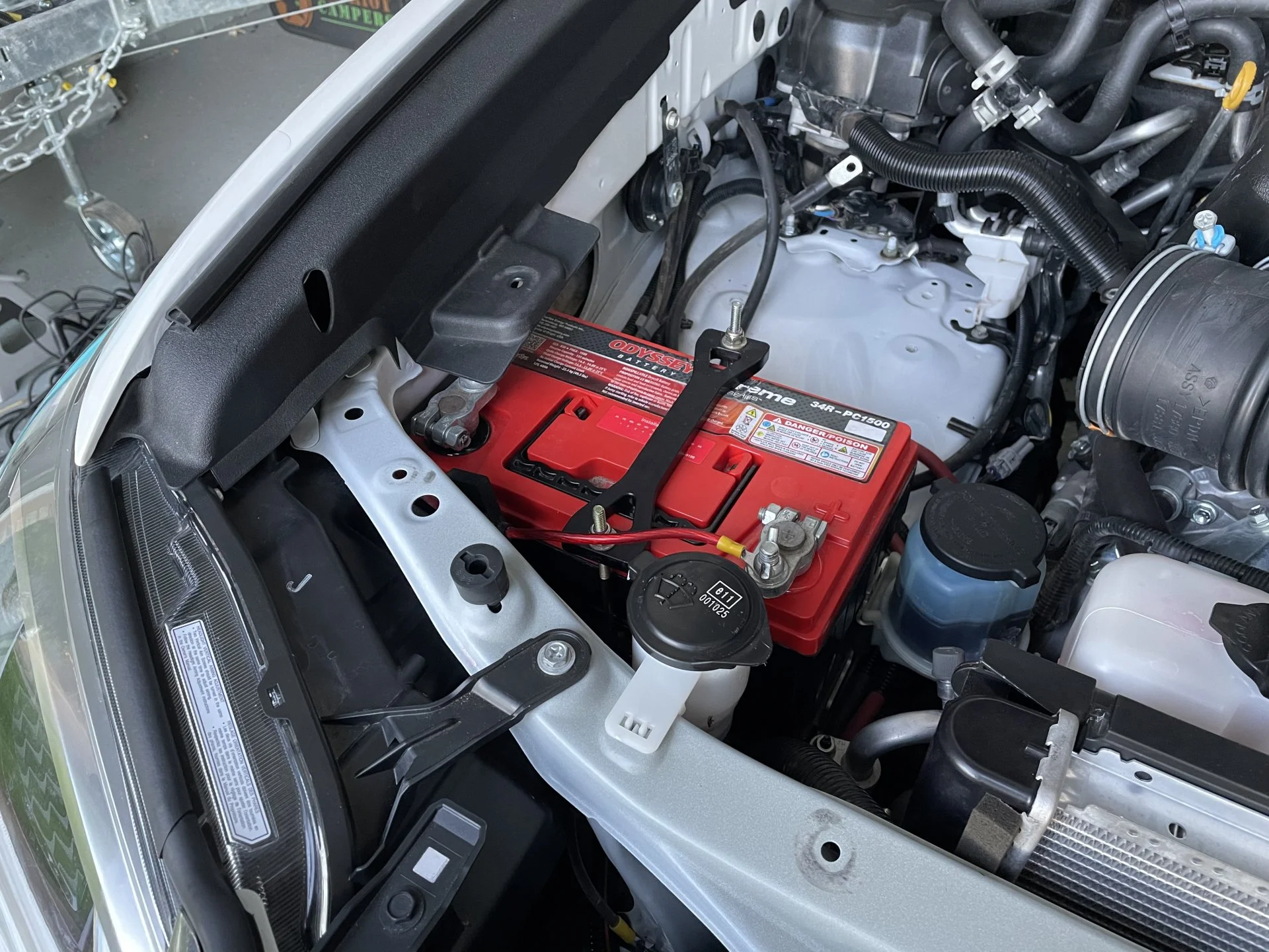

It puts it on driver side next to fire wall. Note: I keep my air hose on my compressor with a reusable cable (zip) tie. And yes, that is a second battery in the stock location!
Nice. I cheaped out initially and just got my modified Smittybilt and 4 tire hose tested last night. Figured I could always swap an ARB in later. All in for around $300 so far. @r2m, did you get a dual battery bracket somewhere or is that custom? I can go back through your build thread if you mentioned it there. No need yet, but power may be on the list at some point and I like the batteries under the hood.
Unfortunately it is custom. The shop that built most of my rig, YotaMasters, made it. You could give them a call to see if they can fab up another.

Slee makes a bracket for a twin arb that mounts over that connector, so no need to move it. As far as second battery goes, there’s plenty of room on the other side of the engine bay of you relocate or delete the air injection system and use the shrockworks battery tray.

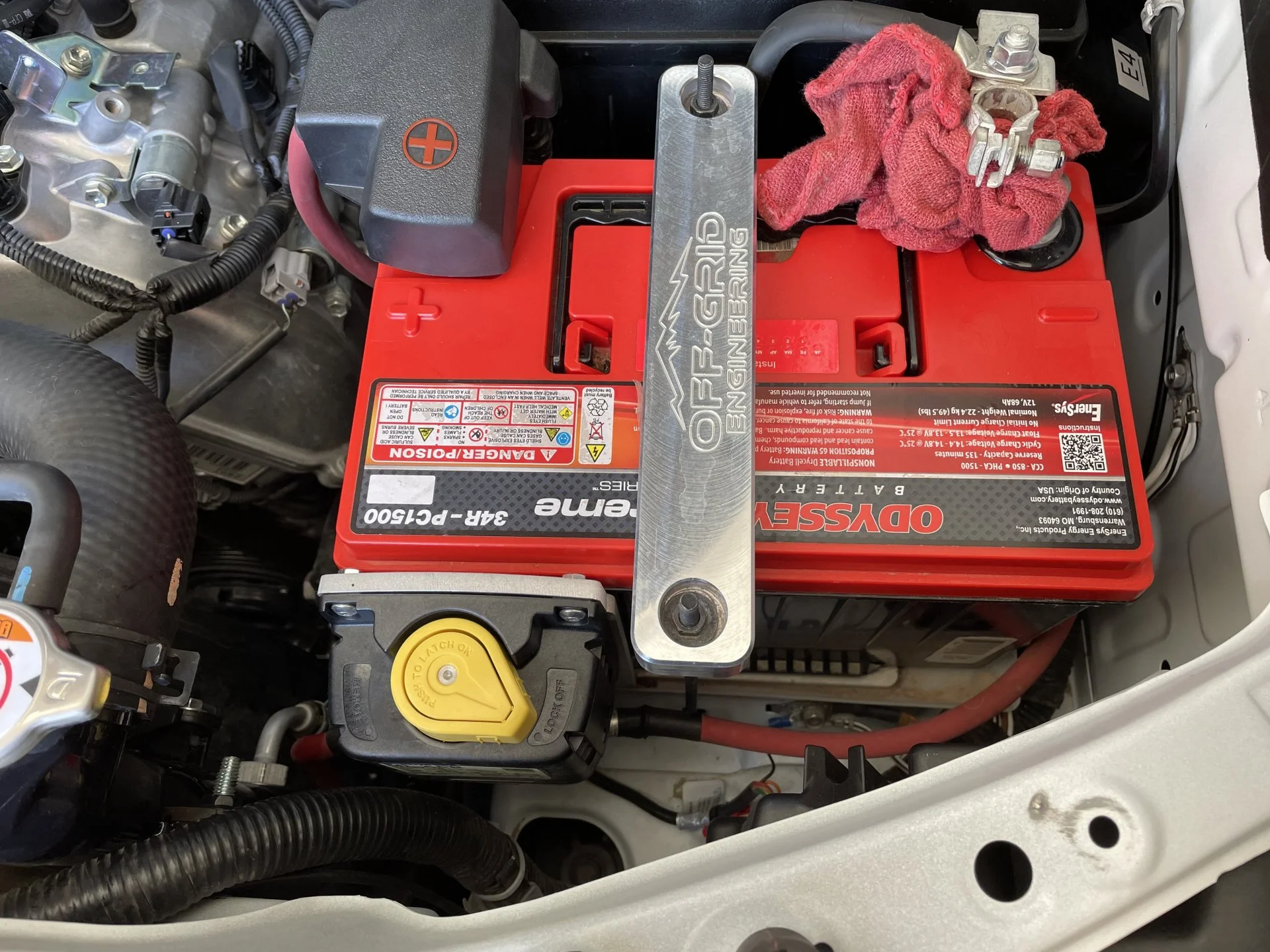

With this set up both batteries are the same size… group 34 with each with a 68 amp hour capacity.
Here’s what the other side looks like:
