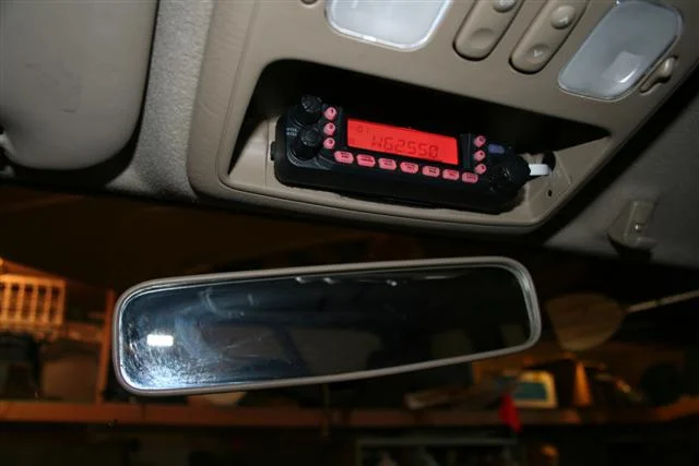

Like everyone else, I am constantly wondering where I am going to put the things I want to eventually install. With the HAM, since I will have a unit with a remote head, I think that gineric lc's install location was a nice idea. I don't wear sun glasses anyway because I need prescriptions, and the location he used gets rid of the useless (to me) flip down sunglass holder in the Cruiser. Now, another location I am seriously considering, is actually attaching a RAM type mount to the front of my ashtray, and placing the radio head on the other end. This would allow me to position it near the mother unit and give me a good view and easy access. I am almost positive I am going the ashtray mount route, but I'll know more when I get the radio in hand to check it out.
Here is gineric LC's mounting location (swiped from his thread)
