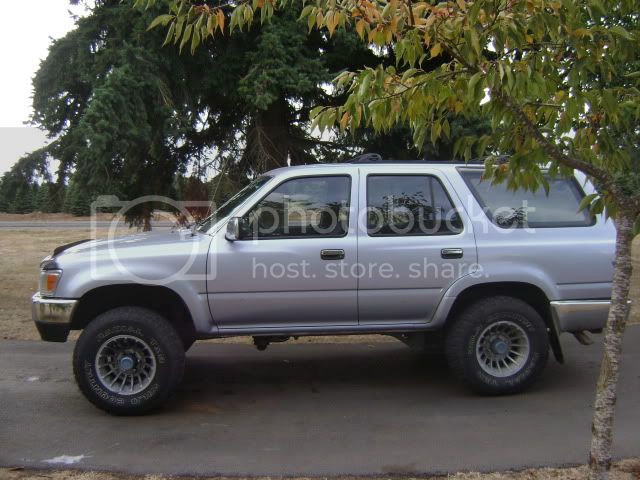

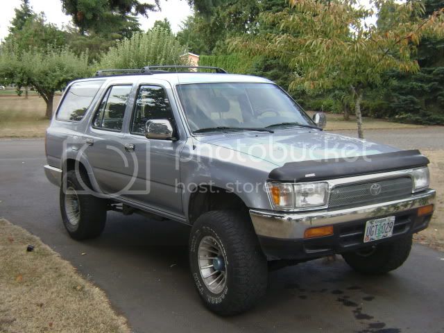

So here is my 1995 4cyl 5speed 4runner.
Its 4x4 and I want to make use of that. But I dont know where to start.
I am mostly new to off roading, there have been a few times where a buddy and I have taken his 83 pickup through the woods, but its stock. And the woods are pretty simple.
Where is the best place to start? I kind of want an Cold air intake, because it is only the 4cylinder and its a bit heavy so it dose not have a ton of power. .
Any suggestions on how to get started.

those tires look like they need to be scrapped. slap on some BFG MT's.
