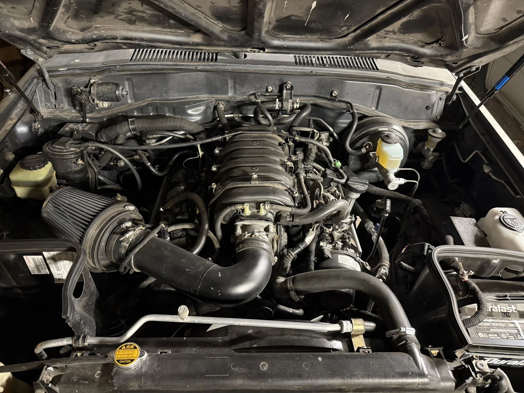

For those that are not following along on my build thread where I have been trapped in diagnostic hell. I have swapped a 2uz VVTI with H151F transmission into my 80. I have worked through a series of trouble codes until I am where I am now. I am getting P0171 and P0174 lean fuel codes and cannot resolve them. I am hung up on the idea that me air intake or MAF could be the issue.
I would like to install my intake and MAF on your vehicle to see if it creates any codes. The vehicle could be a Tundra, 4runner, Land Cruiser, or Lexus as long as it has the 4.7 VVTI engine.
I am up against a serious time crunch and this coming weekend is my last chance to take a crack at it. Is there anyone out there willing to drive to the Jemez and let me do this. I can offer beer, great scenery, maybe some pizza. I don’t know what will take? Oh, I can offer to memorialize you in my build thread on Mud or not.
Not an ordinary ask I know but figured I would try.
Picture of my problem. It is so close to done.

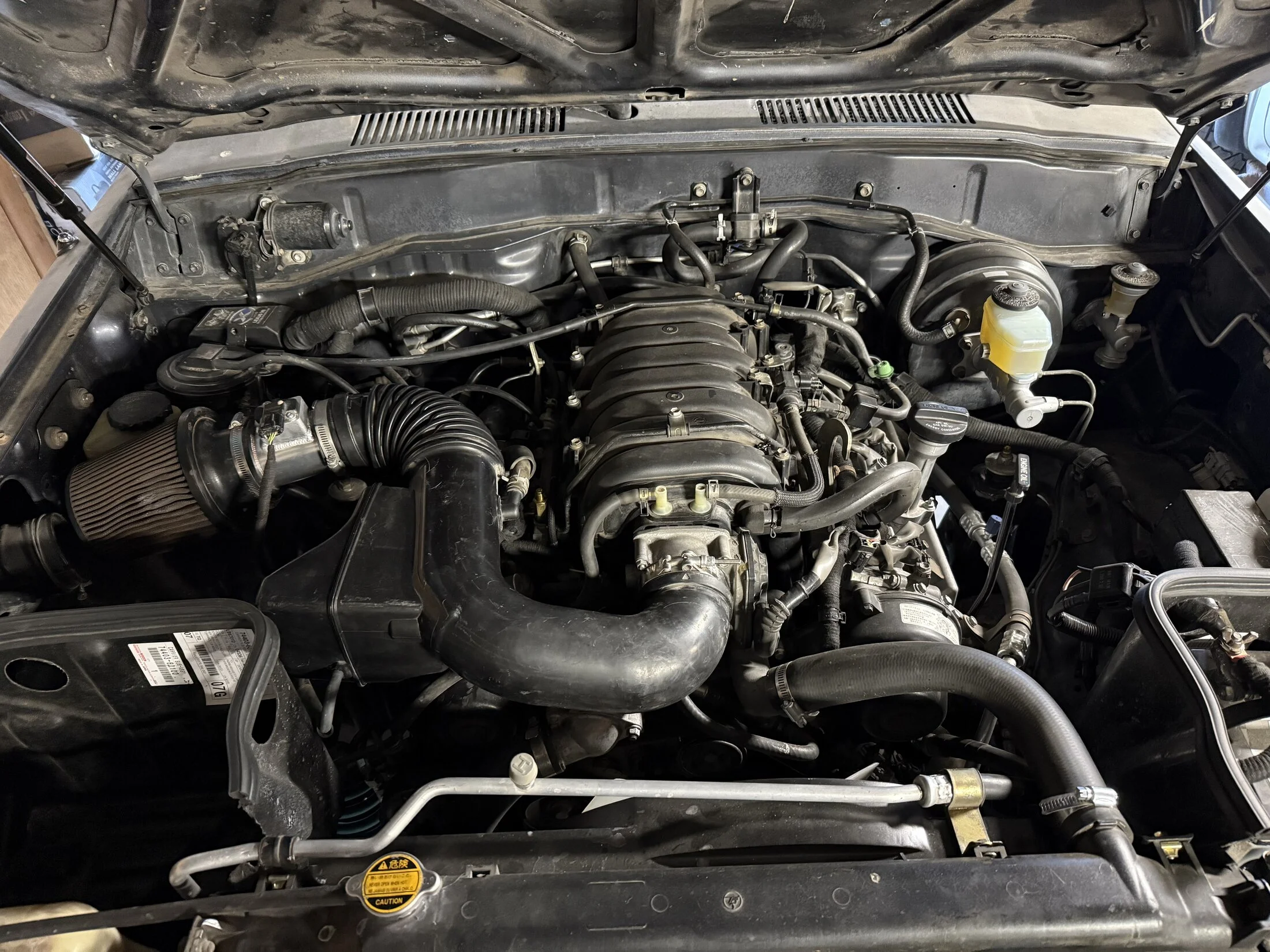

I may have made a break through. I cobbled this setup together using an oem intake tube and got better fuel trim results. I will have to hunt down and oem filter box next to fully test it.
