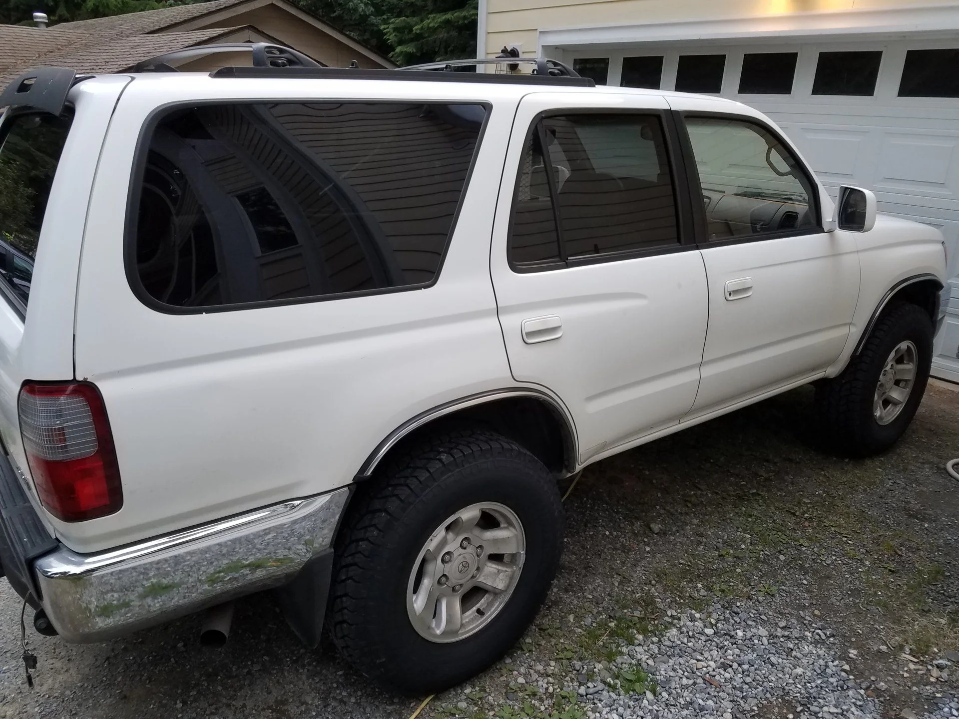

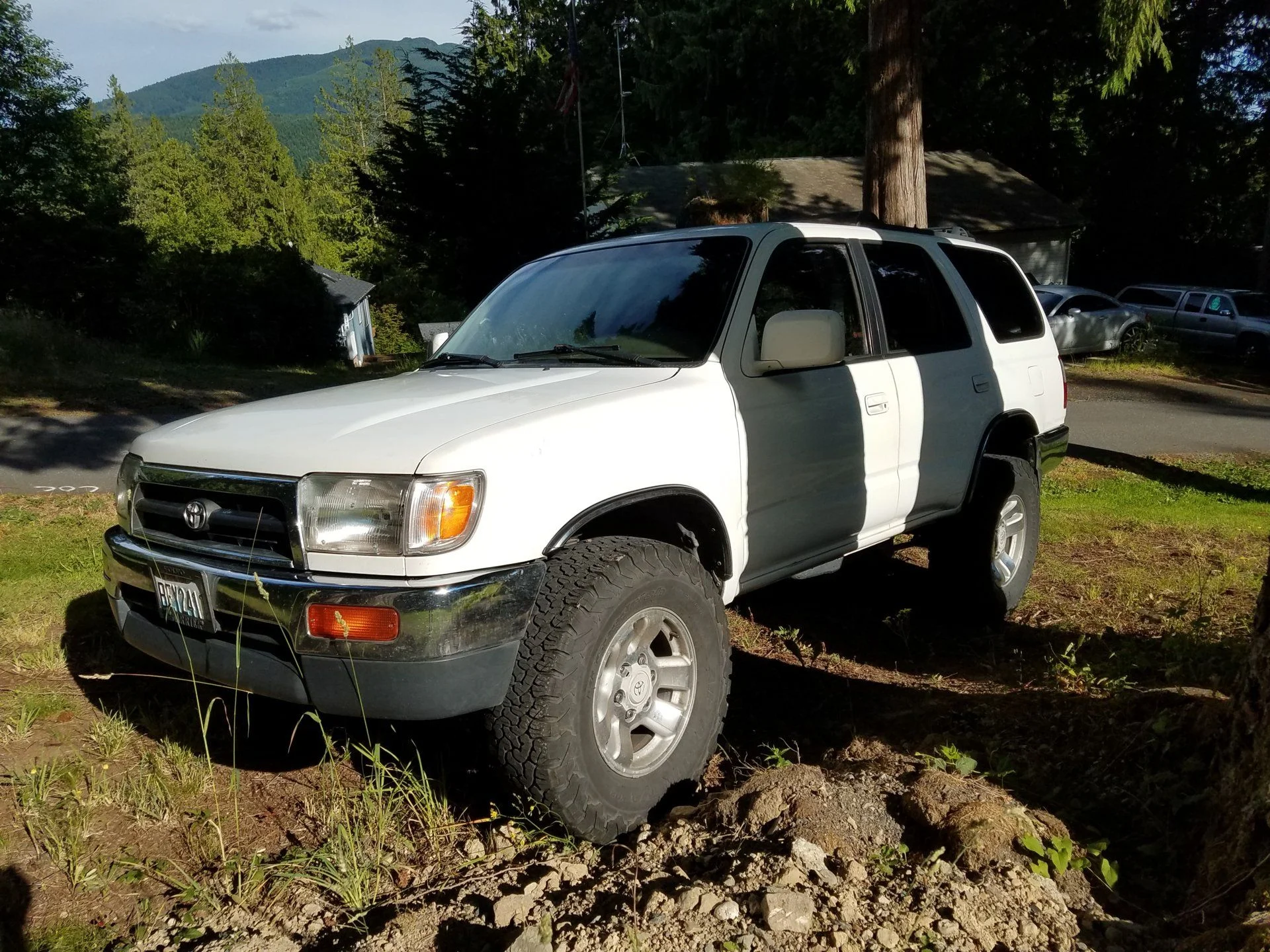

I need to stop buying vehicles.... 1996 4Runner

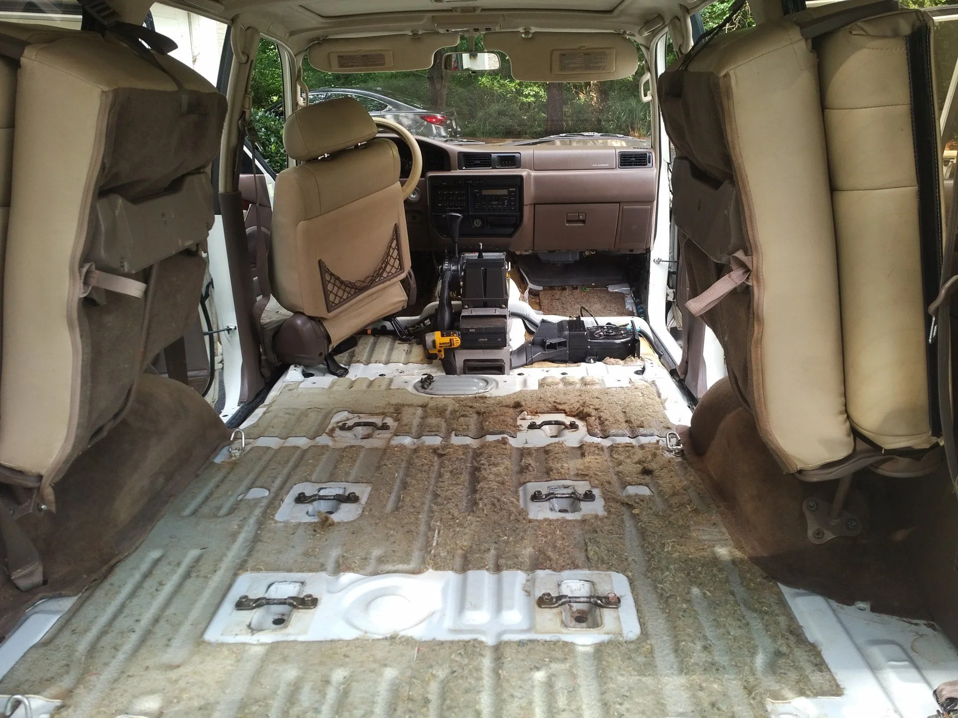

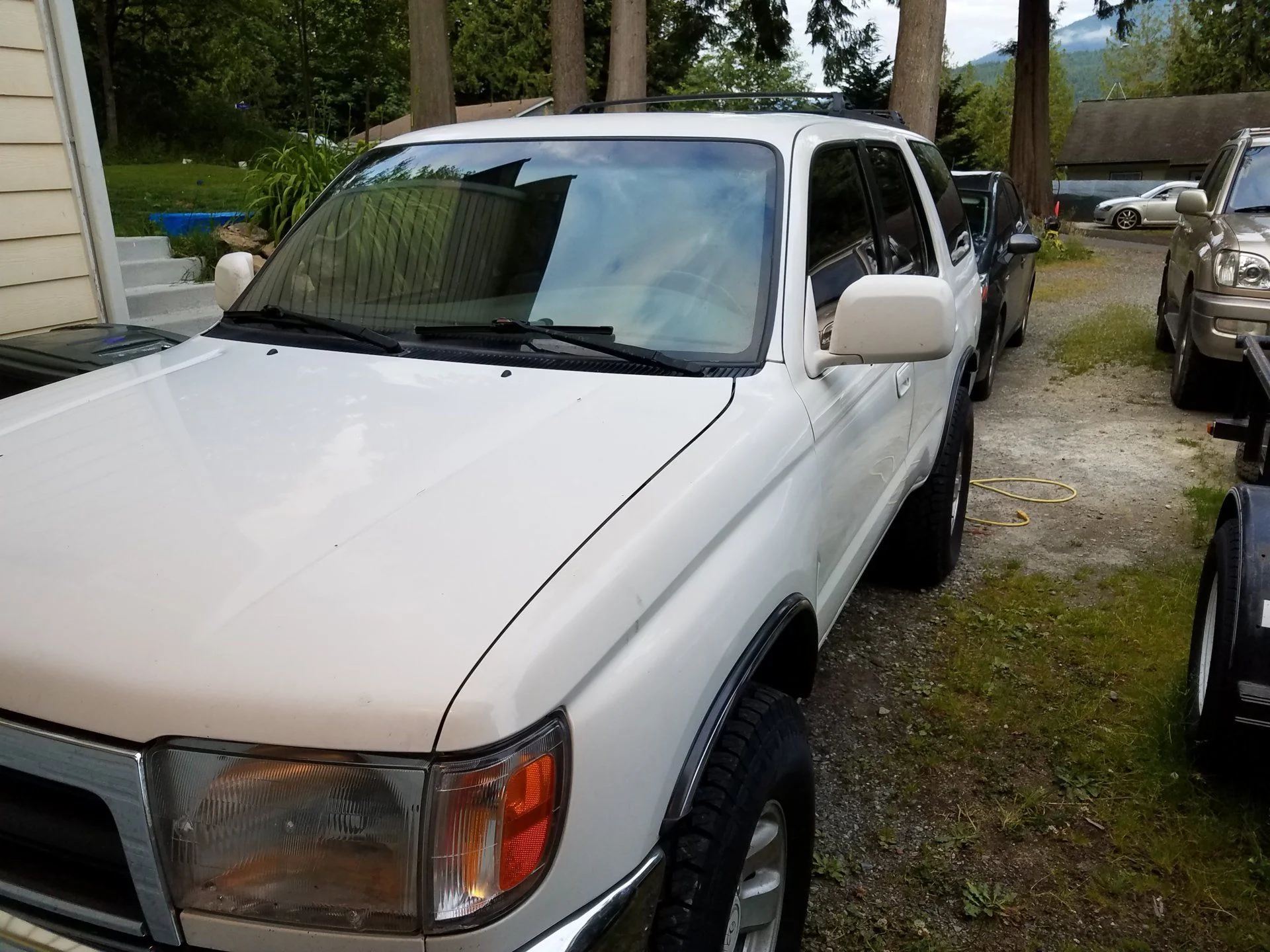

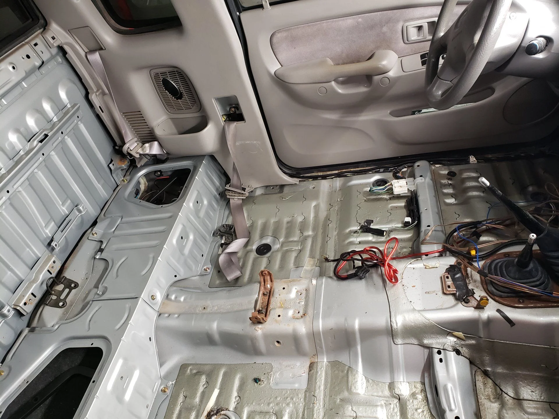

So disassembly of the auto has commenced.
Rear end is completely out and in the garage.
Rear hatch, side mirrors. and wheels/tires sold off.

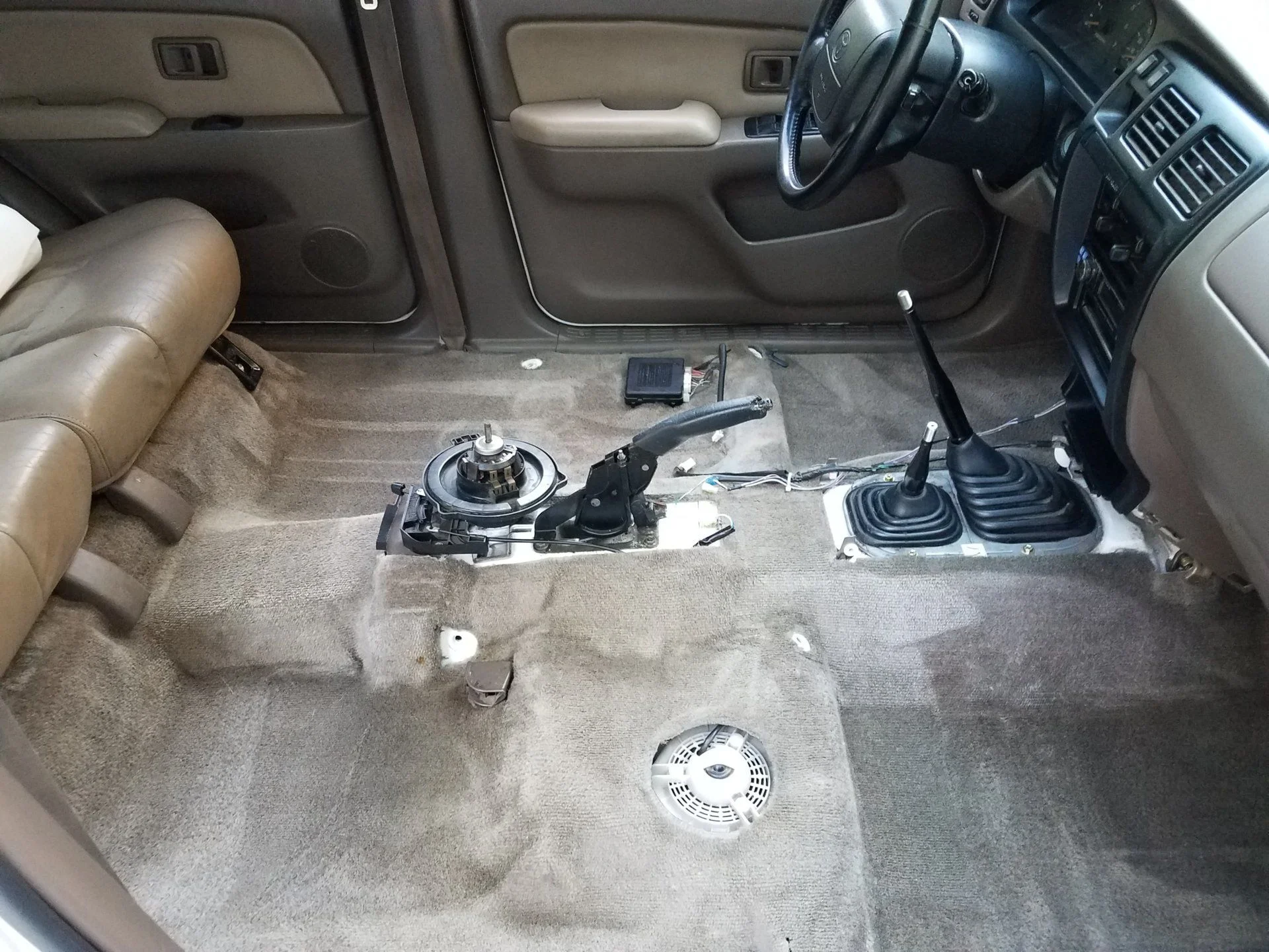

3 of the 4 rear seat pieces will be swapped onto ours.
Debating on the fronts.

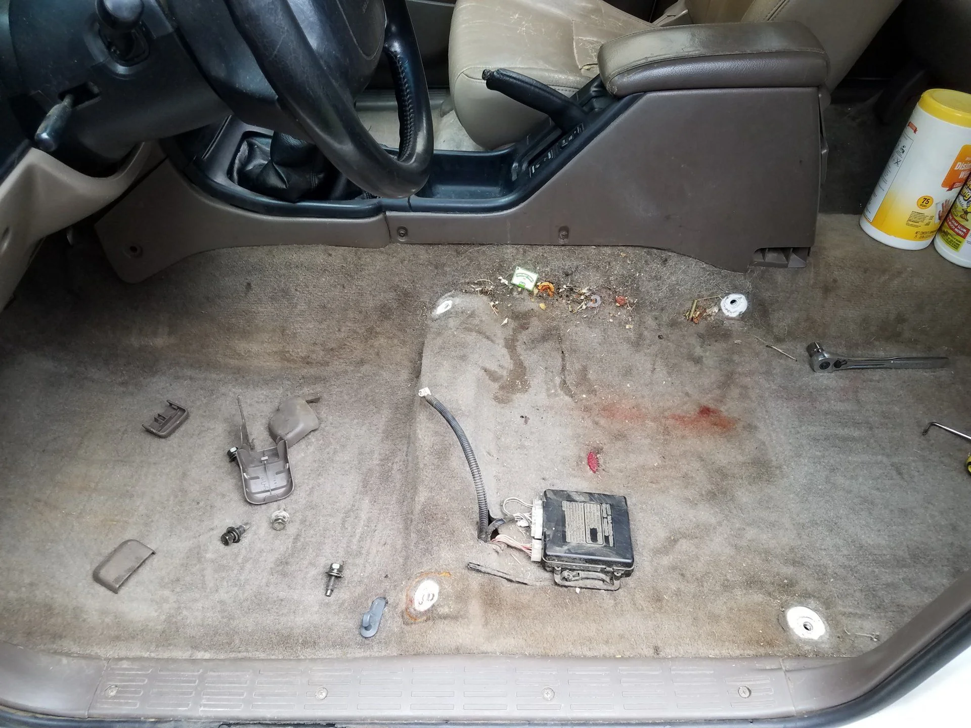

All of the wood grain pieces, and the Sony stereo from it (what a huge difference over the Alpine unit, and generally i hate Sony), plus the center console were all swapped over.
Front glass was swapped to get the tinted windows (though the tint job is horrible).

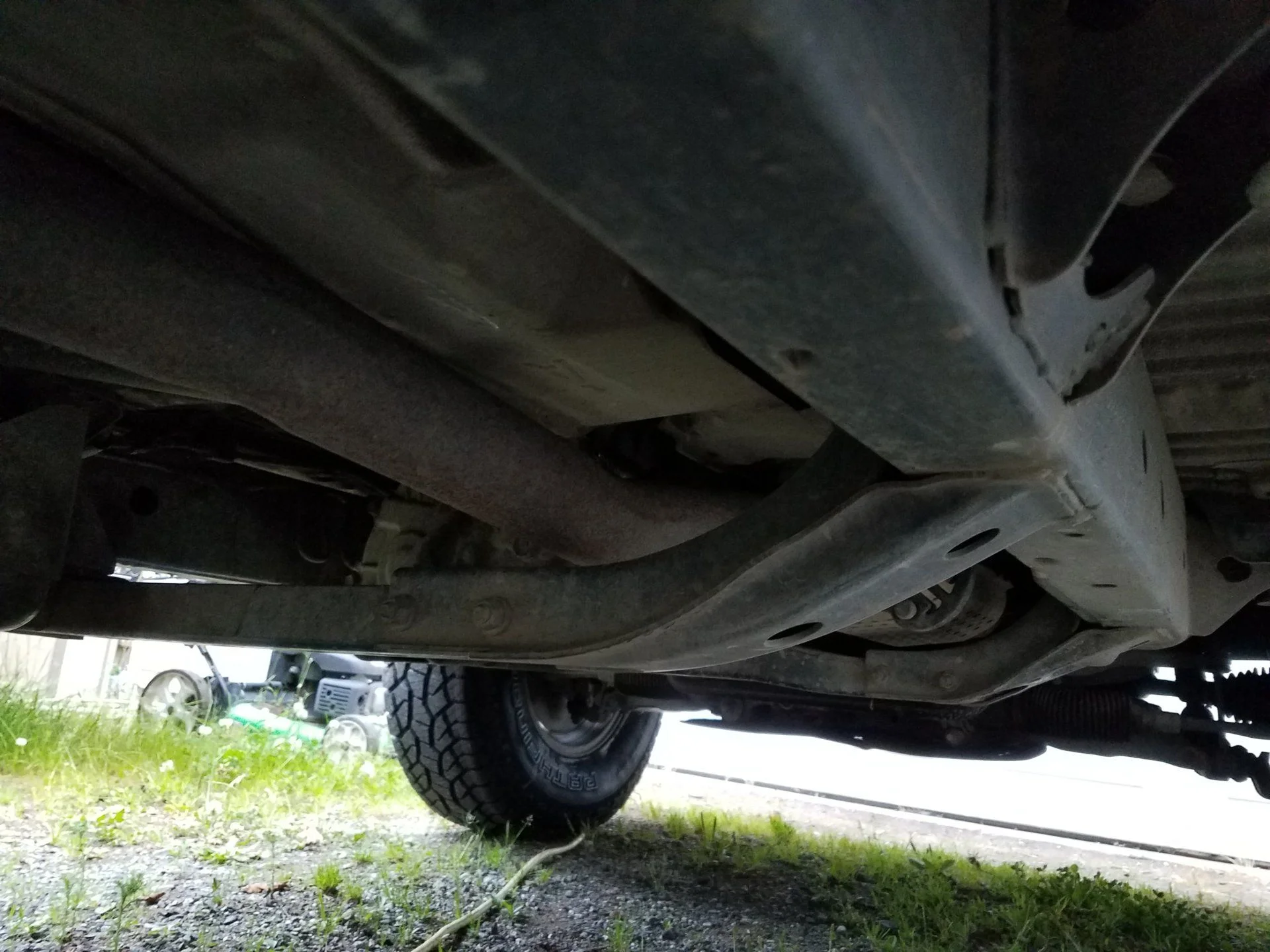

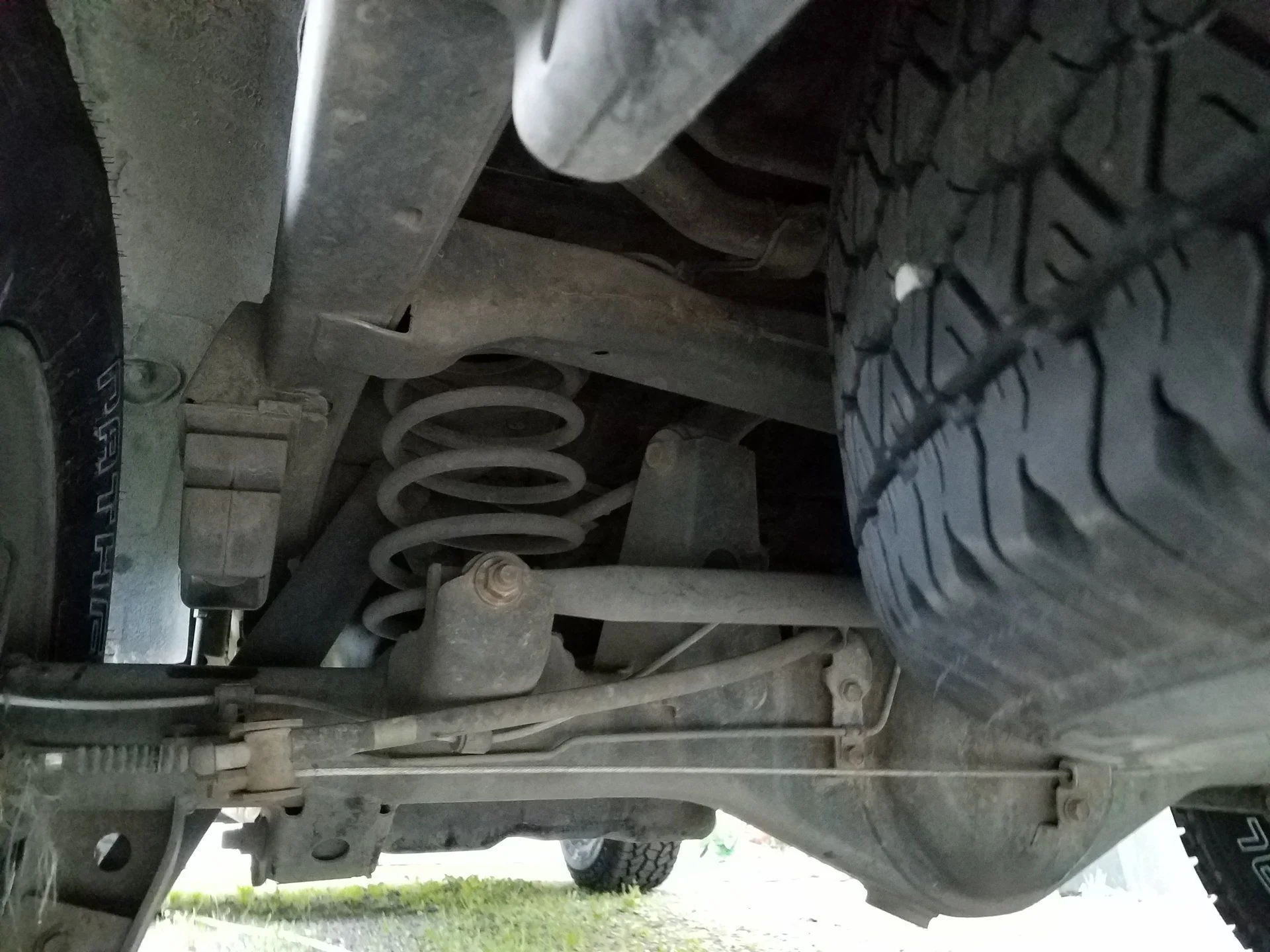

Once the auto is disassembled and gone the manual will get the suspension work done.
After getting it out like this, and fighting it, I'm pretty sure they were meant to be removed separately...
Front diff is out.
Also pulled the steering rack - this will allow me to change the tie rods (inner/outer) out of the vehicle and just swap the rack (just 3 additional bolts and don't have to swap TREs on my back) when I swap the diff and front suspension on the manual.
