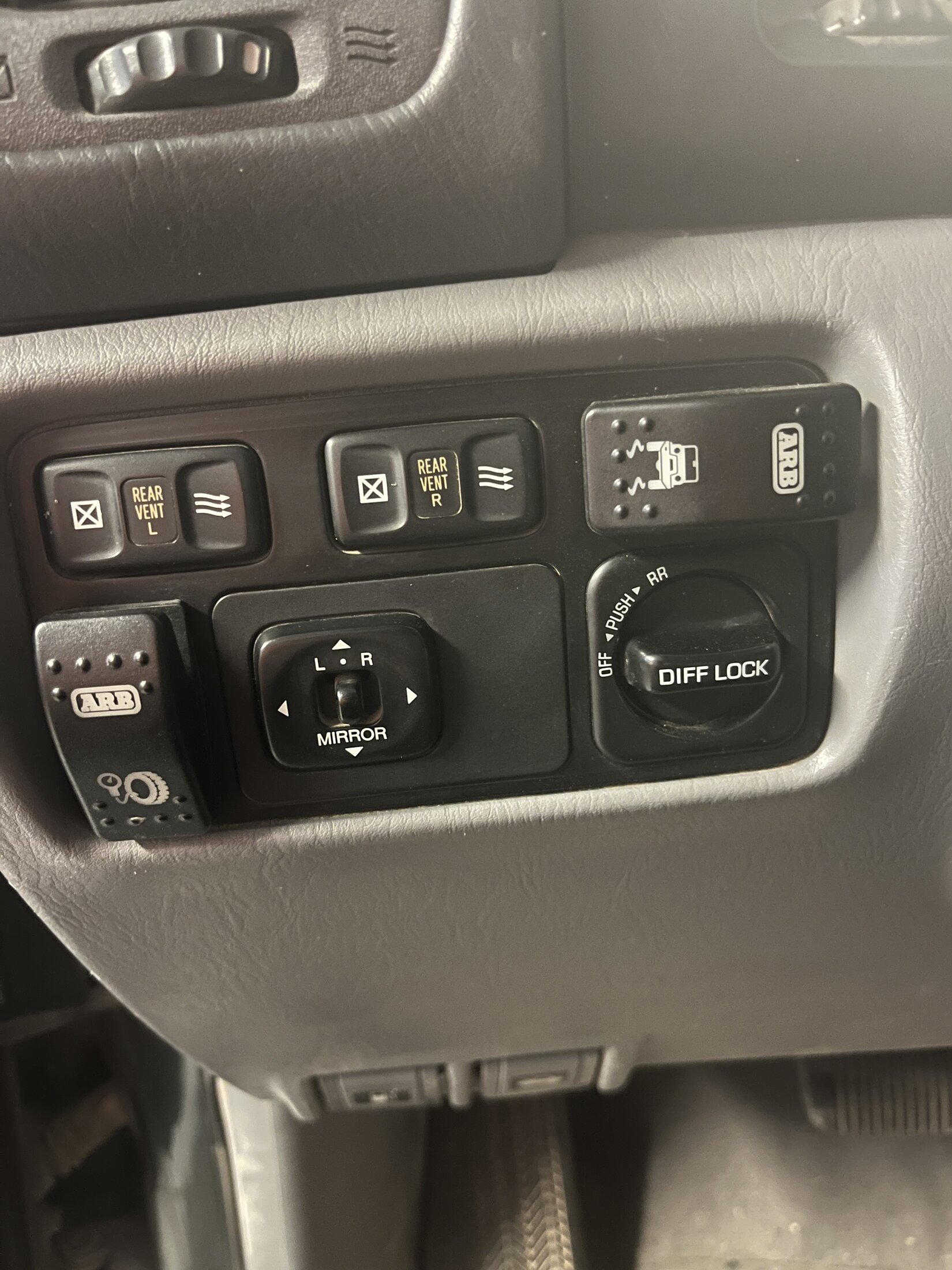

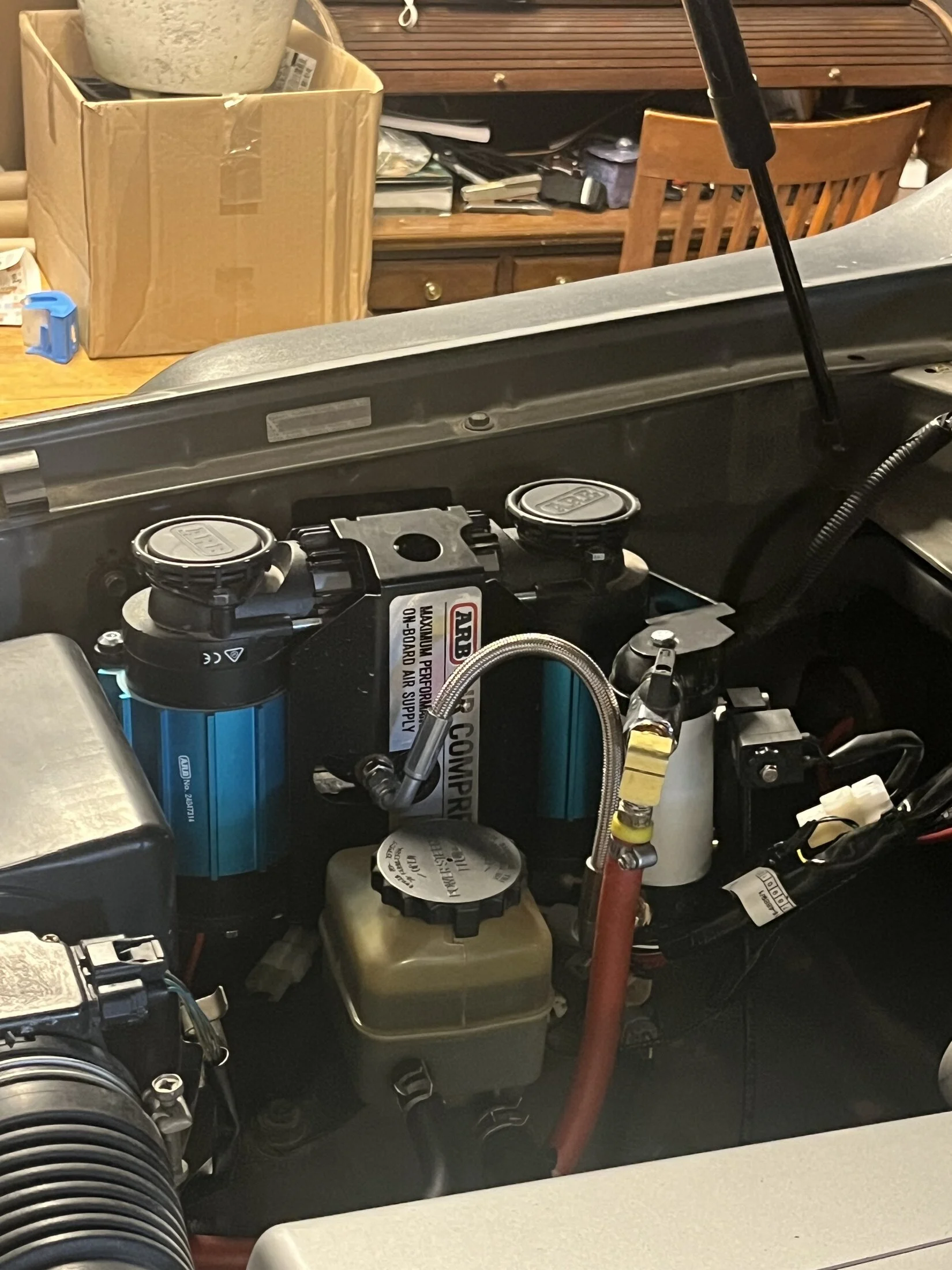

Having a ‘98 that I wheel a lot out in the desert, an exploded front diff would be bad. Just installed a front ARB locker and the dual compressor for airing up as well. Will be testing tomorrow🍺🍺
nice setup, does the air locker reduce the likelihood of exploding a front diff? i guess that would be the case if most front diffs meet their end because of wheelspin
The lockers give more rigidity to the carrier so there is less flex with the ring pinion and spider gears, apparently.
Yes it does, gets rid of the 2 pinion set-up.
