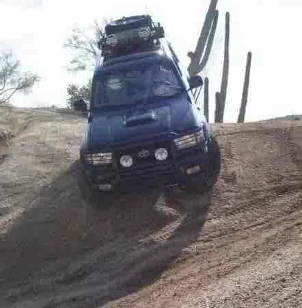

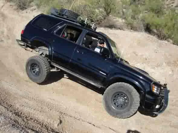

I am finally confident with my set up in the rear of the runner, and did some final testing after modification to the panhard adjustment / length, best shock for application, sway bar extensions, bumpstop location, etc. last weekend. I put the rear to the extent of the Rubicon Express links, and completely cycled my suspension. (as shown more than cycled:eek: )
Now I just need to plan on how to complete my front to match my new extended travel. Any suggestions short of swapping in a solid axle? I currently have Tundra coils, up front (Sonoran Steel Kit) that offer 3"+ above stock.

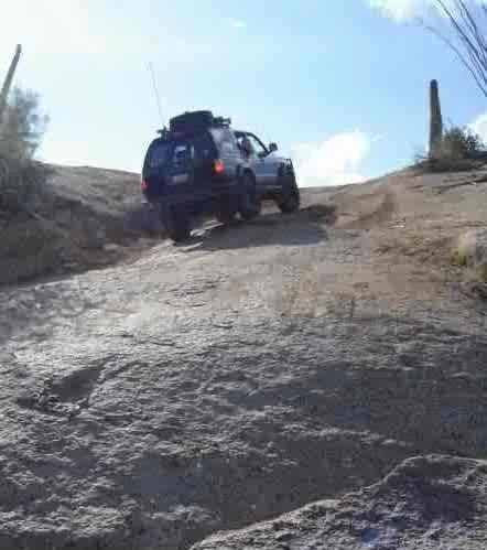

looks good man, where were you??
Thanks man, I was just on the north range of Sycamore Crick, where the crowds are thinner, at the small rockgarden. Not well known as a trail, mostly used by the quads untill it gets to a higher elavation.
