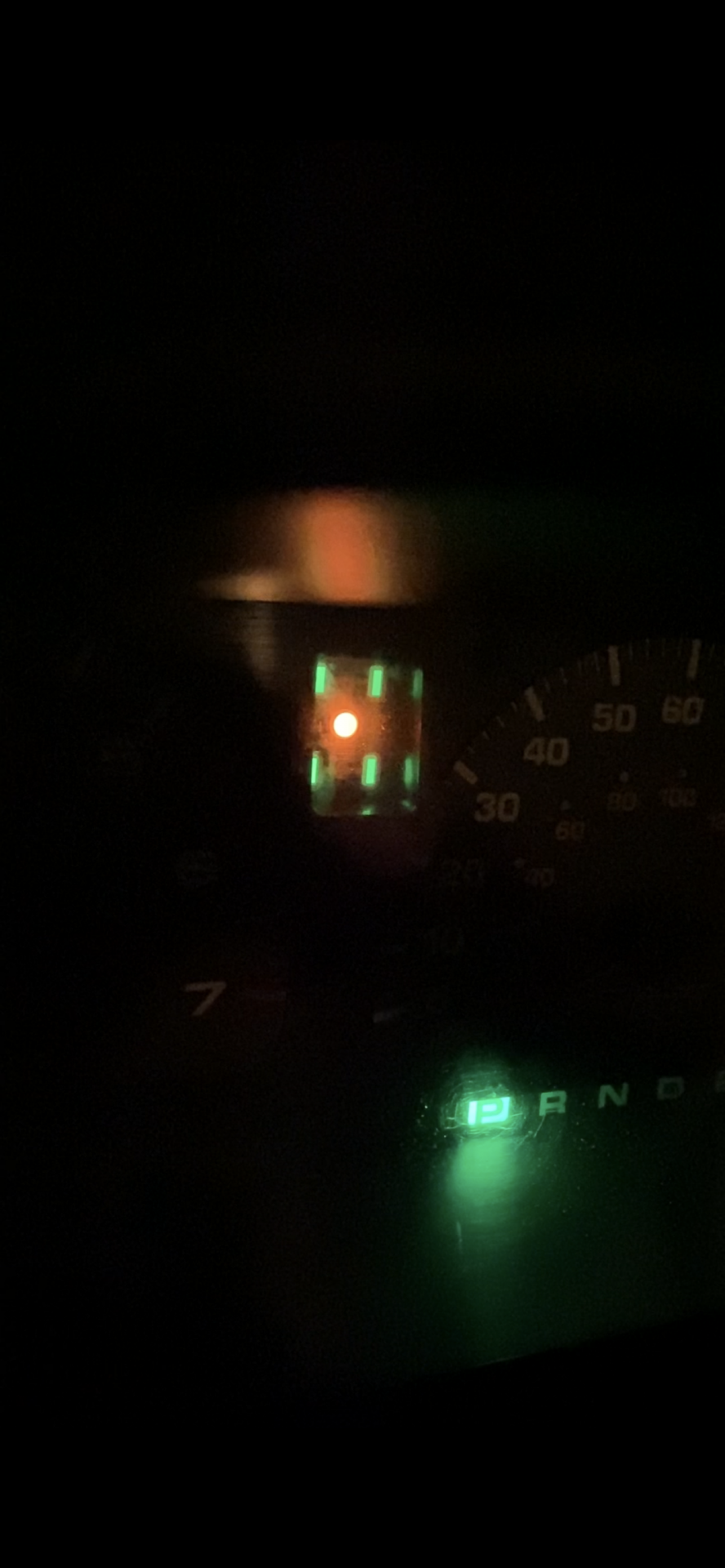

This thread caught my eye because my center diff (01 4Runner) is unlocked and the light is blinking on the dash. It’s my winter truck, stuck in 4 wheel but not locked.
I will see what happens when it snows. I have tossed about 7K into this truck over the past two years ( well worth it) but I am sure it will have to be looked at.
