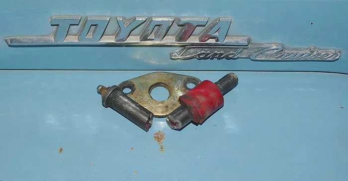

found it broken at Cruise Moab before Friday's dinner, the other half had fallen out :rolleyes:
luckily, Kurt had a used OEM for a spare :clap:
I take it sheared right where the grease comes out on the inside?
What type shackle?
yes
this was on the frame side

It's possible that the theory behind the design is not at fault, but the manufacturer of the pin or shackle has a poor design/tolerances/raw materials.
Could you please tell us which brand of pin and shackle you are using, so we can avoid using them.
A number of folks have had problems, for example, with all kinds of stuff sold by Cool Cruisers, if it was their product--easy enuf to avoid buying.
Hopefully, the concept of lubing the bushings is sound and practical.

my cruiserguru tells me it's the design :meh:
Well are they the type with the channel milled down the entire length? Or the kind with a flat and a hole? or a hole and no flat?
My guess is that those are listed in order of increasing strength. I don't like the channel type at all.
Edit: ah, see pics up now. s***, I have some like that...
I think it is funny you have that part; the other part that 'fell off' has two bolts that are supposed to secure it to the frame.... :lol:
Have you put a wrench on the remaining six spring pin bolts?
the outside plate was still there held by the two bolts, just the part with the grease nipple fell out :hillbilly:
yup :p

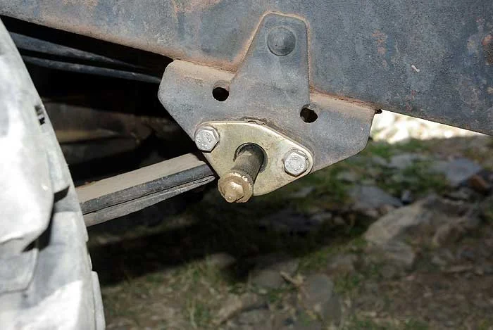

and when one breaks, so goes the other :rolleyes: just this weekend :(
attachment.php
attachment.php
BTW, both were the front pins
after this a piece of the bushing was found on the ground midway up :eek:
attachment.php
I still drove it another 30some miles on washboard dirt (found that the shouldered part of the pin held in the hanger :meh:), and then decided to continue 50some miles on highway :hillbilly:
good thing I had already ordered the new pins from Kurt :bounce: new pin was changed in that very evening :bounce: thanks Tools R Us and ChaseTruck :clap:
the greasable pins were purchased from Specter in early 2005 and broke in 2010 - regularly greased, bushings replaced in 2010 before Cruise Moab - torqued correctly each time
did I mention I am more than done with greasable spring pins :doh: :mad: design FAIL proven twice :bang:
Almost look like machined & plated cast parts versus machined forged. Anyway of knowing whether this product is forged vs. cast?
