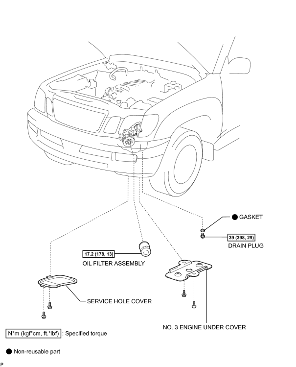

Last two weeks, I have been trying to change oil in my Mom's 2007 LX 470. First week couldn't find the drain plug or to access the oil filter. Last week found the plate to get the oil filter out. I still can't find the oil drain plug.......:mad:
Can a good "soul" can upload a picture where I can find this.
Thank you.

Here's an overview of where the filter and drain plug are located:
Drain plug cover:
Drain plug:
Oil filter cover:
Oil filter:
Hope you find the info helpful.
:cheers:
Yes, very helpful. I saw that drain plug cover and thought to myself, it can't be that far back.
Thank you the pictures.:clap:
