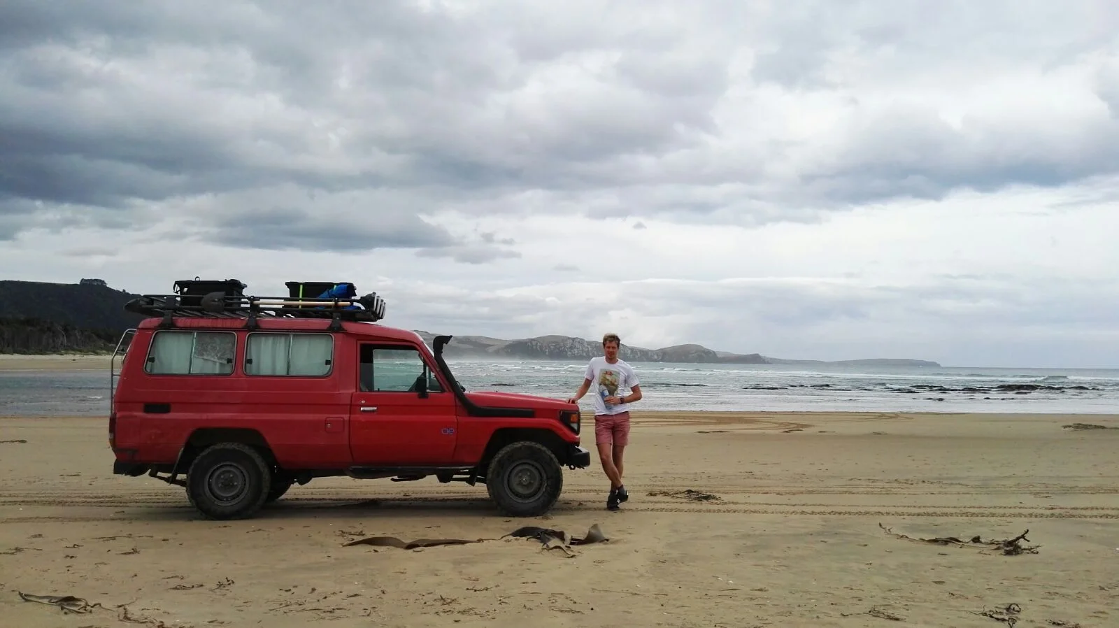

i have a 2000 HZJ78 troop carrier as below (i live in new zealand), with about 260kms, has a rough life but its a beast:
