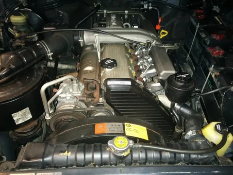

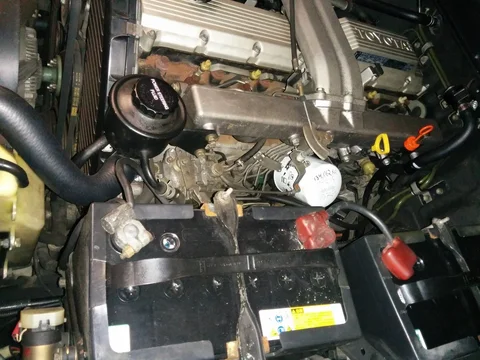

Hi All!
I just purchased a 1990 HZJ73. It has 135K kms (about 84K miles). The importer changed all the fluids but they used NAPA Gold oil filter, NAPA air filter, and the radiator filter is greenish. Also, the oil looks really dark and thick. They changed the front & rear diff. fluids to 75/90 synthetic.
Other things they did:
Transmission and transfer case fluid changed
Replaced thermostat
New heater and radiator hoses
charged a/c
greased drivelines, ujoints, steering and knuckles
Replaced timing belt, pulley tensioner, and water pump
Replaced Radiator
I'm not familiar with the diesel engine. Should I flush and put Toyota red in? Should I change the oil? If so what should I be using? I use 15W50 for my FJ80 and I'm in Phoenix, AZ. Also should I be changing the filters to OEMs (I use them for the FJ80). They also put NAPA fuel filter in.
Engines is really loud (I know diesels are supposed to be) and there is some exhaust smoke when first started. Is this something I should be concerned about?
The PO also put in own aftermarket steering wheel. Any suggestions on how to get an original?
Thanks for in advance for any suggestions.

Indirect diesel injection causes oil to soot up a bit quicker, so they are normally changed every 5-6000klms. 15-50 would be ideal in Arizona temps, about the same as Western Australia.
I would leave the green coolant in for a year then change it to red. Mine has had green coolant for years from the previous owners and the water pump is just getting to the point where it needs to be changed at 250000klms(most 1HZ pumps go about then)
Unfortunately for budding home mechanics ,once a 1HZ is set up properly ,there is not much to do until the next service.
A 1/2 second flash of whitish smoke is normal on start up.
I have never used OEM filters on any Toyota engine, lots of good aftermarket types out there
I couldn't a see fuel filter on your list, that should be changed.
At 135000klms ,it is unlikely the injectors have ever been done. It is a 100000klms service job.
I'm a bit surprised when you say its loud. IDI engines are fairly quiet engines as far as diesels go. Is it the muffler or an exhaust leak?
You will enjoy it more with the proper wheel, I dont know why people use those horrible aftermarket types.
Thanks for the tips Rosco. Appreciate it. Yes the importer replaced the fuel filter too (after market). I will look into the injectors. As far as the noise goes, its loud when I hit the accelerator, in low gear and idling, but sound goes away when I'm at cruising speed. Almost like a knocking sound within the rest of the sounds. I'll see if I can record at and attach. The sound comes from engine not in the back but I'll check muffler/exhaust.
Yes the smoke is about what you mentioned at start up.
The importer changed the oil but I'm assuming its mineral, and its dark and thick - is this normal for diesel? I'm use to synthetic in my FJ80 which of course is light in color.

T belt and water pump is a simple replacement items, idler pully is usually in the kit. Con rod bearings should be done as per always.
Injectors with that many miles is not even a concern and as for the noisy engine, the 1hz is a very refined motor that is generally very quiet. I would check for exhaust leak, although some peoples idea of noisy compared to another one is far different.
Definitely one of my favourite engines and that model year and up they made some very nice interior improvements mostly upholstery.
