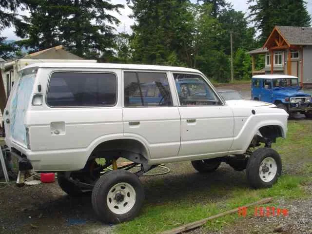

the soa makes those tires look tiny! are those lifted springs over? I bet some serious size can fit on there.
is that the 1hz in the pic? looks good.

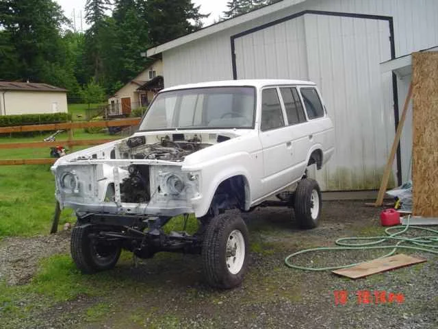

Spring over on OMEs, once the bull bar and rear bumper, long range tank that you can kinda see in the picture are all installed it should come down a little.
Yes the engine is a very healthy 1HZ, should rock a turbo and intercooler.
Tom has 37s on beadlockers, picture above.

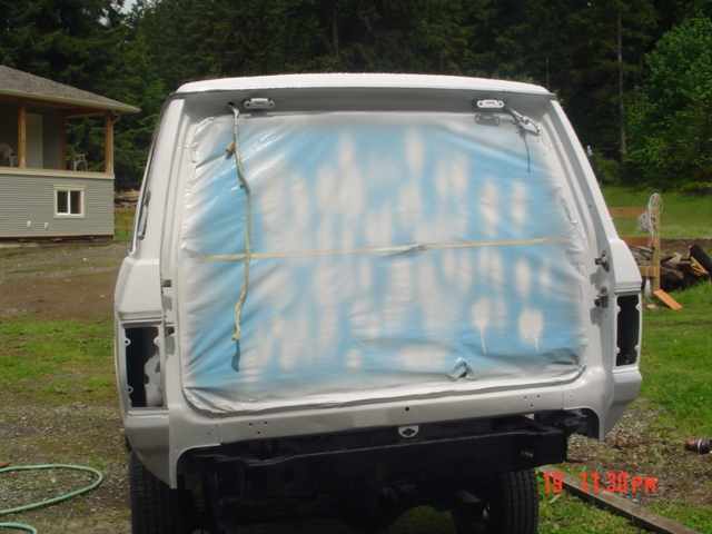

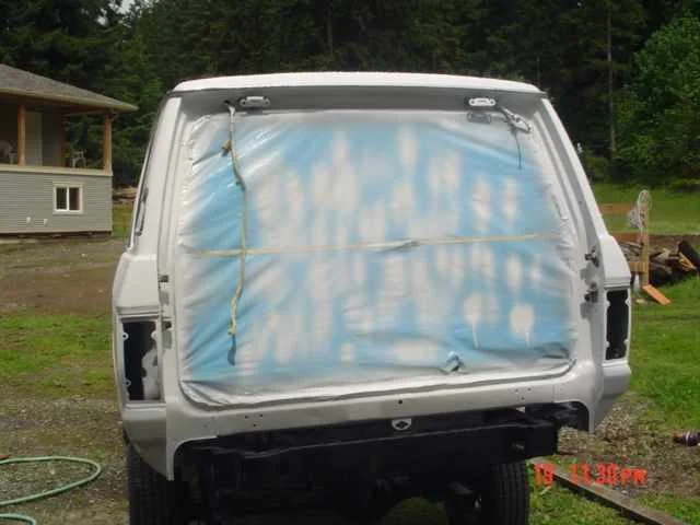

We recieved the doors, pulled out the electrics and panels, ready for all the inners too be sprayed white. Nearly rust free clip and fenders also ready for inner spray.

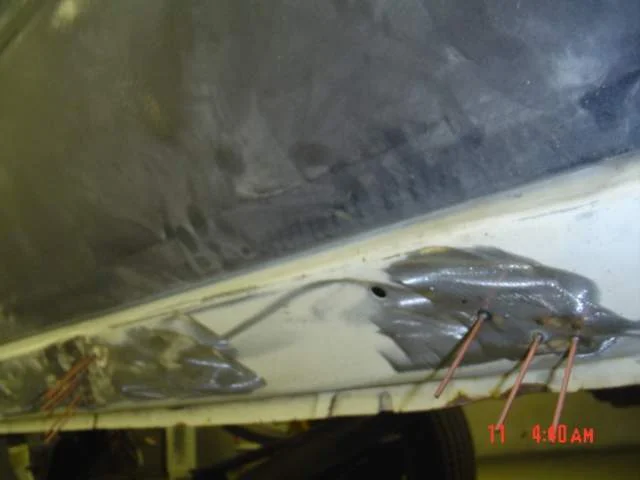

The previous pictue of the drain hole in the floor was actually closed over from a impact which moved the door pillar up and in a couple of inches.
