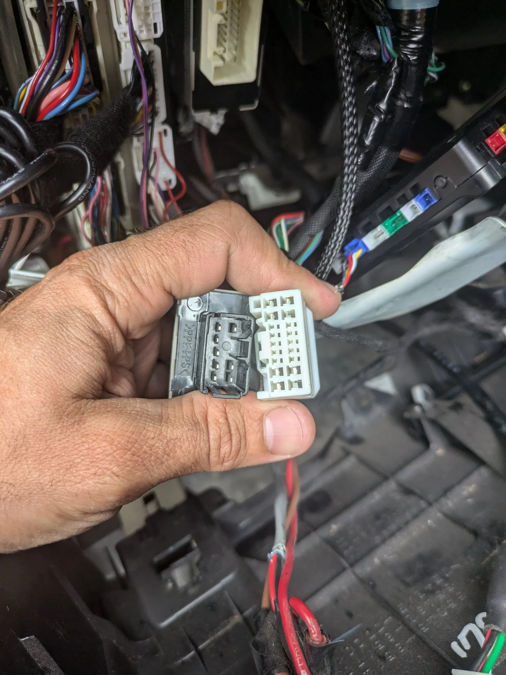

Purchased this truck with LEDs in it and the left turning signals are hyper flashing. Talked to a guy who told me to order this part with 8 pins(left) but the original flasher module plug(right) has 18 pins.

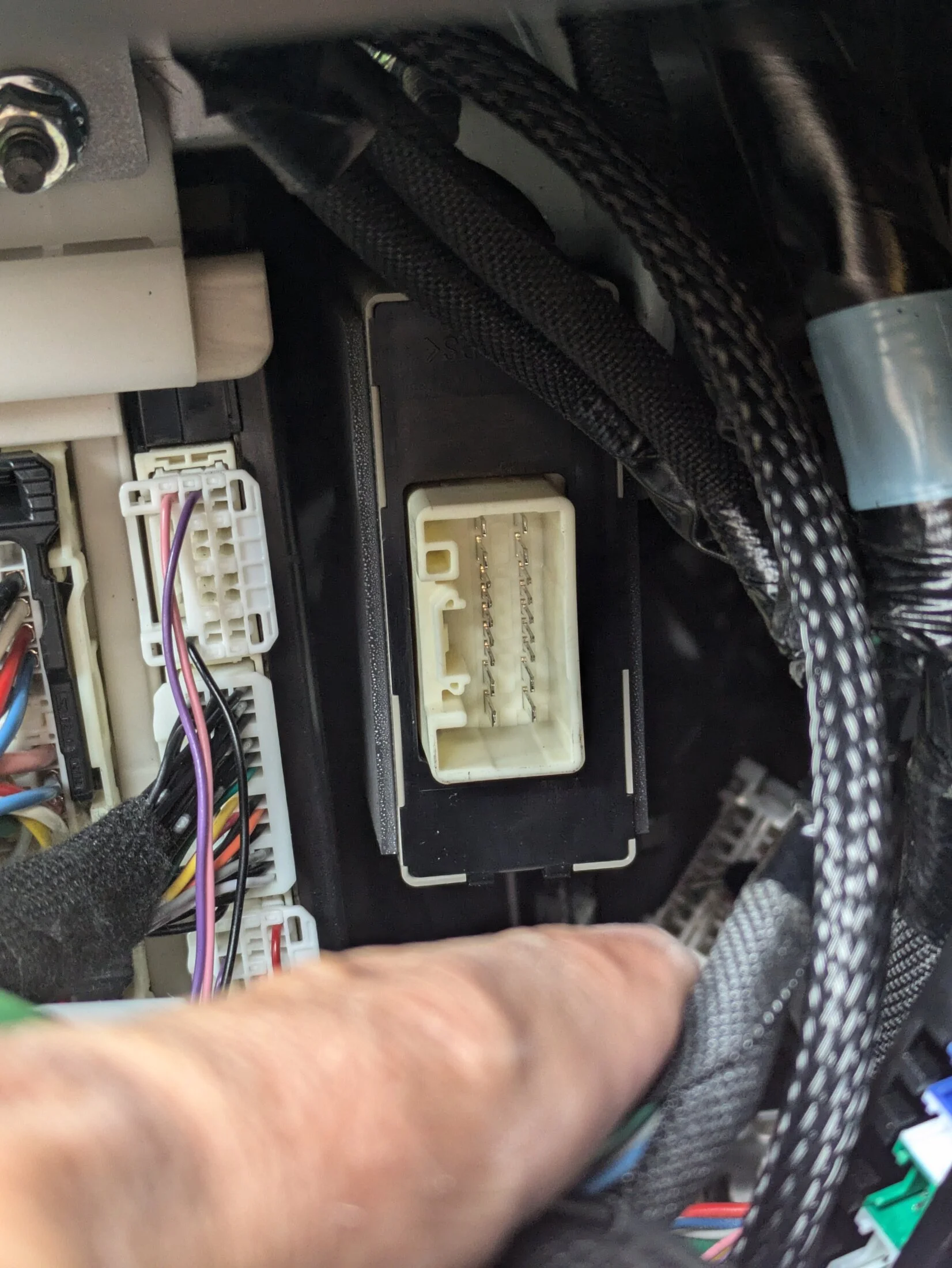

I've confirmed that the module that the 18pin cable plugs into is what's flashing..
I have been reading for over an hour and I'm just as lost as ever. Help.

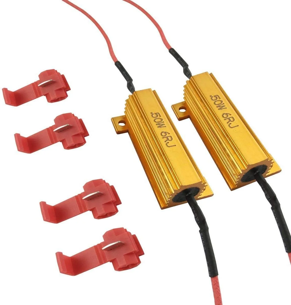

After installing my Shrockworks front bumper I had LED lights for turn signals. Got the hyper flash as well
Research led me to installing these resistors and that fixed the issue
When I had my 3rd gen it had LED bulbs in the signals too, I installed these and resistors did the trick super easy install too. I found mine at Autozone.
