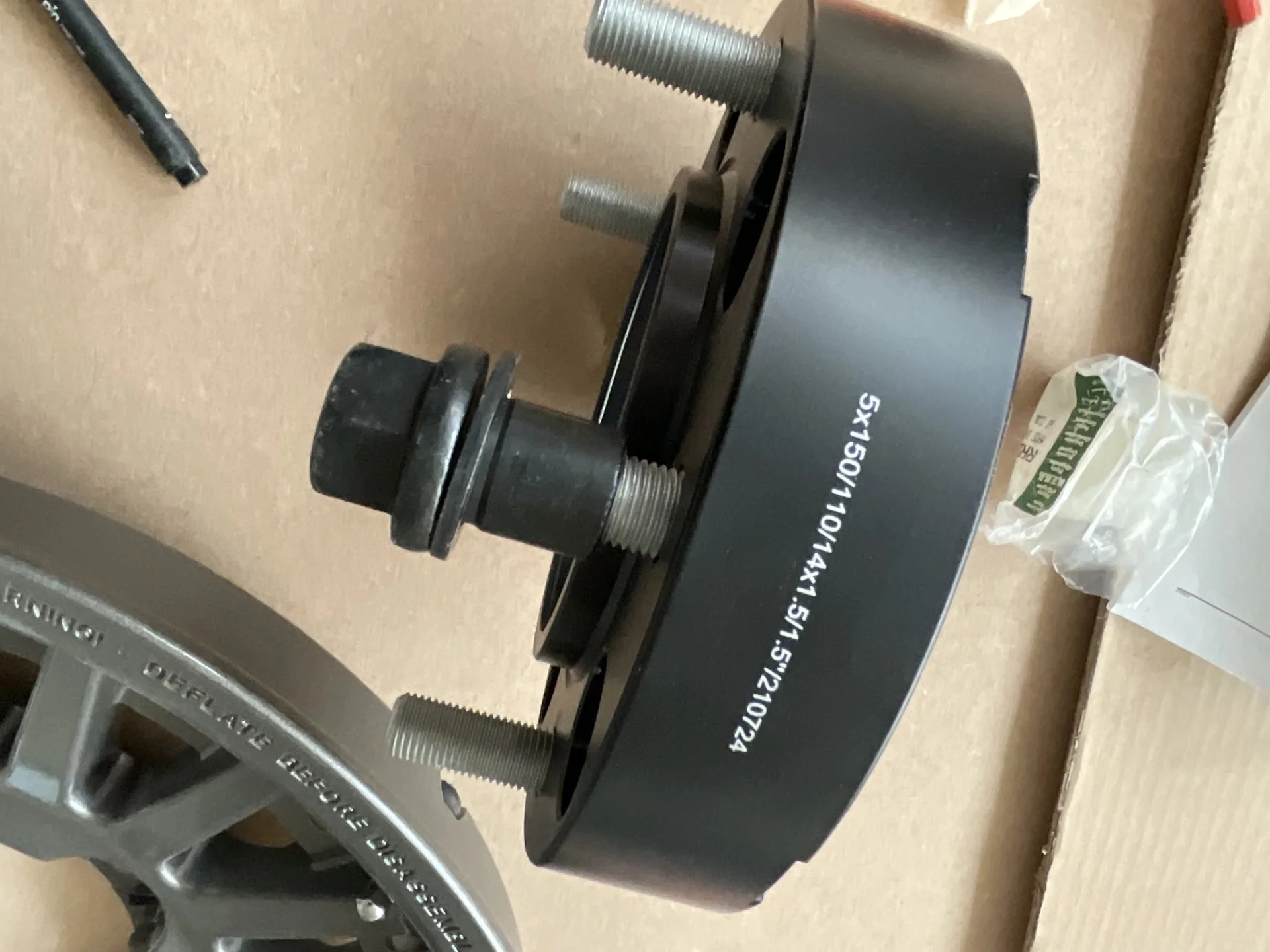

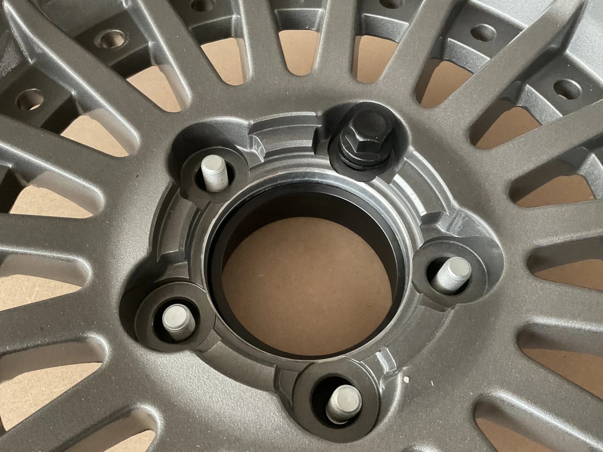

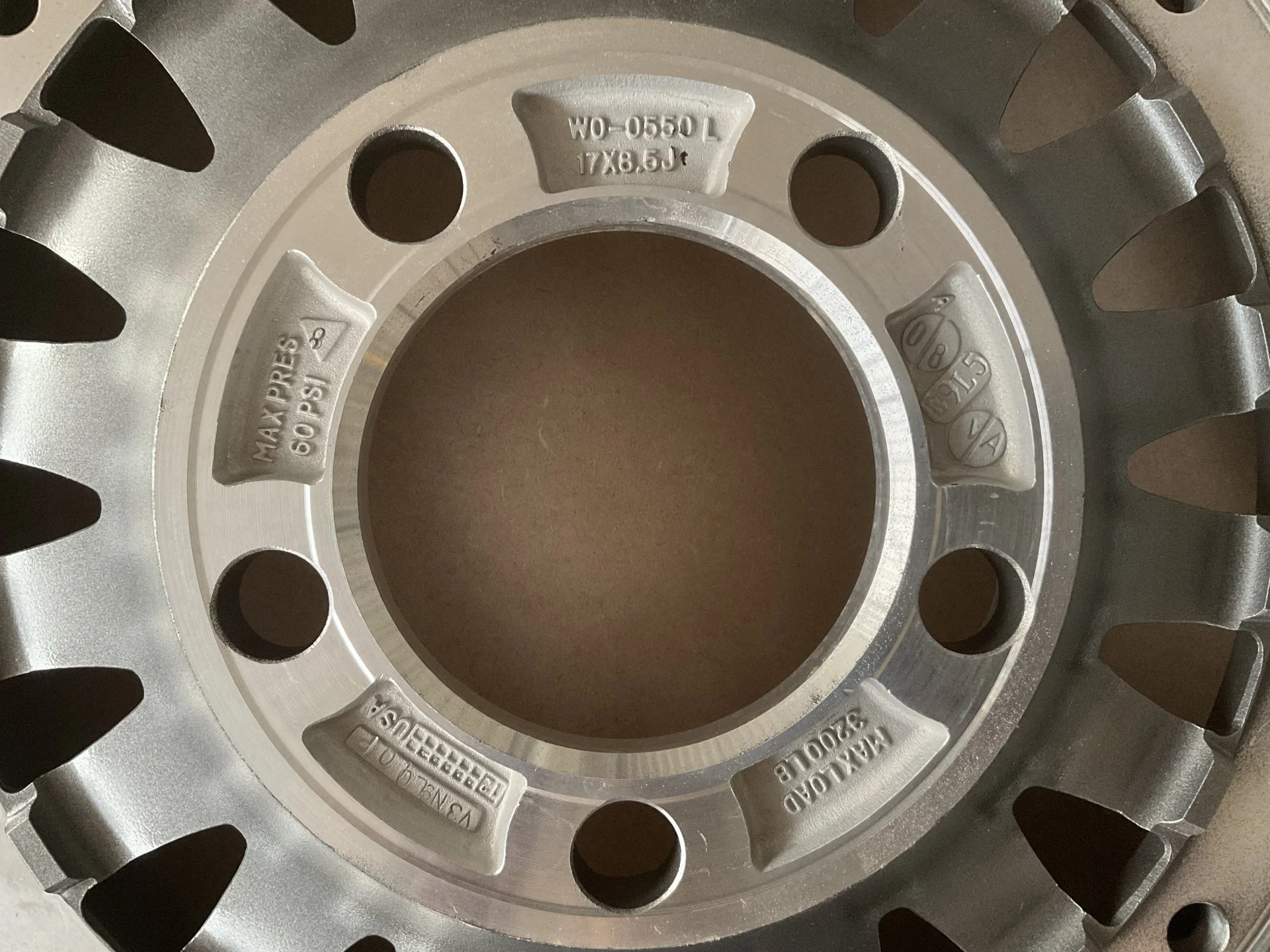

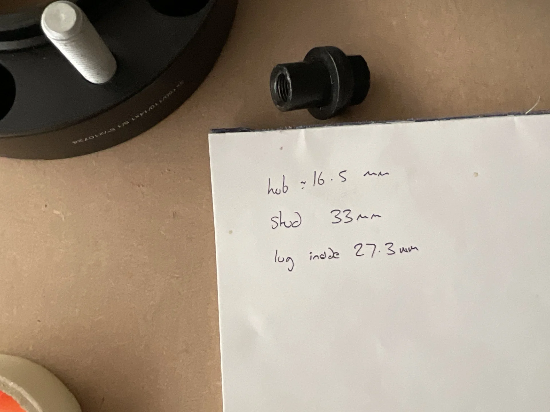

I have a set of Hutchinson Rock Monster wheels, and a set of Superior wheel spacers to go onto my 78. (spacers are required as the new wheel is 8.5” over the OE 6” but the same offset) I can’t find any Lug nuts that fit correctly. I can find lug nuts that are the correct M14 x 1.5 and correct bore for the wheel but they are too long for the wheel flange (protrude through so the wheel won’t tighten) and too short for the stud on the spacer.
Can anyone suggest a supplier of tube style nuts I could try please.
