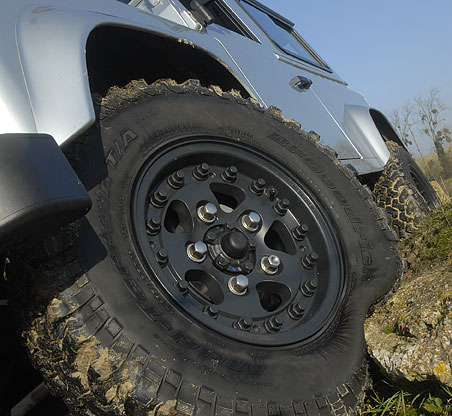

Hello folks. We would like to have a 5 spoke style wheel built for the 5 on 150 pattern. It would be 17 x 8.5 or 9" in size, probably forged, and of course dual bead lock. In order to get this done, we need to have at least 5 people to meet the minimum order. They will be more expensive than the regular cast Rock Monster Wheels. The style will be along the lines of this 16" wheel that Hutchinson produces for Land Rovers.

No, this won't be a 6 spoke design, more like the above pictured wheel. A 5 lug wheel = a 5 spoke design for good structure and balance.
