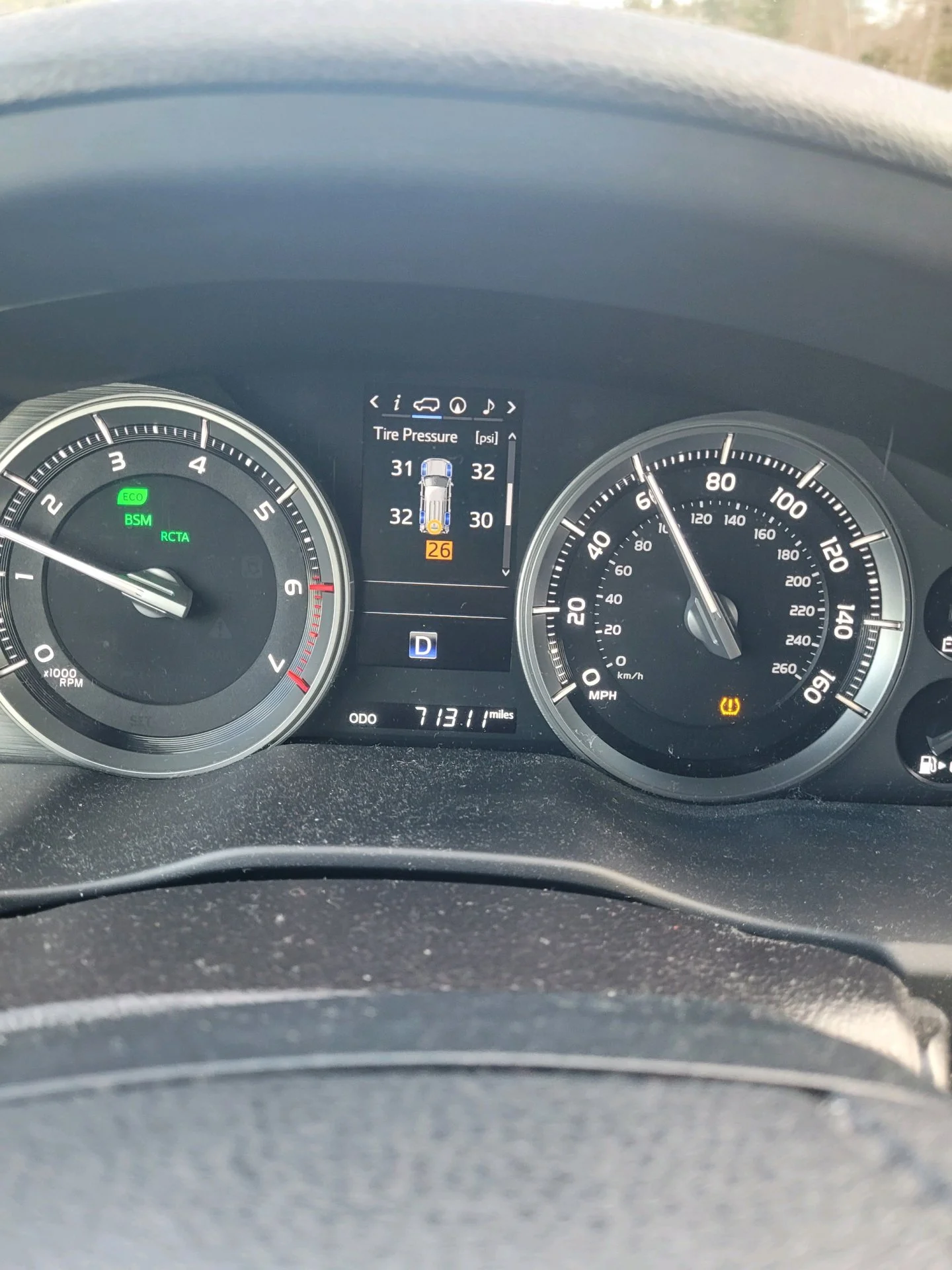

My wife texted today with the attached photo showing low pressure in her spare tire. We’re having a cold snap down here in Georgia, so I just chalked it up to the chilly weather.

@Blackford Oakes Drop the spare to top it up.. I like keeping it a bit above the rated pressure so it at least isn't too low by the time I need to use it.
