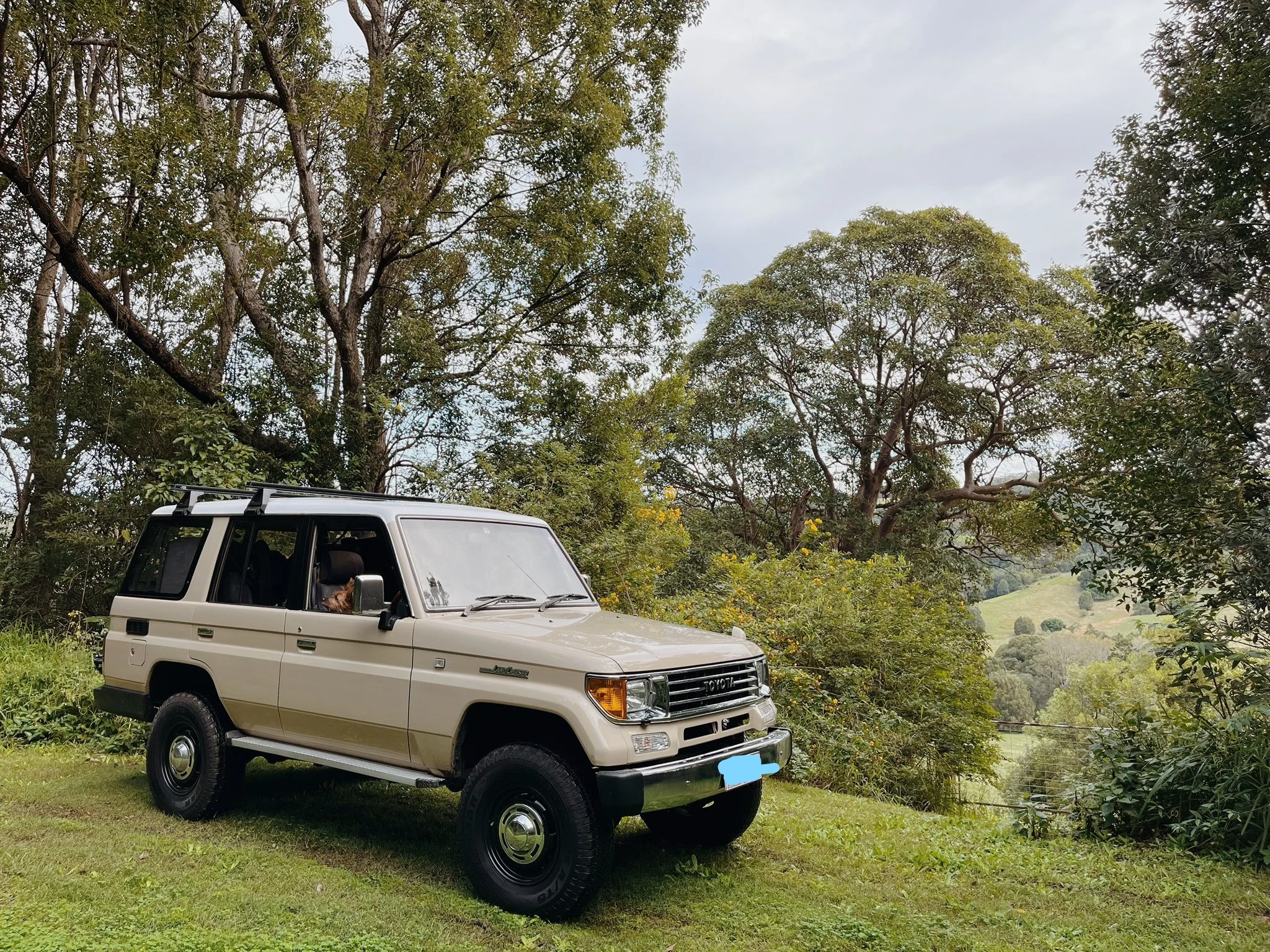

Hi guys,
Been reading on this forum for about two years and I finally got my KZJ78! Looking forward to getting involved in the community here, it's an awesome resource, so hoping to add to that.
1994 KZJ78G (non wide version from factory)
160xxx kms
OG Colour Silver / Resprayed in what I think is Sandy Taupe but I haven't been able to park next to a new 70 yet to compare
It's a real gem, took almost a year to find it in the auctions, almost gave up!

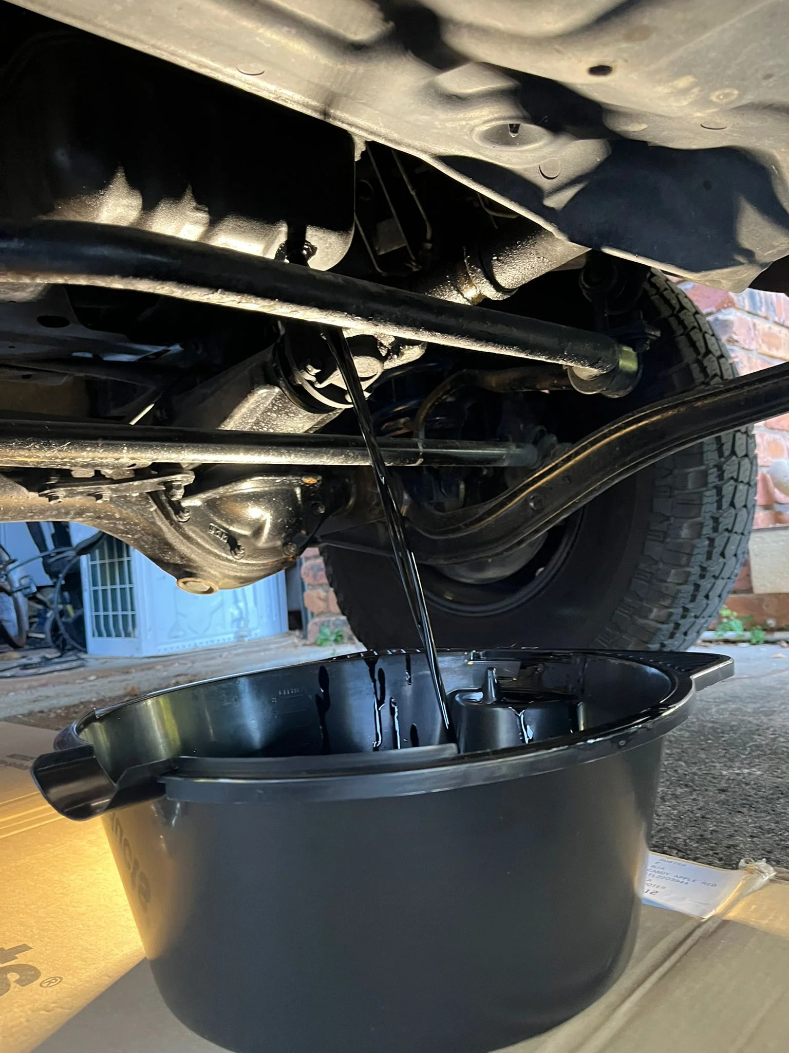

Starting on the maintenance now and will be doing new exhaust and intercooler for it.
