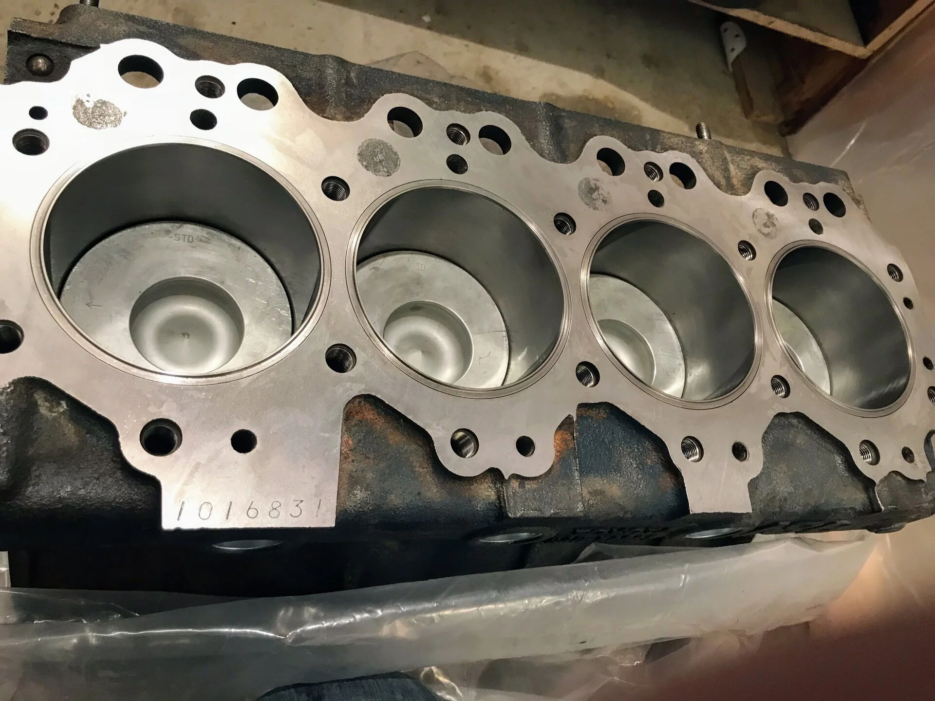

The B series should have it stamped on front side right under intake manifold.
