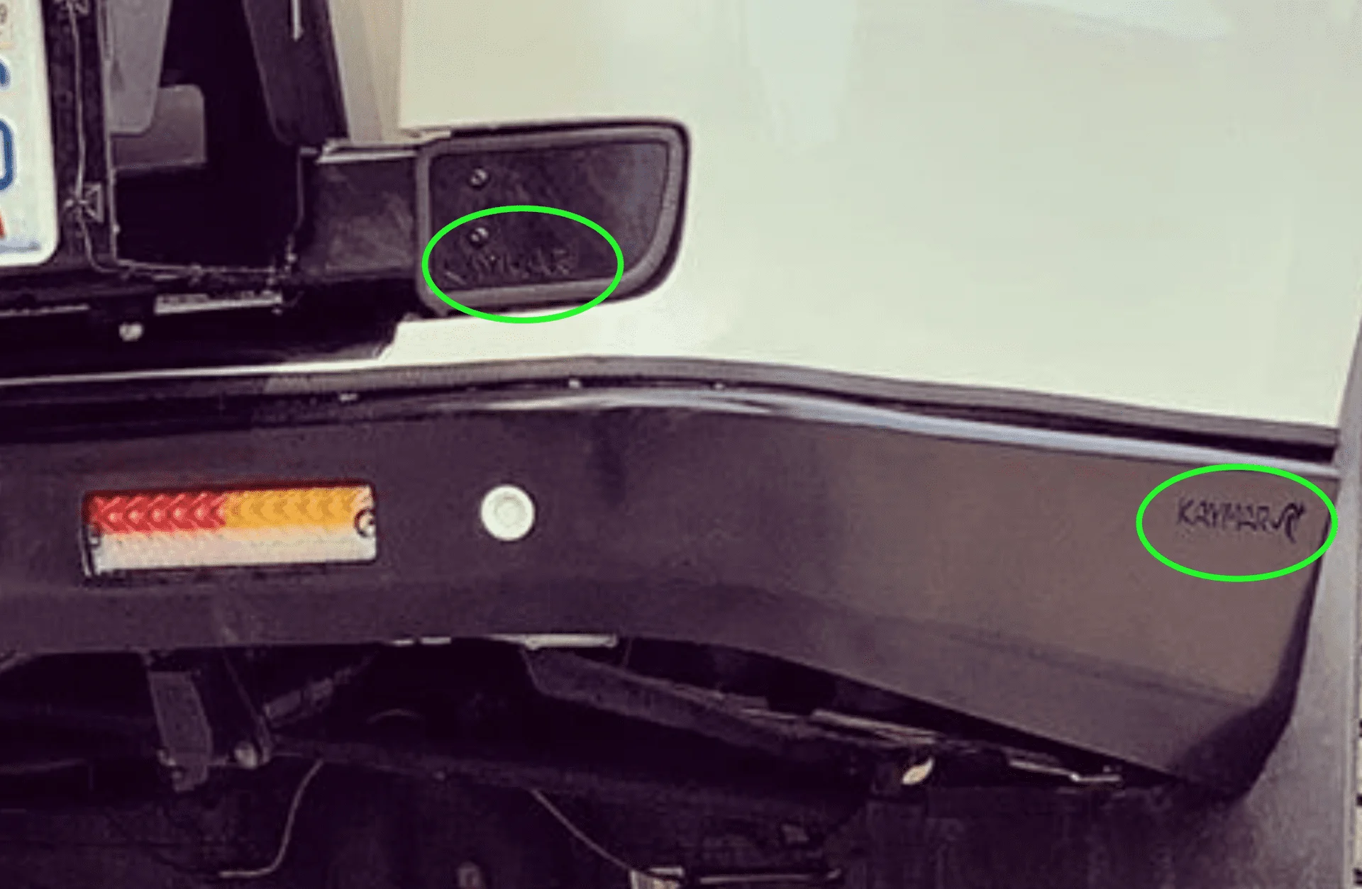

I did not want to step on anyone's rear bumper thread so here it goes...
I was minding my own business looking at Bud Built's website at STUFF to spend money$$$ on...
So I went to his home page and saw a Rear Bumper on a 200...
Whazzz up wit dat, I axe u???
Click it...Zoom it...
OK OK... Here ya go: ;)
Thanks... Bummer, I was hoping BB had a new project on the horizon...
Jeff
Jeff
Not a bummer in my book! Kaymar is FINALLY an available option in the US!
But ya... BB usually has a number of interesting projects going on. Always curious...
I guess I'm slow.... is BB the Kaymar dealer and there's just nothing about it on his website or is someone else the Kaymar dealer?
