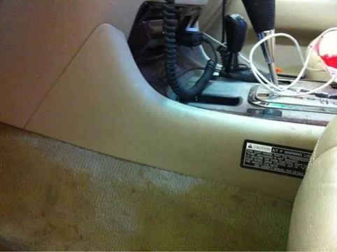

Stuck in a shop with no computer. Search fu is not strong. How do I remove this without breaking?
I think you have to pull off the top area around shifter first. That's from memory, though...
Yep. Pull trim ring, pull top, console comes out after screws in side and bottom of box are out. IIRC there may be some hidden back behind the rear cup holder too, but it's been a while.
Thanks for tr replies guys!
I think there is a face mounted phillips screw that is accessed when the seat is removed toward the rear of the pannel, but it's been a while and my manual is in storage.
