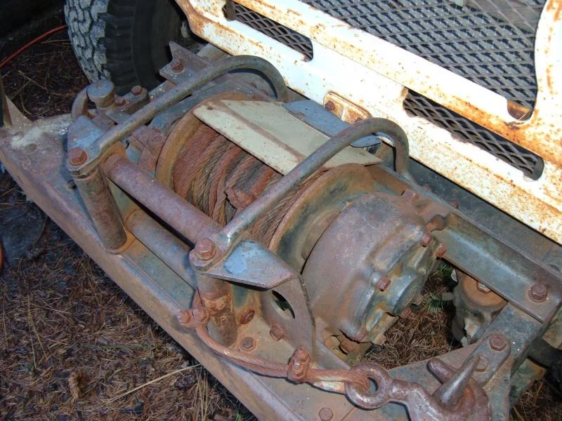

usually the only way you get the cable jumping over the drum is from winching on an angle and the cable bunches up on the side and dosent layer evenly accross the drum or if your using a steel cable and you have spooled too much cable off and started winching without any tension on the cable and its jumped off the drum because of the coil in the cable?
Had the same thing happen to mine. Made this plate which has a spring loaded door hinge that keeps pressure so you don't get a loop off the side.
