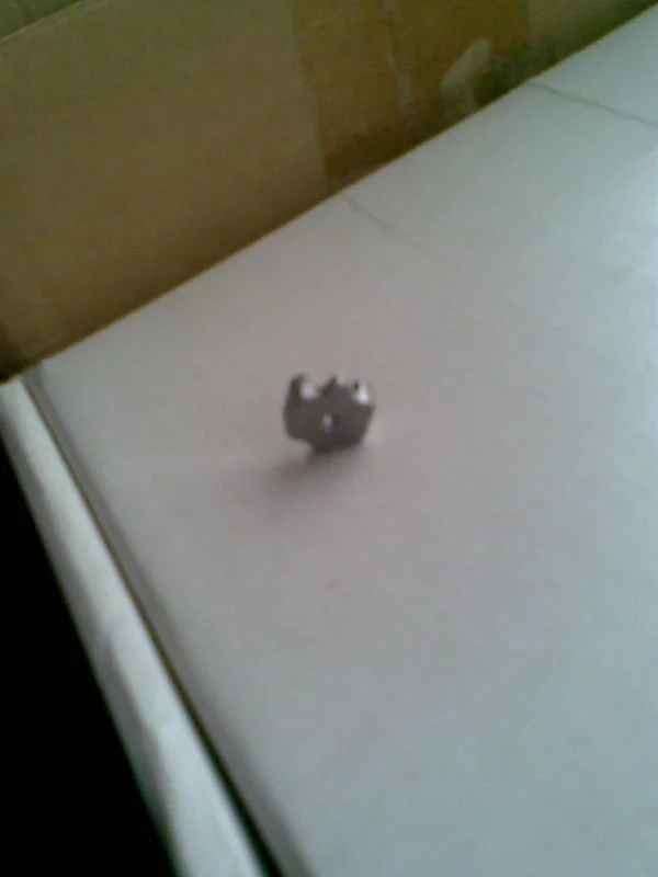

I have similar (might even say it is the same: MM1200+Saginaw Pseries pump).
So far all standard but curently I am modufying the MM internals to get some 25..30% (expected) better line speed.
I have drilled the pump output port from 3,6mm to 4,0mm and at the same time modified the simple OCV setup between the valve block and the engine block (there is a metal washer and flow control disk) in such a way as to make the forward flow significantly easier and with minimum flow change towards the rear: I drilled the central hole from 1,5mm to 2.0mm and modified the shape of the outer hexagon by removing some metal making sure that the contact surfaces do remain untouched.
Will report results as soon as we will fix the pump housing where the top connector (from the tank) got broken out possibly due to too strong hydroulic line type used there by us.
sorry for the picture quality but my phone is not used for naking makro pictures ;)
