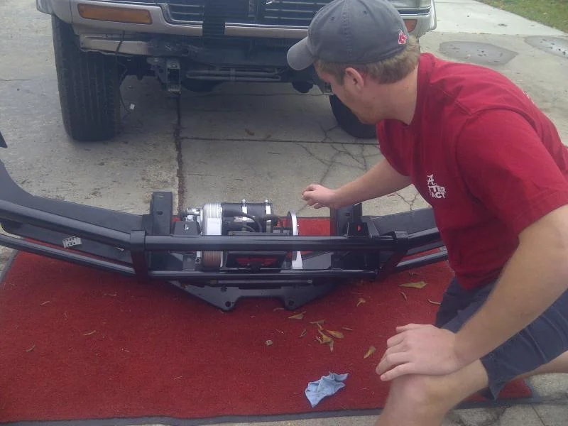

Here are the pictures of my measurements 1997 Lexus. I lifted the bumper and winch alone, as I'm mobile. I'd recommend getting a friend to help.

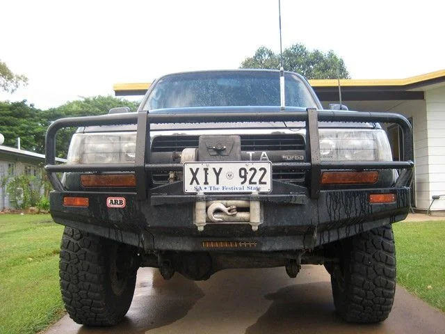

The Rig
The ARB
Trying to get the Winch Mounted in the ARB for test measuring
The Winch Lined up and mounted - bottom two holes. NOTE: The winch is square with the ARB.

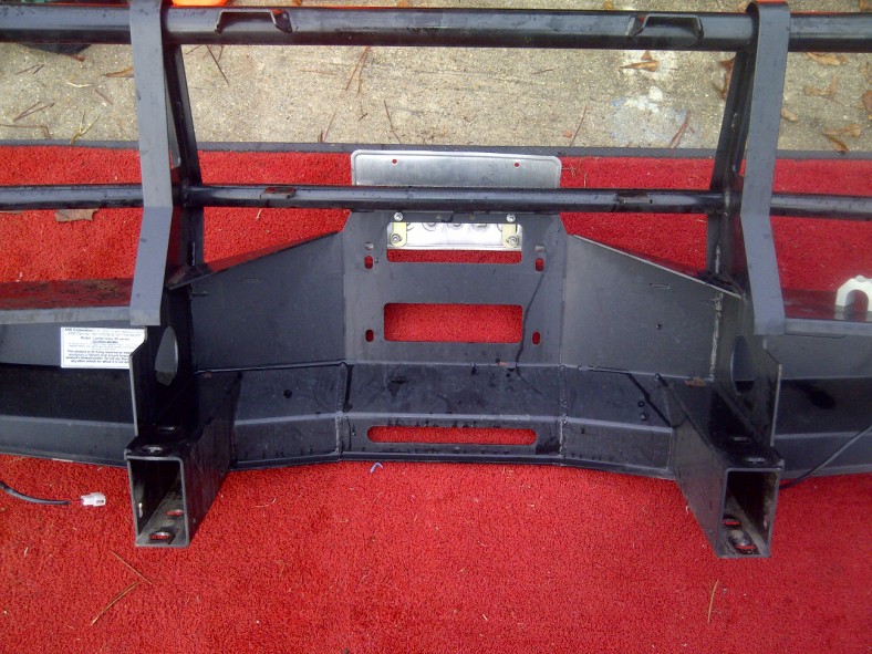

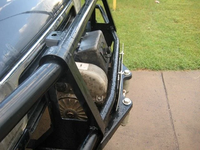

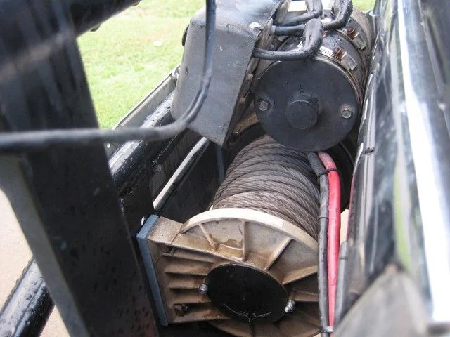

I bent up a new center bar and trimmed the bumper. I used 3/8 (10mm) flat bar for spacers.
https://forum.ih8mud.com/80-series-tech/156746-warn-8274-stuffed-arb-deluxe-bar-pics.html
Same here. I bent up a new cross bar and added some flanges so that it's removable. I can pull the winch out as a complete unit once the new cross bar is removed. I had to trim a little on the pass side to allow for enough room for the ratchet wheel and gear case.
The winch works great! It's enough for an 80.

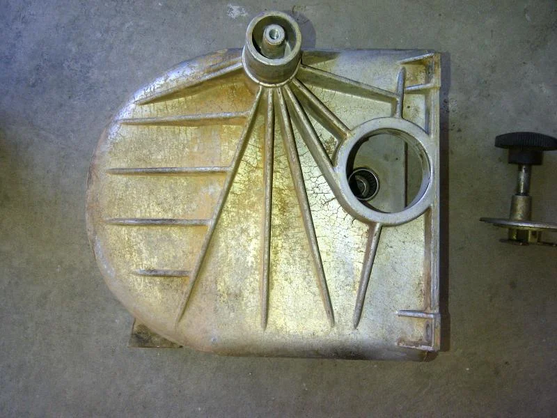

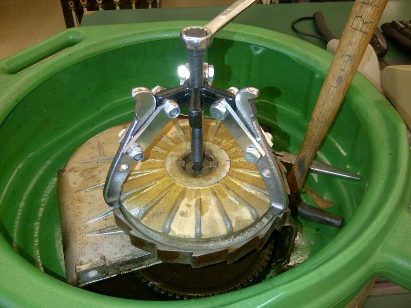

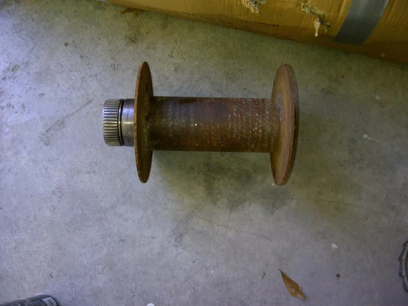

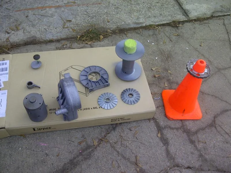

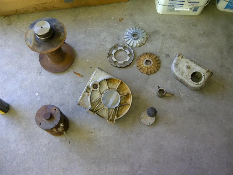

Forgot, but the clutch assembly was a PITA to get off. 5 days in pb blaster and a lot of luck for sure. Took it to O'Rieleys auto parts and they let me work on it on their bench for about an hour. Let me use the tools free. Good southern folk down here in Biloxi MS.
This is how I got it off. Crank the puller as much as I could, then tap the center pin. It was loud when it broke free. And I had to do this 3 times before it cranked off by hand. I was really fearful that the top plate was going to break. yes that much pressure was on it.

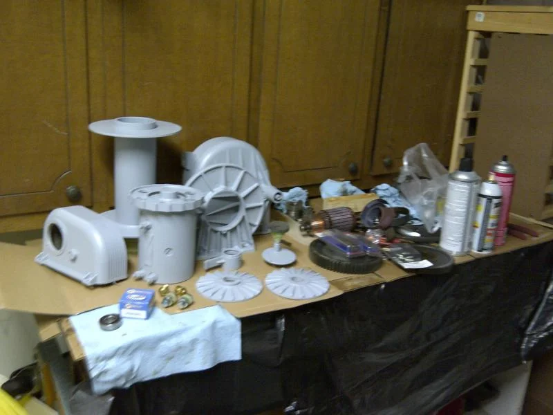

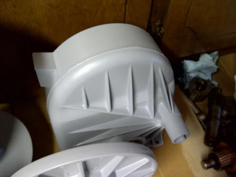

Some blasted pictures and some in primer. Tomorrow, another coat of primer and paint, then reassembly... then into the wagon.

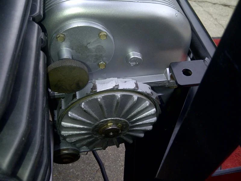

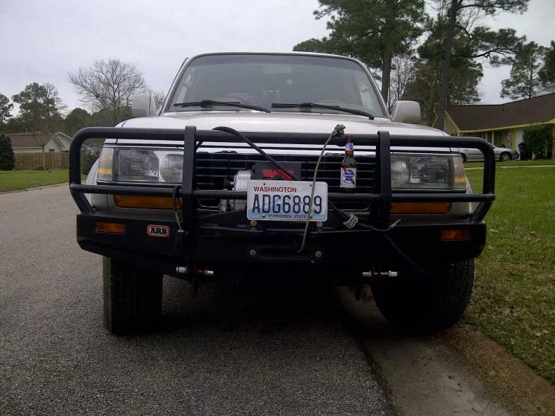

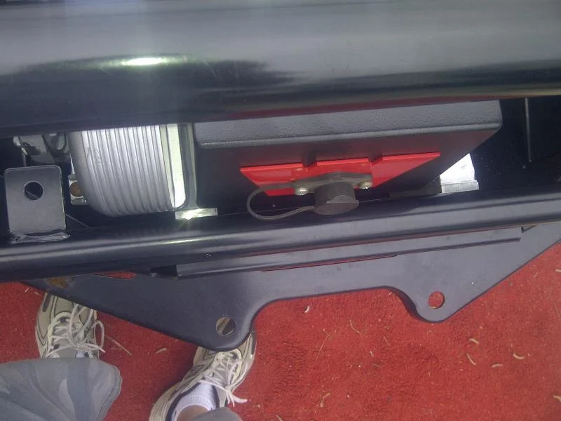

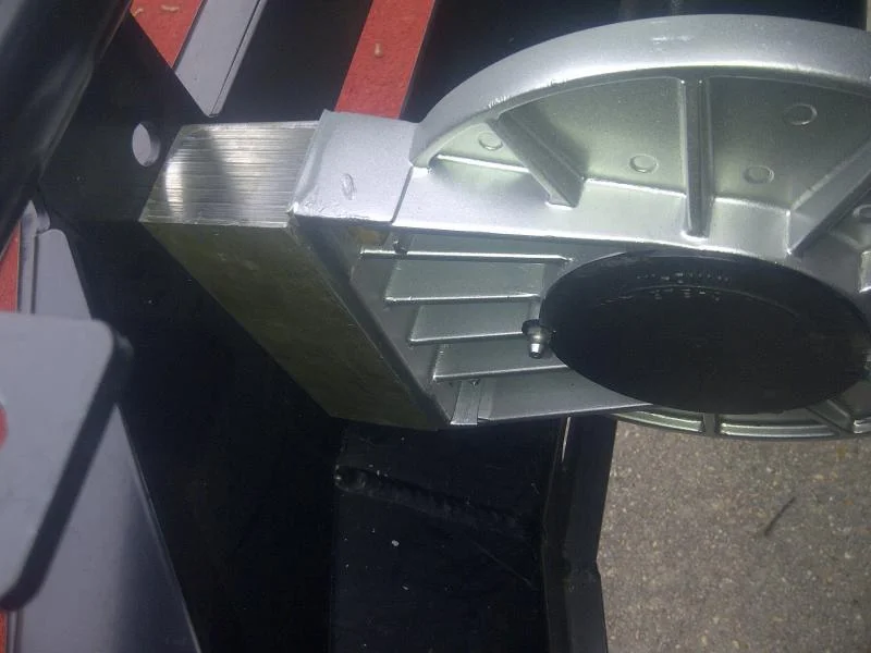

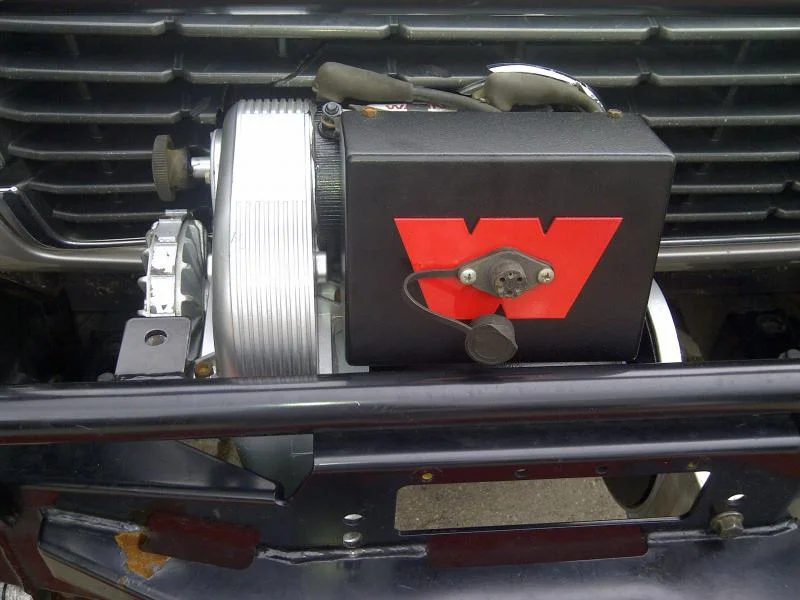

Been a while since i posted. Finally rebuilt it in my spare time. I ordered up some 2" x 6" x 1.5" Aluminum (in a 3.5x7x2 block) and had it machined locally to my specs. These are the spacers. I have one aluminum block left if anyone wants it. $20 plus the ride.. if you want me to have it machined, $60 plus the ride.
I picked up some 4" bolts (will return my 3" ones) at ace. I should have taken a picture of the spacers but they are just aluminum blocks with 5/8 holes drilled in them.
Slapped it together quick. trimmed the grill a little more, but it fits perfect and I like it recessed into the grill.
that last picture only had 2 bolts in it till I got the longer bolts at ACE.
The second picture here is before trimming the gril, had to cut 2 slats out.
Winch still works, truck still goes. Forgot about this thread or its location... to the top
