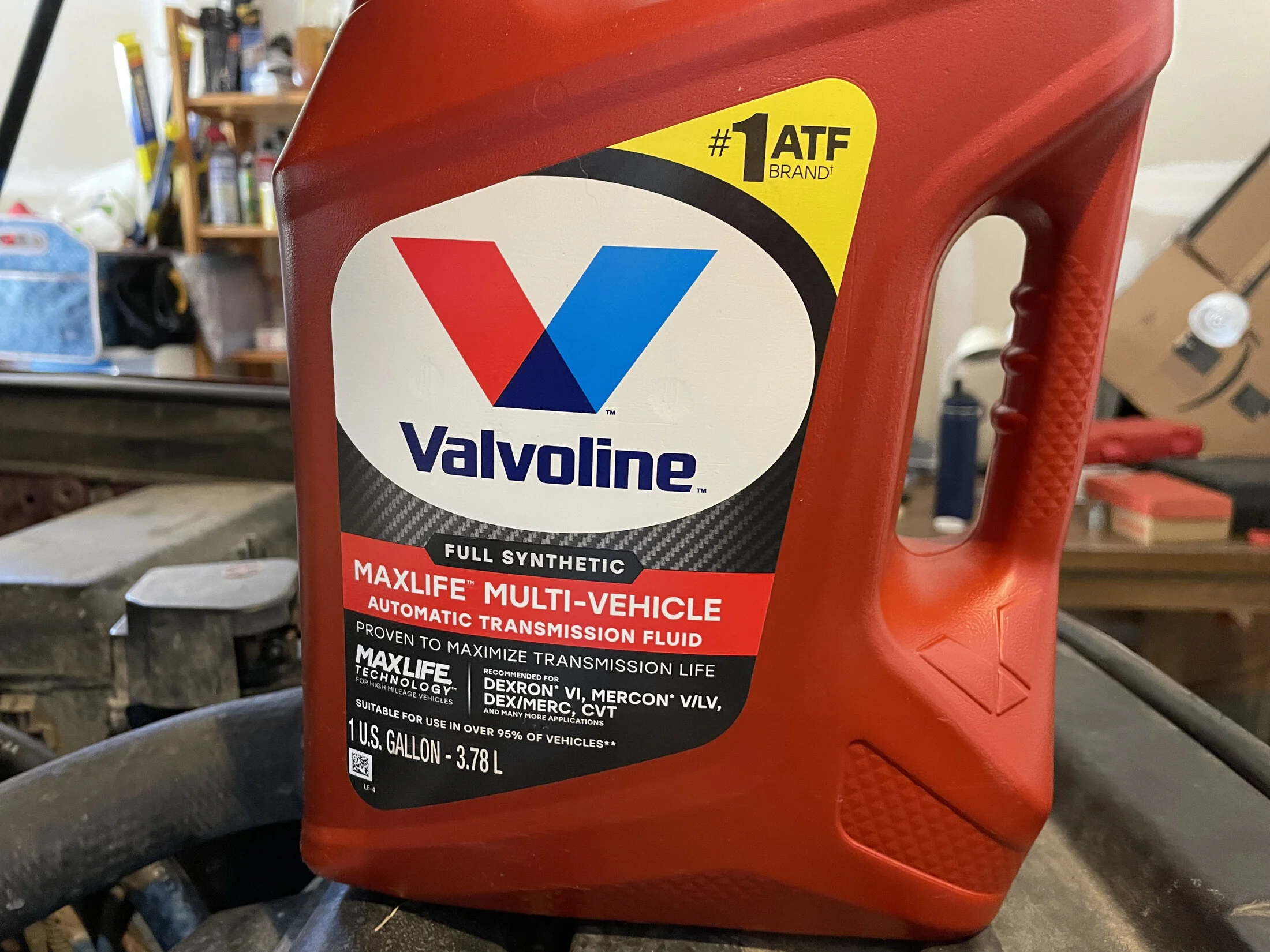

  • Steering fluid that is applicable to your year. I have a 2008 and use Valvoline Max Life Synthetic ATF (red bottle). It’s the same fluid I use for my transmission case. I've been using this as the steering and transmission fluid for the past 70k miles/5 yrs with no issues. Sometimes Amazon has this cheaper than anywhere else. I cannot remember how much fluid I used, but somewhere between 2-3 quarts. You are advised to get fluid that meets/exceeds the specs for your Cruiser.

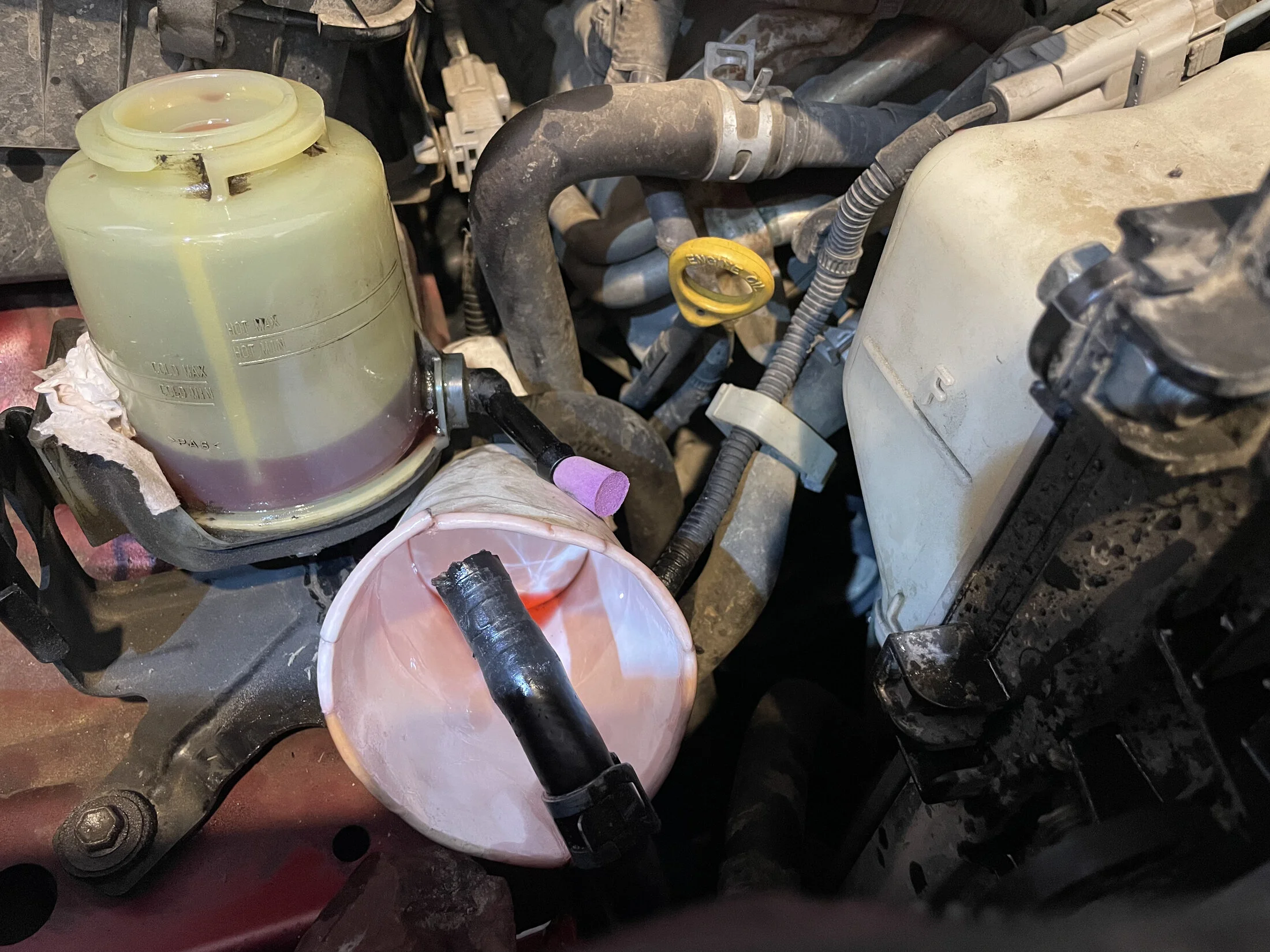

  4. Place the drip pan under the area where the fluid reservoir is located, near the coolant reservoir.
  5. Use the suction device to remove the reservoir fluid. Removing the reservoir fluid now is helpful, but not necessary. You can proceed either way.
  6. The top reservoir line is the return line. Yes, you guessed it and get a point. This is where the fluid returns to the reservoir. Place the disposable cup and rags under the top reservoir line so it can catch the fluid that is about to come out. Place the ear plugs nearby.
  7. Remove the clamp from the return line.
  8. This is where it can become messy... the plan is to pull off the return line while minimizing the mess from both the line and the reservoir connector pipe. Here is what I do and I'm sure this would pass scrutiny by any ASE certified mechanic: I place the small disposable cup snug below the lines with rags/tissues under and around it. I have rags/tissues by the reservoir to use as needed. I pull the reservoir off its metal holder. I pull off the return line from the pipe and hold the pipe upward with my right hand, while using my left hand to lift the reservoir such that the pipe will drain into the cup. If you can suction the reservoir fluid out before this, then there will be less mess.
  9. Prop the return line upward with something so it does not move, to keep fluid in the line like a block of wood or a circle of string that connects to the coolant reservoir.
  10. Take one ear plug. Roll the small end into a cone, then stick it into the housing pipe. Feel free to add your Willie Nelson and Snoop Dog jokes below. Have a 2nd plug ready in case you drop the first one.
  11. Fill the reservoir up at least to the hot fill line with new fluid. For me, I use a small clean glass bottle to make it easier to pour the fluid directly into the reservoir… not that I would ever pour outside the top fill hole and have to reclean the outside of the reservoir and under it… just a thought.
  12. Empty the used fluid in the cup and unprop the return line. Use your Jedi mechanical powers to place the line downward into the cup. Be sure the cup and line will not move. If the return line is not pointed downwards, fluid will be carried by the exterior of the line down to a hidden area where the Toyota engineers have no clue where it is.

  16. With your other hand, empty the cup. Note how much is in it AND the color of the fluid. Place the cup back under the return line with the line pointed downward.
  17. With your sock hand, turn the steering all the way in the other direction. If you are into sailing, then yell, "Hard to port!"
  18. Empty the cup. Place it back under the return line. Refill the reservoir with new fluid.
  19. Repeat 15 – 18 several times. When you see new fluid coming out of the return line, you know the end is near like when Mahomes starts nailing 1st downs in the 4th qtr. When you see new fluid showing up in the cup, don't refill past the COLD line.

  22. Set the cup aside while keeping the return line propped up. In a fast motion, pull the ear plug while you quickly attach the return line back to the pipe. Fasten the clamp.
