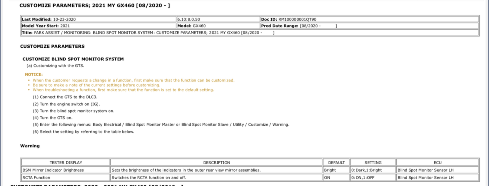

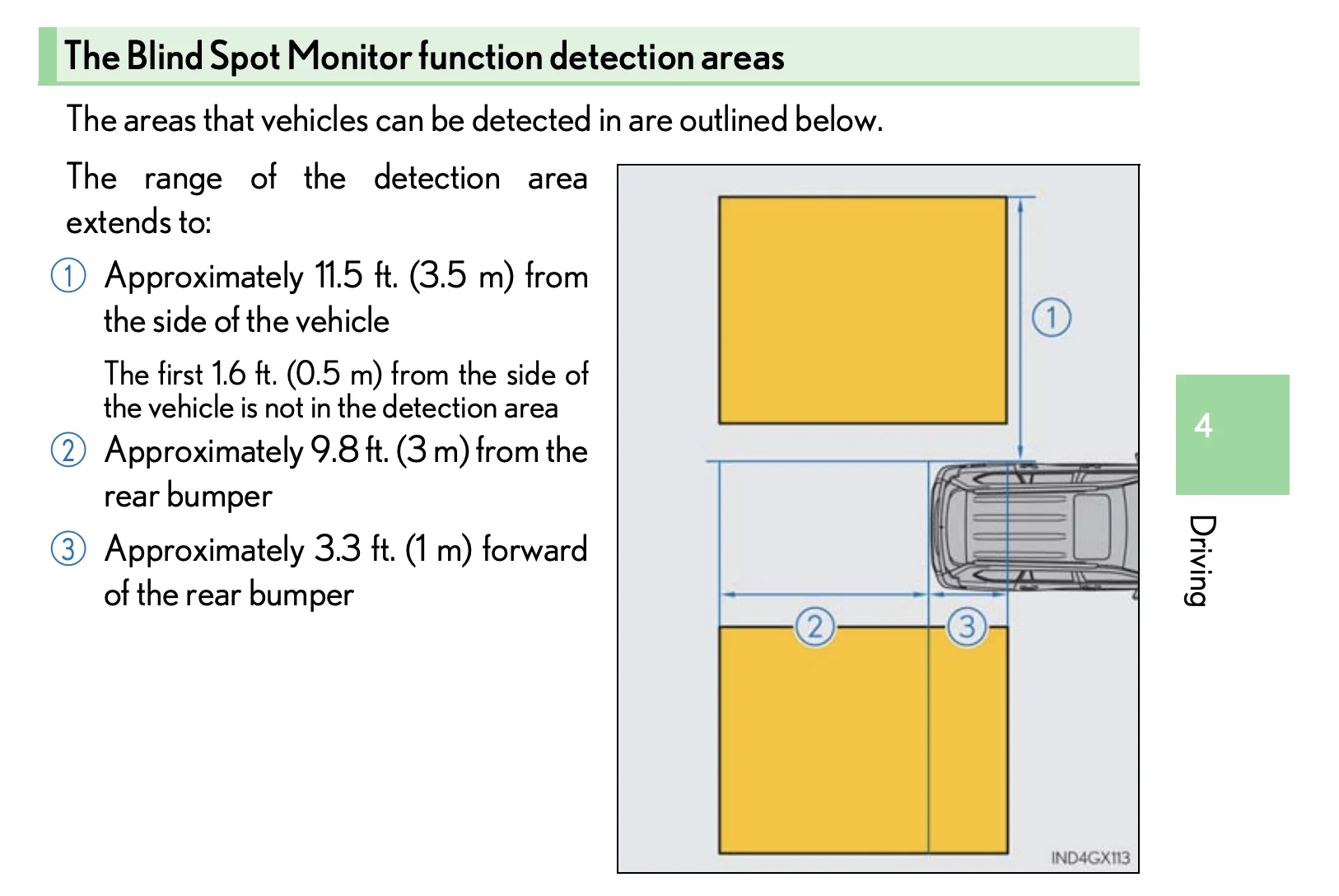

Are you finding it has to be closer than what owner's manual says? The only TS options I see are listed below
I’d like the range to extend a bit further, meaning i want it to be a tad more sensitive so the BSM can detect cars further away. Thanks
Since nothing OEM tweaking-wise can do this on 460.... you might have to look at general tweaking to extend sensitivity for any BSM equipped automobile far and wide on other Google hits and forums.. I do have another vehicle/another brand with BSM... but can't think of a way offhand I would extend sensitivity other than getting into the fenders and re-pointing the sensors.
Oh , i thought maybe it could be somewhere in Settings. Appreciate ya.
I know for sure on the IS you can change bsm sensitivity. For some reason i didnt see that in the gx Settings
