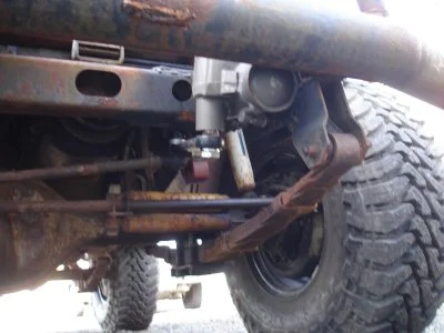

just curious if you have a guess as to how much lift i have on this rig from the PO's set up?
im planning on going to a OME 2.5" lift in the future at some point.. just curious how it will compare to what im currently running.
note: truck is sitting on 33x12.5R16 BFG AT's
Thanks
looks like 6 inches

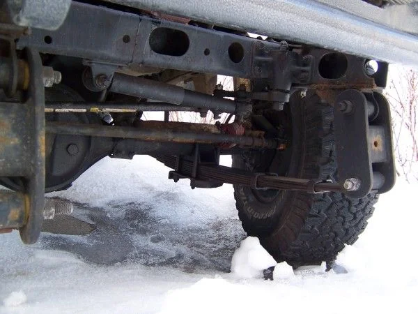

my lift is 6 inches, and here is a pic to compare. i do not believe that the tire size will help you determine the lift amount.

The leaf springs look to be fairly flat - I'd guess they are stock, so all the lift is from those over-length shackles.
What is the length, from shackle pin to shackle pin?

your right the springs are virtually flat.... measurement from pin to pin on the shackle is a hair over 6"
but how much lift over stock am i getting from these shackles?
Stock shackles are ~2.75 - 3" eye to eye. Yours look to be about 5". That means you are getting about 1" worth of lift (1/2 the height of the extended shackle) from your shackles. You could always measure them to be sure.
:cheers:
1/2" to an 1". not enough to keep your tires out of the fenders, unless they've been cut.
so planning to go to a 2.5" OME Dakar lift would be a super nice fit...
yes, would be a great fit. in hard flex, you may still get into the fender a little bit with that wide of a tire, but you'd have to flex it pretty good to do so.
