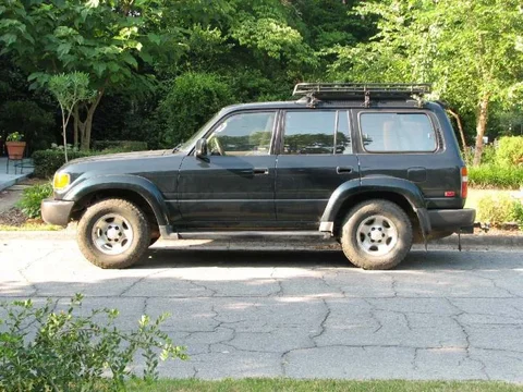

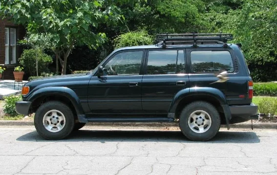

I just installed mine, it was about 1.5" at both fenders - probably depends how bad you are sagging
before
and after

Looks good! That first photo looks almost exactly the same height as mine (subjectively)... Did you measure yours before/after? Either way, do you have a center of hub to fender flare measurement as it is right now? That will give me a good idea of where it will end up.
I want a LITTLE bit of lift, but want to avoid going with a full 2.5" OME lift and messing with caster correction and all that. Two reasons are 1) only have 265's on it and it would look goofy with those tires and a 2.5" lift, and 2) MOST importantly, the spousal unit will probably bitch about a 1-1.5" lift.
Just measured it at 21 1/4 in the front and 20 3/4 in the back - I think the roof rack is weighing the back down a little, and I do have some boxes in the back also. I lost the before measurements, so I can't tell you exactly, it was about 1.5 inches overall though.

Nice inflight action shot with the dove.......:D
