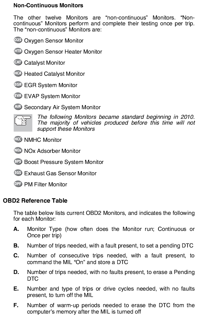

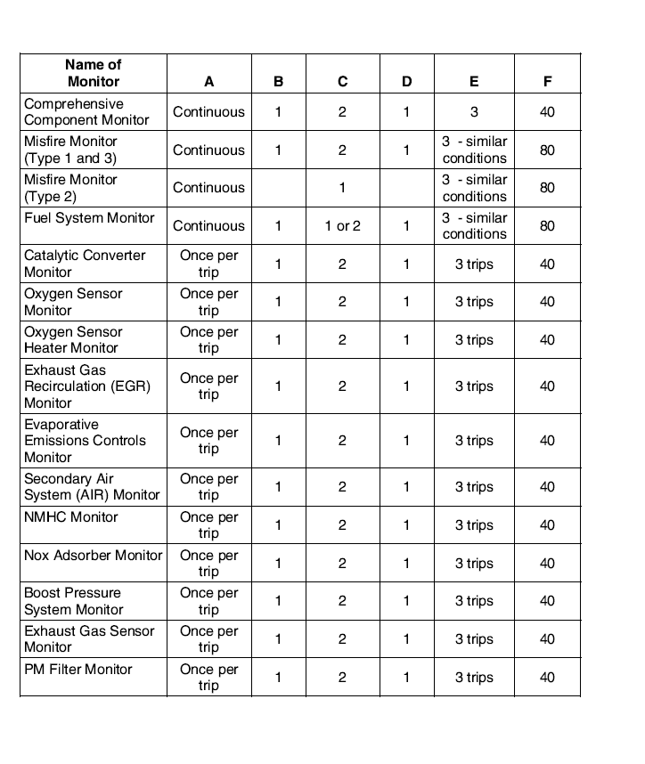

Here is some more general info that might give you an idea. I don't have access to anything Toyota specific at the moment. When I was dealing with an EVAP/SAS issue last year, I remember the EVAP requiring more than a few trips to clear. My scan tool listed out the criteria required to complete the full monitor test cycle but I didn't print it out/save for future reference.
Thanks !!
Looks like based on that table at least 3 trips.
