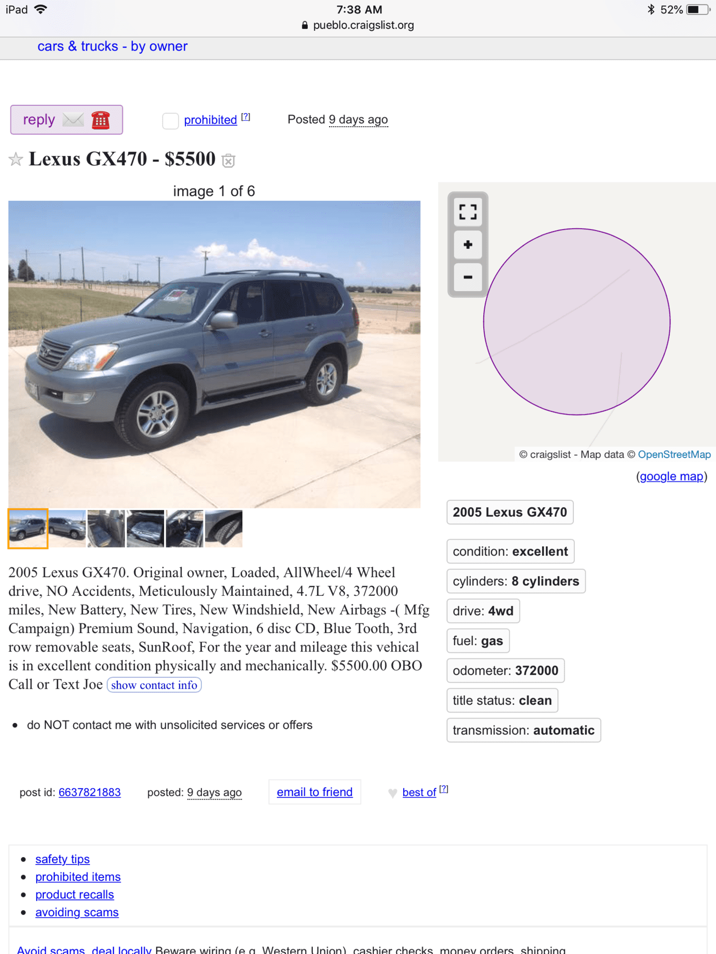

Ran across this on Craigslist recently. If the price is right could it be worthwhile or is everything one shake from breaking at this point?
Lexus GX470
2005 with 372k miles

Went to the ad, those look like snow tires on it so factor in the cost of tires too, the seat looks really good meaning it has been replaced or the location would suggest a lot of highway driving. They are in the middle of no where, no dealer would take that car as a trade in unless there was some gimmicky promotion, That car is near maximum low value best case it has another 300k left realistically only another 130k and it is going to be eating parts (assuming they havent all been replaced recently). If i were you and you wanted a project toy Maximum lowball $3720 thats a penny for every mile its been driven. If they tell you to go away then take their advice.
