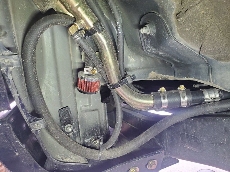

I'd say not too important. I broke mine in the same location when installing the loop line as well. I have about 2-3k mi over 2 months without and have had zero issues with codes or filling up either tank. I cut it apart and it looks like there is some activated charcoal media in it so I'm guessing it is to help with fuel vapor smell only. Otherwise, it does nothing to limit airflow in any direction. If any, it may help as a "catch" for moisture, but with the high loop on the aftermarket breather, that should minimize moisture intrusion.
How mine looks without it. The part is about $70 from Toyota so if I get any codes this summer I'll swap a new one back in.
Thank you. That looks pretty much like mine now. I looped up over the top of the filler but otherwise the same. Nice to hear that it isn't throwing codes. We went for a long drive this afternoon and so far, so good!
