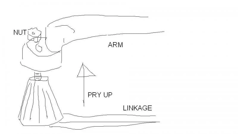

How's this for a crappy visual :lol:
The bottom part of visually stunning visual is the "hard" metal. The arm where it sits on is soft metal. The nut pushes the arm onto the hard metal creating receiving grooves. So could be pretty snug.

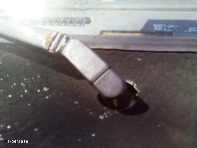

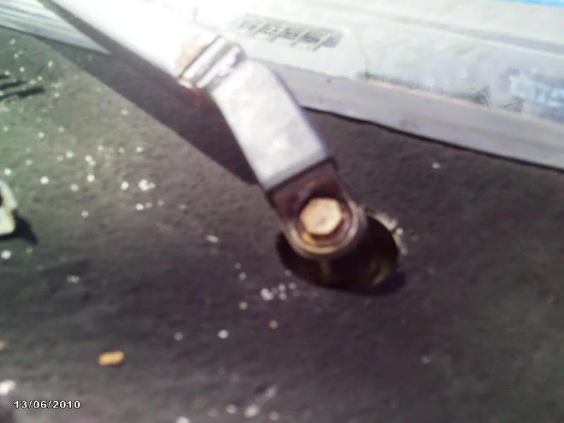

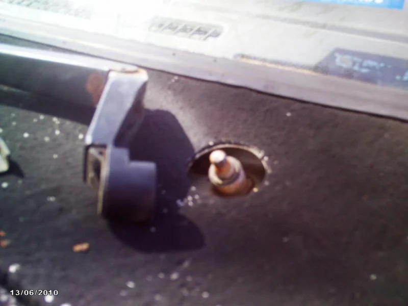

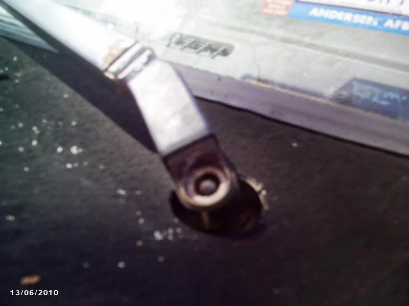

Its pretty simple. Take the plastic cover off exposing 12mm bolt. Remove bolt, then remove wiper. Here's the pics:
Last one:
