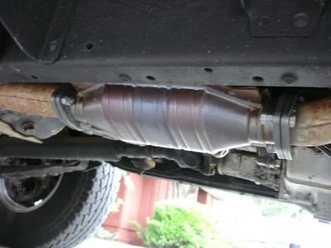

Well I thought I'd post this for the benefit of anyone having similar issues with the CA ( or other states for that matter) Smog Nazis. My original CA 78 FJ40 has always struggled to pass CA tests and I live in a county that requires the biennial 'test-only' check.
Every two years I have had to deal with the various smog check stations with techs that are younger than my truck and have to be shown how to open the hood. To make the story short I
went out and had a test done and my 40 failed one of the tests for CO. I had the carb rebuilt for the last check two years ago, and it just barely passed then, so since the truck runs just great as is and everything is to spec, I decided to have a catalytic
converter put on it, rather than to deal with unnecessary diagnostics and repairs by folks that have no familiarity with the vehicle. For about $200.00 and some change I put a cat on, and did so with flanged mounting, so that if necessary, it can be removed and replaced with a straigt pipe, should heat or performance be a problem. Thus far, it seems to have made no change to performance and heat does not seem to be a problem, but I'll have to wait until we have some 100+ days to make that call. Here's my numbers before and after the cat. The numbers with the cat compare with my late model vehicles and the cat should solve the problem for many years to come!

Another side benefit is that it runs a bit quieter, but still sounds good. I have a set of Downey headers, 2.5" pipe, and a Flowmaster muffler on the truck. Some pics of the new cat
below... :cheers: DSC01157.webp

You may want to remove the cat fairly soon. The extra CO just means you're running rich and without a feedback system to switch between lean and rich, the cat will likely deteriorate/die before the next smog check.
The problem you're seeing is probably not the carburator and is more likely due to another issue such as a poor/non-performing air injection system. If you look at your numbers you may see little or no oxygen, fairly low HC, fairly low CO2 and very low NOX.
Over the next couple years it may be worth walking through the air injection and other systems/controls to make sure they are doing what they are supposed to...then you won't need the cat. But hey, that's just the perspective a licensed smog nazi. : )
