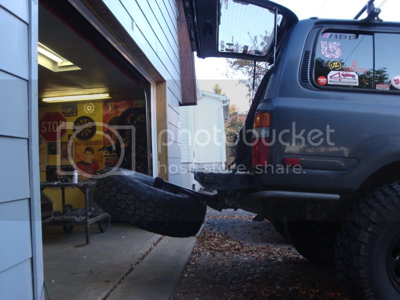

how does it latch in the UP position? i am half starting to build my own swing down, but an still trying to figure out the best way to lock it up, thanks :)
^^ If you look at the first picture of the 37 on the 80 you can see the red handled pin that holds the swing down in the up position. We made up a latch system with a bunch of 1/4" tabs and hitch pins. Works really good for what it is.
Both carrier builds are "documented" lol in my build threads, "93 80 Beater" for the 80 and "New addition 85 FJ60" for the 60 carrier.
One thing I like about yours and the one gnob made were when you swing it down you can easily toss the tire on, boltup and then swing back up.
Yeah, that was cool but I had to sacrifice that feature when I redid it for the 37. Now I have to lift the tire onto the carrier when its up which is a pain since the 37 and the steel rim weigh roughly 5000lb.
Just as a side note, the 80 carrier is solid but the 60 swing down with the latch pin offset from the pivot is bomb proof. Ive pinged it off at least one tree, backed it into a creek bank several times in a row, and like a retard tried to drive the 60 into the garage with the swing down in the up position (the tire is about 3" above the roof of the 60 and the 60 only has about an 1" of clearance in the garage w the 40's on it). The thing hasnt moved, when I drove it into the garage header the whole rear end of the van squatted down but the carrier stayed put.
