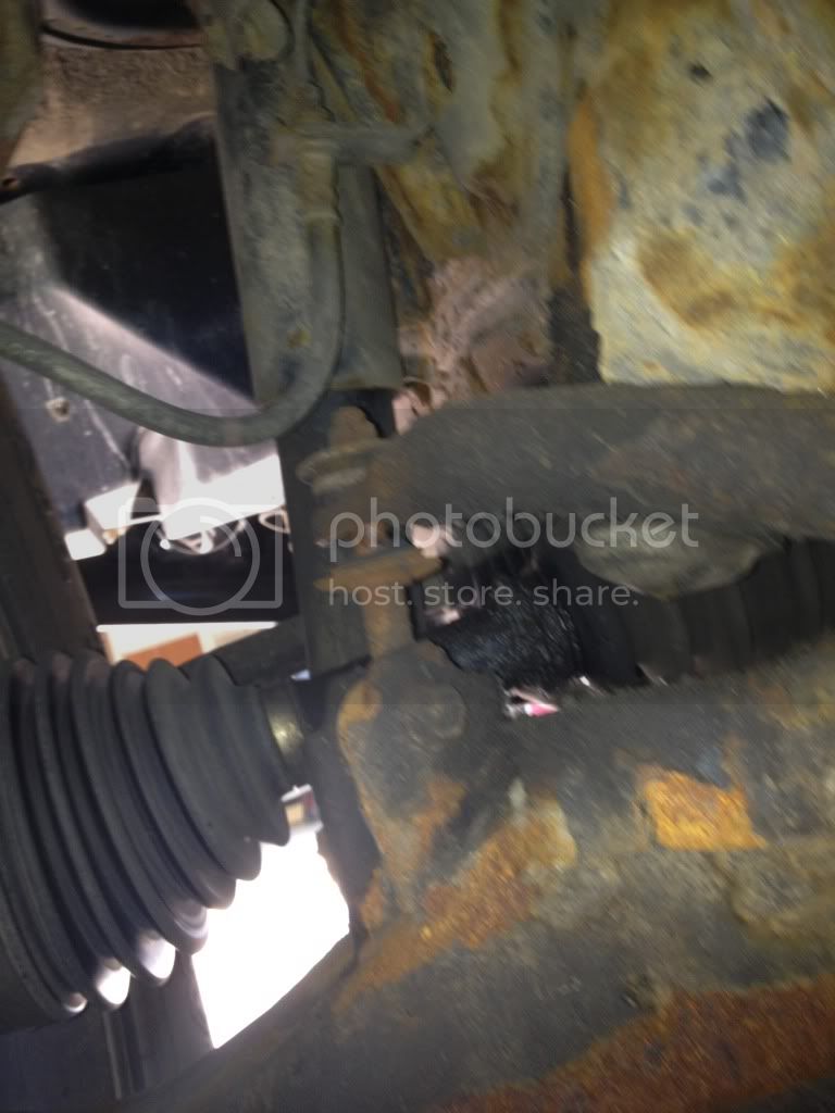

How do I replace this bushing

Can I or do I have to replace the entire arm?
Yeah, I know about that leaking CV.
And I definitely know about the rust!

You can get the two individual bushings that sandwich the sway bar from Toyota...super cheap. You can also get the link with a new bushing in it from Toyota, like $14 each.
You will still need those little ones. Mine were sold separately, called cushions.
