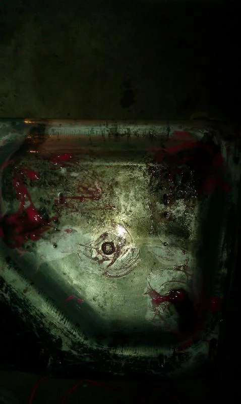

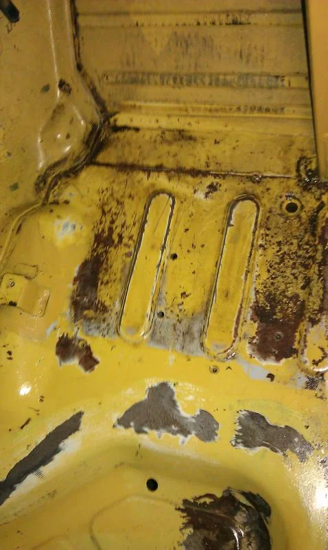

Hi everyone, I am using Naval Gelly to remove the rust from my floor pan and gas tank. how do i know when it is ready to apply the primer? is it when it turns black? or is it suppose to look shinny and no rust at all? I left it over night and washed with tsp but i still see the rust I applied another coat of the gelly.
